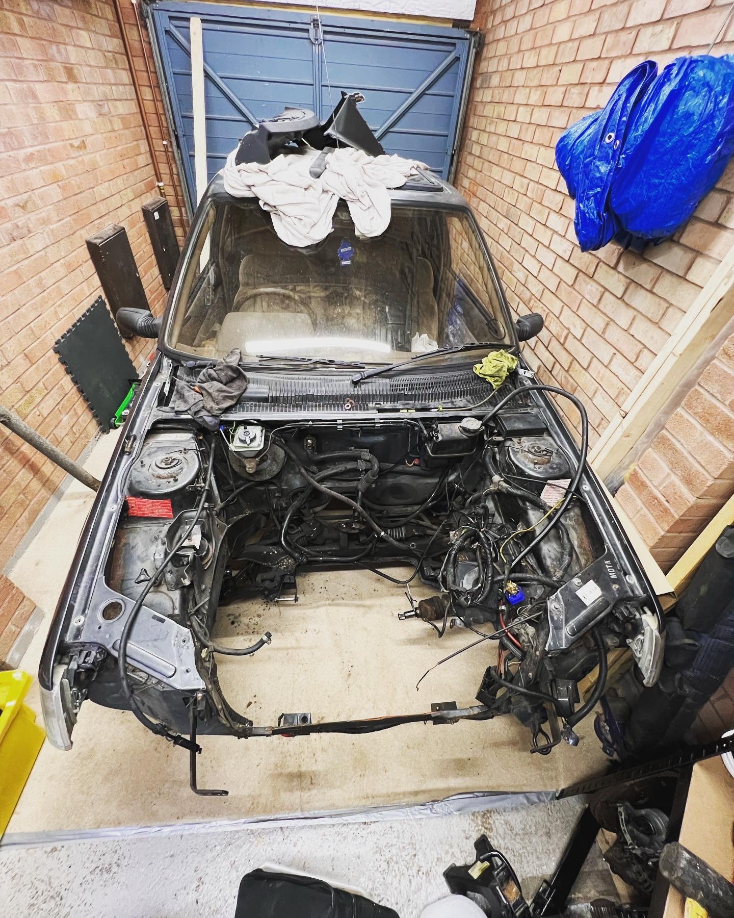

Billy Hawkins 0 Posted June 13, 2022 (edited) Hi guys, i have got an STDT which i plan to put a GTI-6 engine in. Can i use the standard dash loom for the GTI clocks or would i need a GTI loom also? It’s only mainly for the oil temp and pressure gauges. She’s needs some loving on front end minor innerwing rot. Thanks. Edited June 13, 2022 by Billy Hawkins Upload picture. Share this post Link to post Share on other sites
Richie-Van-GTi 81 2 Cars Posted June 14, 2022 Loom should work but the tachometer will be wrong. 1 Share this post Link to post Share on other sites
Billy Hawkins 0 Posted June 16, 2022 Even with the GTI clocks? Share this post Link to post Share on other sites
Gohn 73 Posted June 17, 2022 the STDT and GTi binnacle is the same but don't know what the GTi6 needs to get a tacho reading going the other way, from Si (which is petrol and has same loom as GTi) to Turbo Diesel, there were a few obsolete plugs on the petrol loom not req'd for diesel converting your way the loom might be a few sensors short ? Share this post Link to post Share on other sites
Billy Hawkins 0 Posted June 18, 2022 Thanks for the reply. From what i can tell it’s only the oil temp and pressure gauges on the GTi clocks. Could hardwire them in. Share this post Link to post Share on other sites
