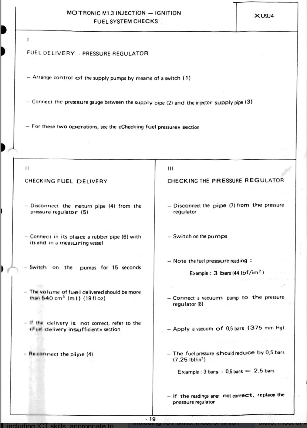

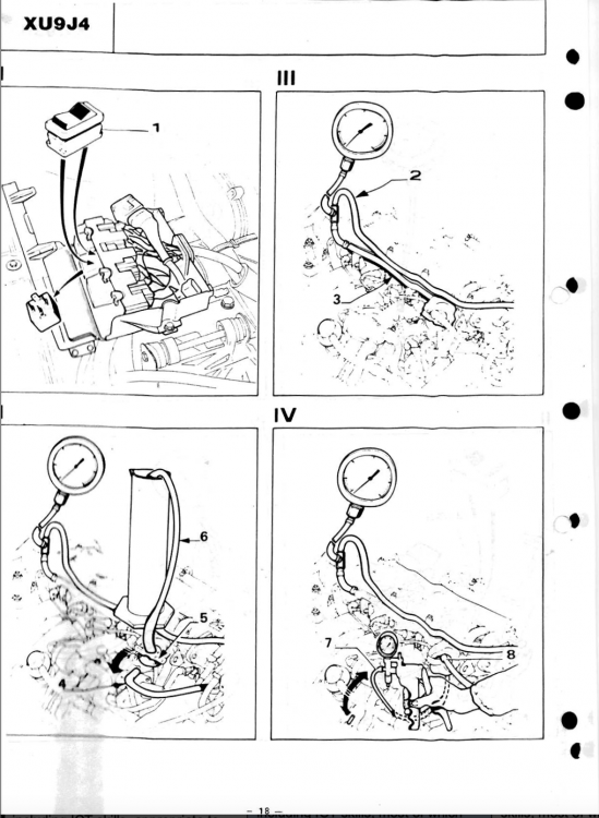

I finally got round to measuring the fuel pressure after getting hold of a gauge. After some fun and games trying to get various adaptors onto the hoses and squirting fuel everywhere, I managed to get a reading that varies between 35-40 PSI (2.4 - 2.7 bar) depending on whether its idling or the throttle is being blipped. Does this sound like sensible values?
Sounds ok. The fuel pressure is vac referenced. Better way is to check with fuel pump running, engine off. You should see circa 3 bar.
Pressure is just one check. You also need to check flow. ie it should be approx. 2L/min, as illustrated. I'm still tipping dirty injectors however.
