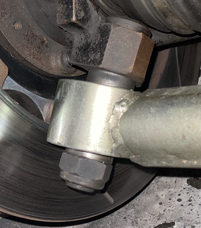

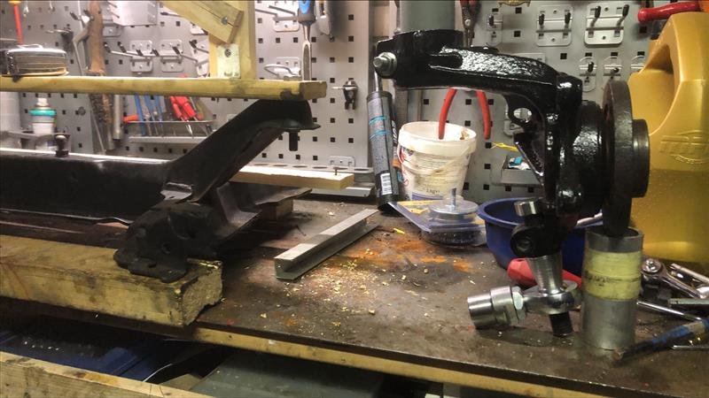

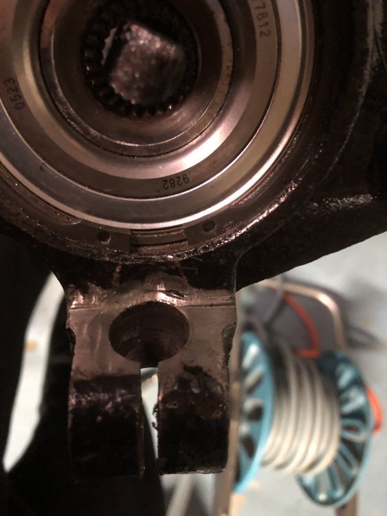

An update after some time:
With all your help and advise taken I decided to go for M18 10.9 bolt with a D-head and 30mm cone. I have build a wooden "car" jig and used pipes for struts at the current length of my struts base loaded. This confirms for 98% that my arms will be about 20mm/25mm longer than standard GTI ones at (my) minimum camber of about 0.5 negative.
Calculation / guesstimates: / facts.
M18 10,9 hex bolt with 1/3 of the head machined off
Cone made from Crmo steel. About 30 x 30 if it was a square. Smallest diameter at the ball 22 x 18. (125 mm2) (~5000kg @modest 400 yield)
95 kN (static) load ball from motorsport company. (even if dynamic was only 10% of static, should be fine)
Tubular wishbones made from 35 x 2.5 25CRMO4 pipe, welded with crmo tig rods (700 Nm/mm2)
Nut I plan to torque at 300Nm, so about 50% of the pin/bolt is used for pre tension (600kg-ish)
No bump steer correction (yet), 206 steering rods on the shelf should 205 be too short
I'm pretty confident this is more then strong enough and the pre tension will never be overcome. I think I would destroy a rim far before this setup breaks. I will clean up the face of the pin even more than underneath picture.
