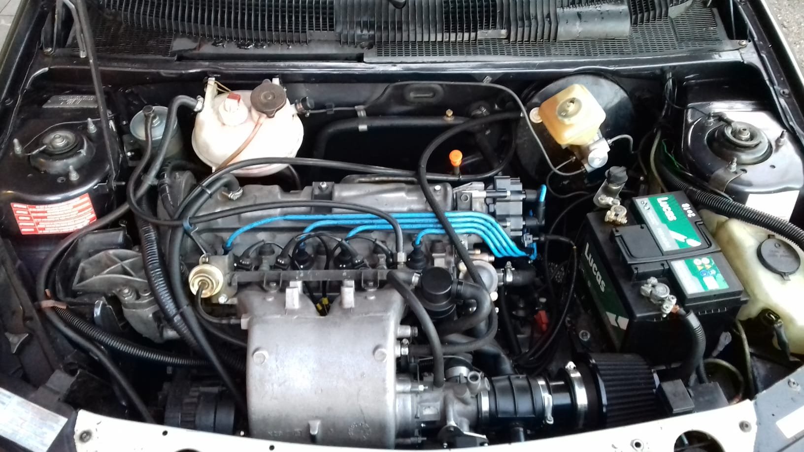

Hi folks! So , i just fitted this brand new Wallbro 255 Fuel pump on my 1.6 GTI and it just died on me yesterday , it was ok for about 2 weeks but yesterday it just stopped working, eletric current makes it to the pump but the pump only does a bit of a click but wont pump fuel at all, i took it out of the tank and gave it a test and seems to be somehow clogged and does not pump at all.
I have read in another places that this pump can sometimes be a little problematic. Does anyone had any problems with those pumps?

Well , my engine its just a regular 1.6 , but with a omex 600 fitted on it! I think a OEM Bosch should do the trick , no more Wallbros... Thank you again for the info and for the google search , sure got me a better notion of what to use!
