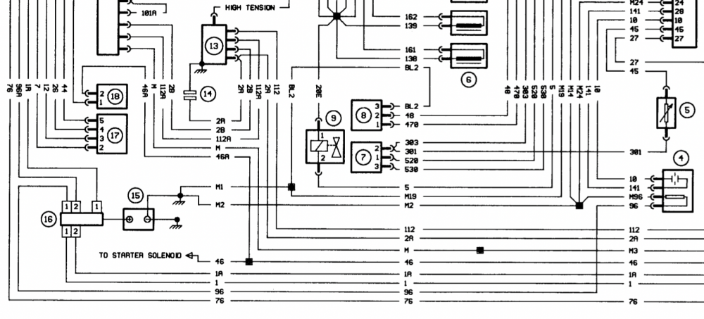

It would appear that +12V for the lambda sensor (4) on wire #96, comes from the distribution block near the battery & PAS oil tank. I've never personally traced it, so can't vouch for the accuracy of Mr Haynes. It doesn't make a lot of sense as it would be permanently live.
Edited by petert
This Mi16 M1.3 diagram appears to have a separate  relay for the Lambda supply.

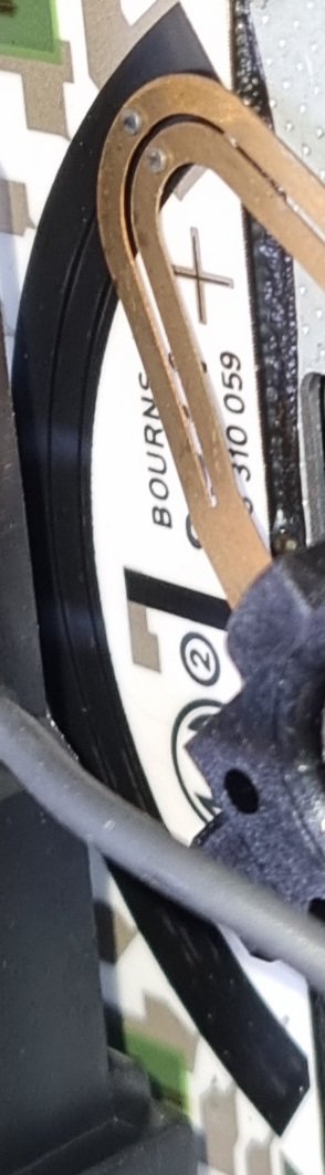

Opened up the AFM to see if the track is worn as it is listed as a cause for jerky behaviour.
How would the experts qualfy the state of the track from the picture? Is it a suspect?
Thijs_Rallye
Hard to tell on that picture. It seems like there is some wear around where the cable runs in the picture. I've seen worse but this picture may be misleading. Best way to check these is measuring the signal with a scope whilst manipulating the flap angle, the signal should be fairly smooth.
