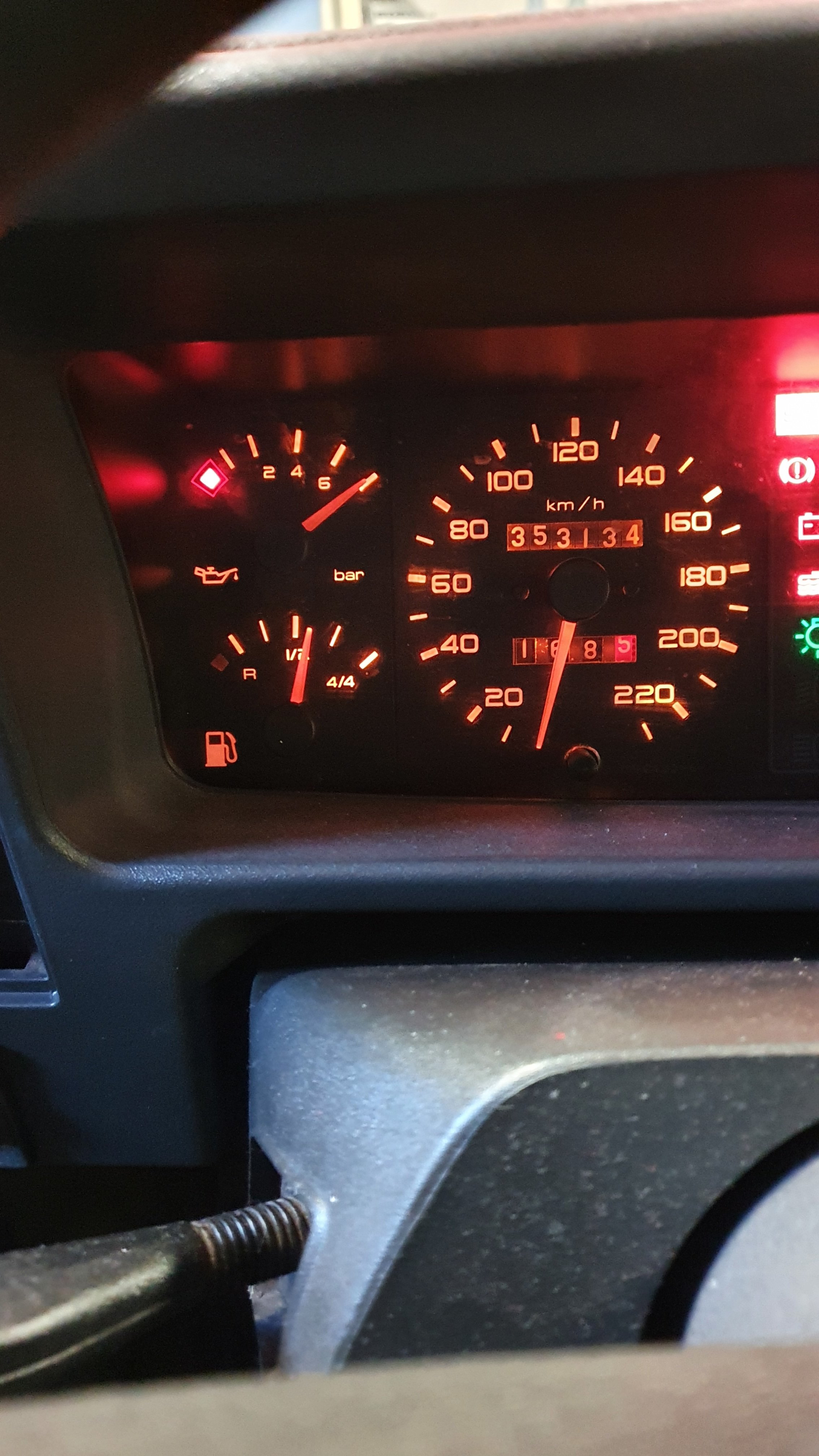

Hello all!
Mine 309 gti ´87 has problem, when i turn ignition power on, oil pressure goes to end. I also tried to
switch wires 30 and 30B  at  probes, but it was same issue again.
What may be the problem?

Yes it looks like that.
Oil pressure was full when ignition power on, but when engine is running, gauge goes to zero. But red light is not on.  It functions like vice versa.

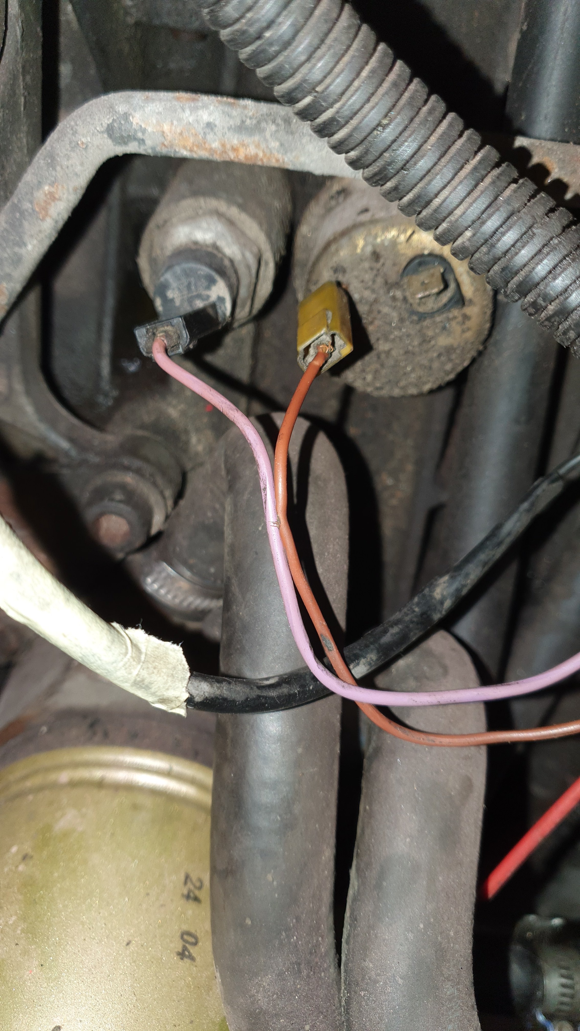

If I remember right
The sensor on the left is the low oil pressure switch (for the warning light)
The sensor on the right is the oil pressure sensor ( for the oil gauge)
Edited by PhilNW
With a multimeter , test the brown wire for short to ground (twist/wiggle the wiring loom a bit as you do the testing) ... in fact , test both of them .
Both of those wires go directly from the instrument cluster to the sensors/senders , only mid way trough engine bay they should be on a connector/multiplug which is known to cause all kinds of problems from broken wire insulation , broken wire copper strands , badly oxidized connections and oxidized/blackened/rotten wire copper strands deep down under the insulation etc. .
Best to chop off OE multiplugs and join the wires together with some modern sealed connector blocks or directly by soldering and heat shrink tubing one by one  .
Also , try to swap places of the two wires on the sensors/senders , and see what happens . But my main assumption is , short to ground somewhere from the instrument cluster to the wire ends .

I¨ve tried swap those also, but no change on function.
This featutre has been on this car so long I have owned it, but now there is a chance to fix it. (because of winter and snow there is plenty of time...)
Earlier owner told me that they had put wires wrongly while engine restoration, but that seems not to be true anymore...
Yes , wire orientation on the sensors/senders seems fine based on the wire numbers . But , you never know , especially as you say if someone's been there before rewiring the loom .
Anyhow , should be easy to sort out ... need multimeter and wiring diagram and some patience .

Not the voltage test - need to perform continuity test .
Sensors/senders are 1pin type , thus with the ignition switched ON live +12V goes trough the wire and earth is trough the sensor/sender itself .
Switch mulitimeter on continuity/buzzer (speaker) , then put one probe on the wire terminal end and poke engine or chassis earth with another probe = if there's continuity or buzzer/speaker starts beeping you've found the problem ... ie. active short to ground but not trough the sensor/sender but somewhere in the loom touching engine/chassis earth or cross connection chuffed insulation 12V wires with an earth wire .

Sumu
resistance between wire 30 and ground is about 57ohms. Same with 30B and ground, looks like exaxtly same resistance.
Resistance between wires 30 and 30B is changing all the time. Not exact reading possible. When measured, value increases from 1 ohm.

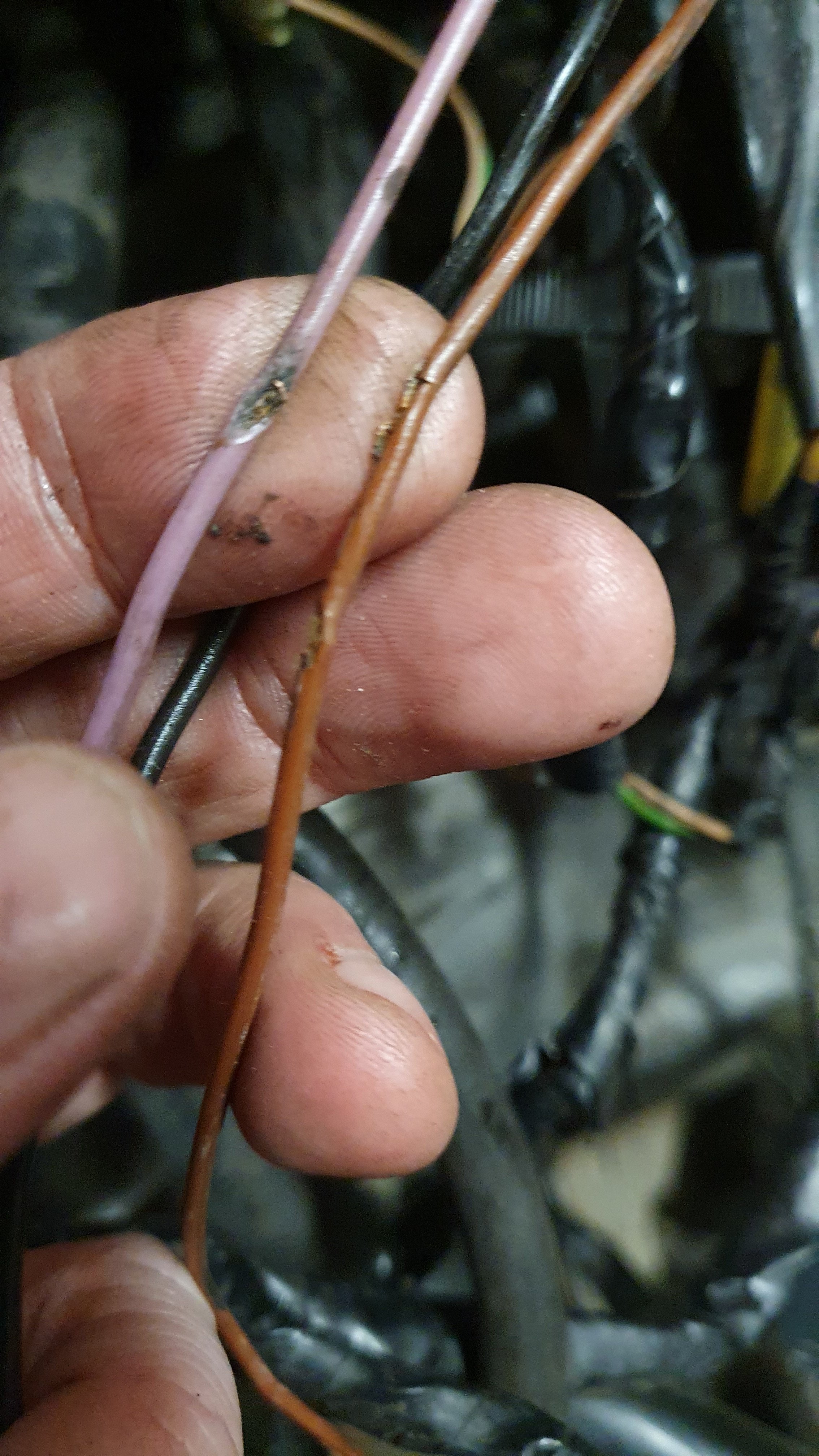

Sumu
Removed tape from wires. There was damage and contact between. Now works fine20220119_192539.thumb.jpg.63bfe091130ec4c7bcafbbcd16eaa995.jpg
