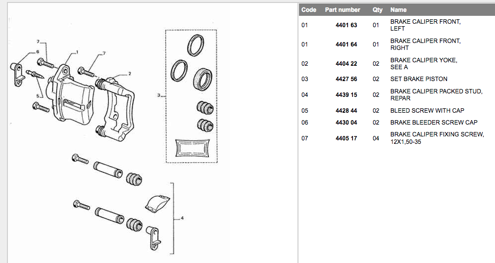

Gohn 62 Posted November 16, 2021 also, on another set of brakes which are bendix.. the part numbered 3 called the STOP PLATE looks a little bit torqued they aren't twisted badly, just not straight as when I put the brakes together what do they do ? should I replace them or is a little bit of bending normal during operation ? Share this post Link to post Share on other sites
welshpug 1,622 Posted November 16, 2021 they stop the pads falling out.. you can get a kit of new ones and springs and clips. Share this post Link to post Share on other sites
pug_ham 240 3 Cars Posted November 16, 2021 28 minutes ago, welshpug said: they stop the pads falling out.. you can get a kit of new ones and springs and clips. That's item #2 not #3 which Andy asked about. I don't know the exact purpose of the stop plate, they twist as you torque the caliper mounting bolts up. You need different bolts to use the Girling calipers and they don't have the stop plates but I've hammered them flat again & reused them before on bendix calipers. g Share this post Link to post Share on other sites
welshpug 1,622 Posted November 16, 2021 oh that bit, not sure but technically will fail an mot without it Share this post Link to post Share on other sites
Gohn 62 Posted November 16, 2021 ok, its thru MOT/roadworthy a while back so no worries there 54 minutes ago, pug_ham said: I've hammered them flat again & reused them if they twist any worse I'll do that cheers Share this post Link to post Share on other sites
Tom Fenton 1,525 Posted November 16, 2021 Stop plate is to stop the bolts working loose. If its not there the bolt is bearing on the slider tube which is free to turn and won't resist the bolt head turning against it. With the stop plate there the bolt head is trying to turn but the stop plate resists this hence helps to stop the bolts working loose. Not needed on the Girling caliper as the bolt head is trying to twist on the caliper lugs which won't move. 1 Share this post Link to post Share on other sites
