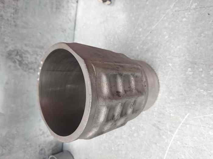

Peugeot machined the original J4 liners like the other ones, probably to save on tooling costs. It's on the outside that they got creative:

The ones currently in the engine look like that with the ribbing, so are probably original XU9J4 ones. However, the ones that were in the engine before (when it was running fine) don't have the ribbing, so maybe originate from an 8v engine? I've had both engines for such a long time I struggle to remember what their history is now.
