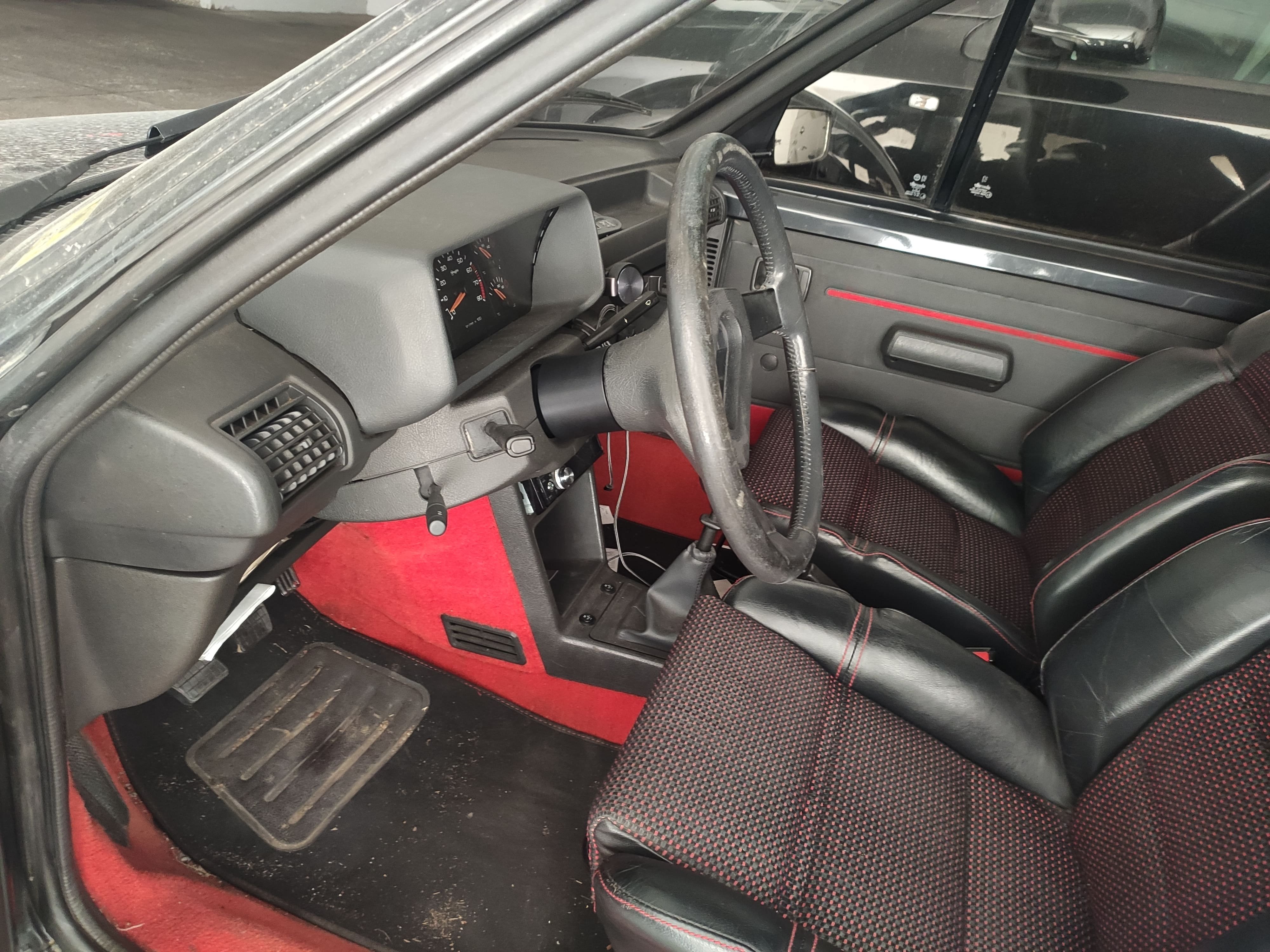

This is the result with my test wheel:

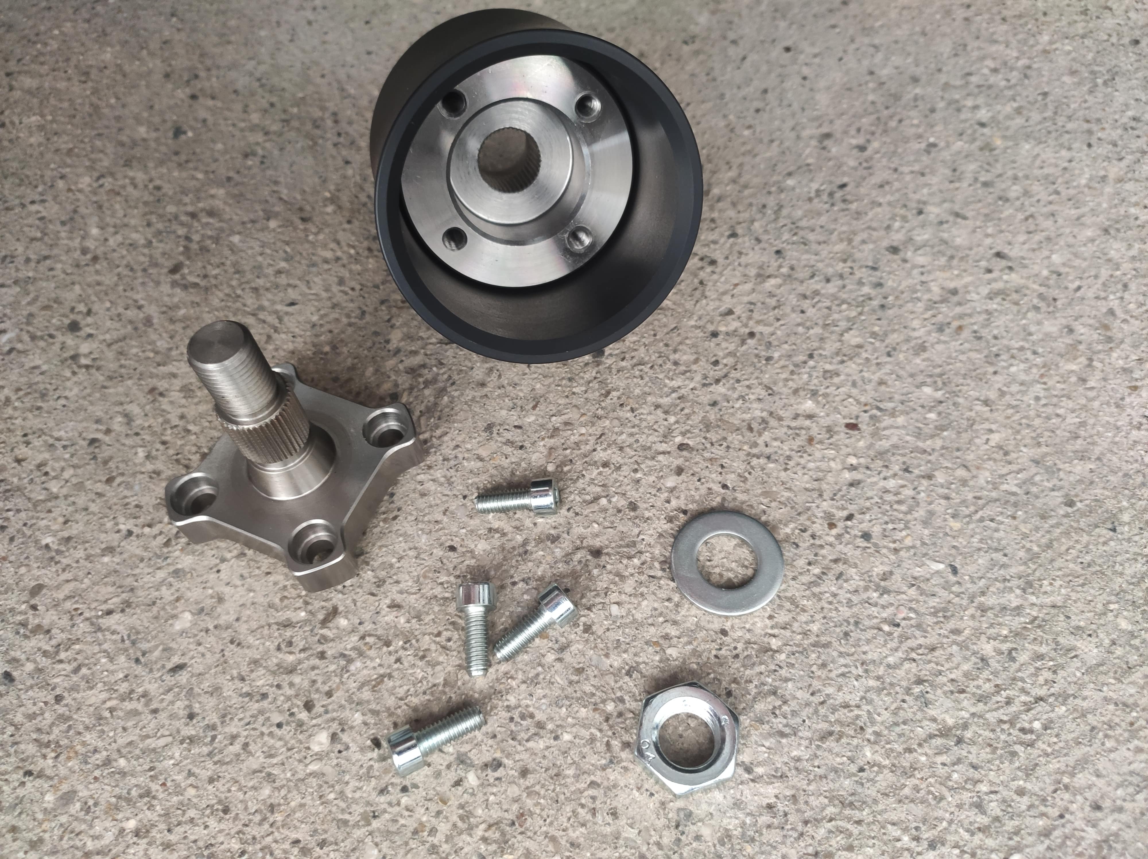

So I received these parts from the company:

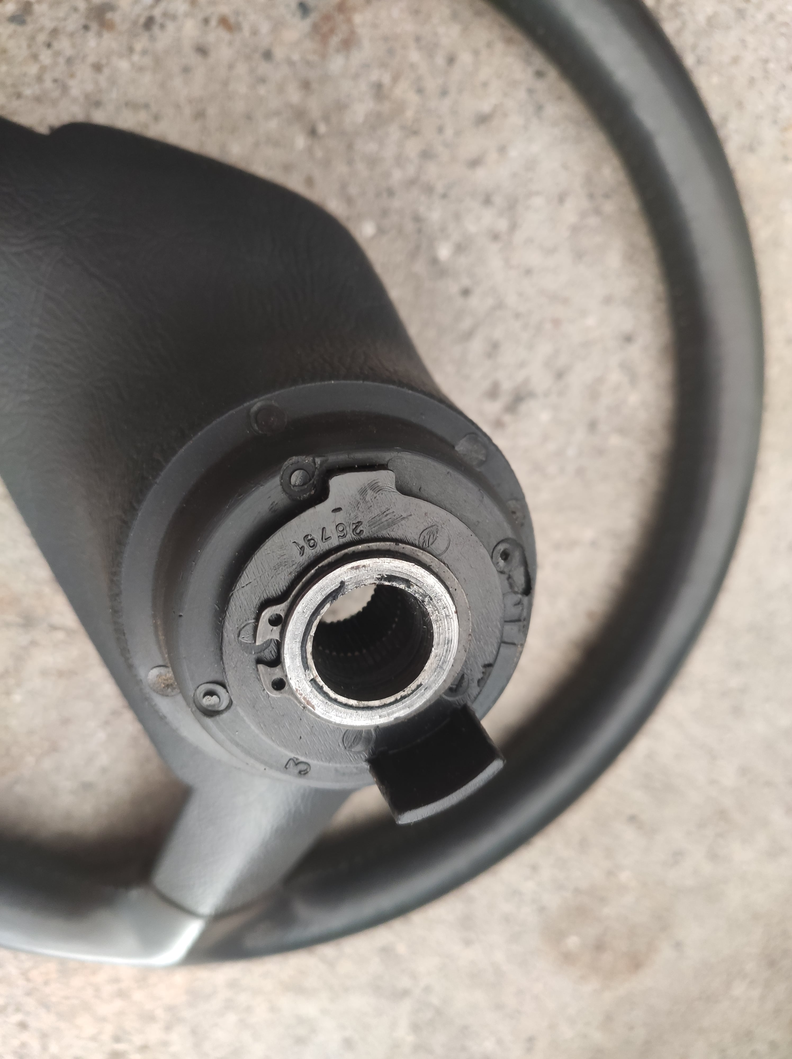

You have to remove the ring with the lip for the blinkers from the original steering wheel and mount it on the spacer.
From this: IMG-20220702-191542-min.jpg

It comes prepared for the parts from the original wheel.
You then mount the spacer with the original (21) nut from the steering wheel.
And mount the parts from the spacer:
After which you can mount the steering wheel as normal.
Once the wheel has been mounted the stalks for the lights and wipers are a bit far away, but it's still manageble. IMG-20220702-193830-min.jpg

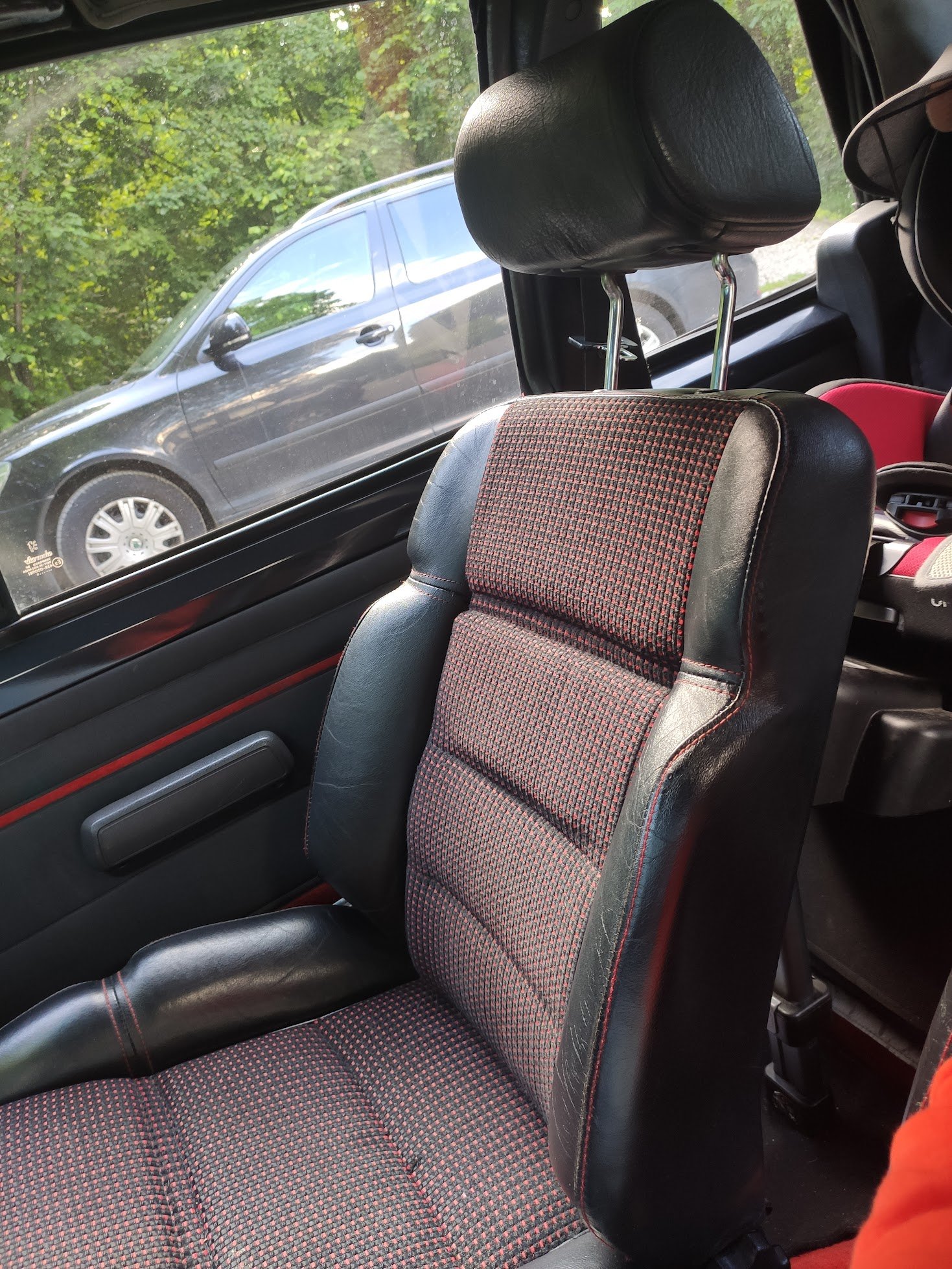

I fixed most of my seating position as you can see in the post above. Also, my seats are in great shape; I had them partially newly upholstered with old leather and they now have a heating function (It's a CTI). However, I'm intrigued by your XM headrests. The 205 headrest in their highest position reach the top of my neck/lowest part of my head, and are thus way too short. The metal pins should have been 10-15 cm longer. Do the XM ones fit a 205 seat without adjustment? And can you set them (much) higher than the original 205 headrests?

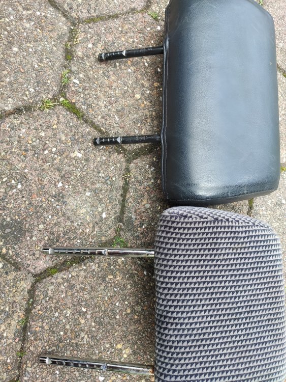

It took me a while, but I did go for XM headreasts in my 205. Yes, much taller and adjustable, and does not look out of place imho.
I found a base 2.1 diesel 1996 XM on a junkyard, and took those headrests. With the toothy fabric. As this was a base model they were not adjustable. However, it already showed that they are compatible with 205 seats. Unlike 306/Xsara/307 and so on. They also have longer metal pins. Finding someone willing to sell just black leather XM headrests without seats was a bit of a chore, but I managed.
