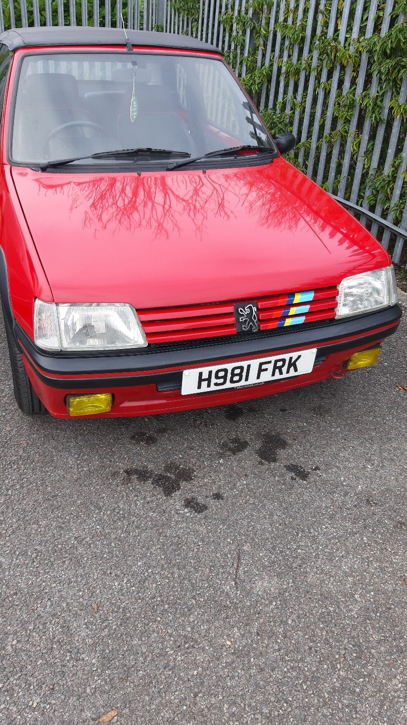

Steve K 5 1 Cars Posted November 8, 2021 Wheel wobble sorted today. My friend who did it twice said to me the adapters for centreless wheels hadn't been used in ages so thought that's why his attempts were no good. Took it to another garage today and they have sorted it. The car drives superbly now. He also told me one tyre has a small flat spot/is out of shape and one of the wheels has a buckle. Still, let's get a wedding in Ireland and Christmas done and hopefully get some 15 inch 1.9's next year! On the downside ... I was cleaning the drive today and noticed there is still a leak as drops of oil on the ground found. Going to have to keep an eye on the level and sort next year as I dont have the funds atm! Stereo sorted too today as I noticed the speakers were wired in the wrong polarity and one wasnt plugged in correctly so now it's MUCH better! I'm also still waiting for the V5C! Had to apply for it manually. Learning that it's more about the journey then the final destination when owning a 205! Share this post Link to post Share on other sites

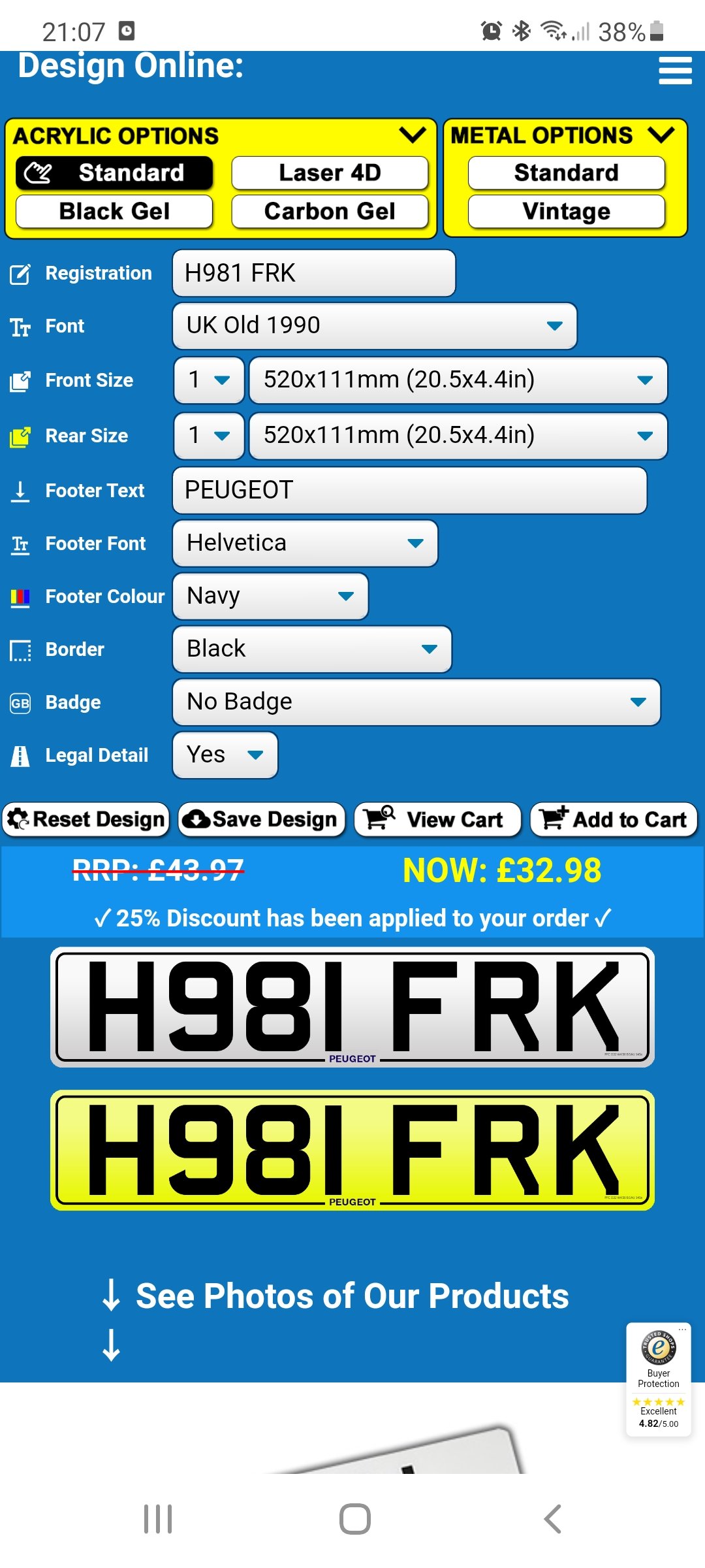

Steve K 5 1 Cars Posted January 1, 2022 (edited) So, a separate note today. I have just ordered the rallye grille sticker (I know not genuine for this car but I like it) and I want to order some period number plates (pre 2001 style - larger font) for a more 'authentic look. Anyone know where I can get them from? Edited January 1, 2022 by Steve K Spelling Share this post Link to post Share on other sites
Steve K 5 1 Cars Posted January 1, 2022 For reference, one like this... Share this post Link to post Share on other sites

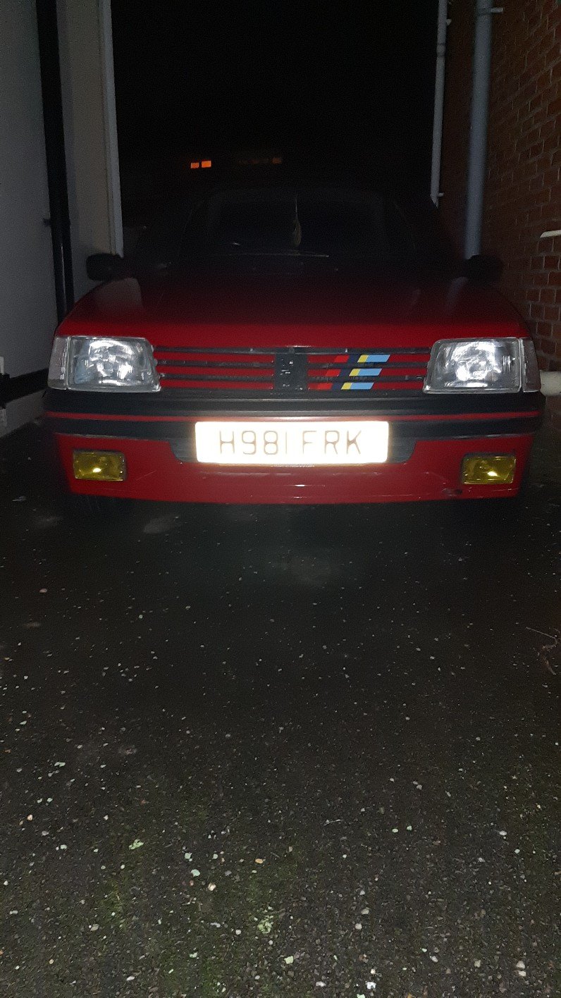

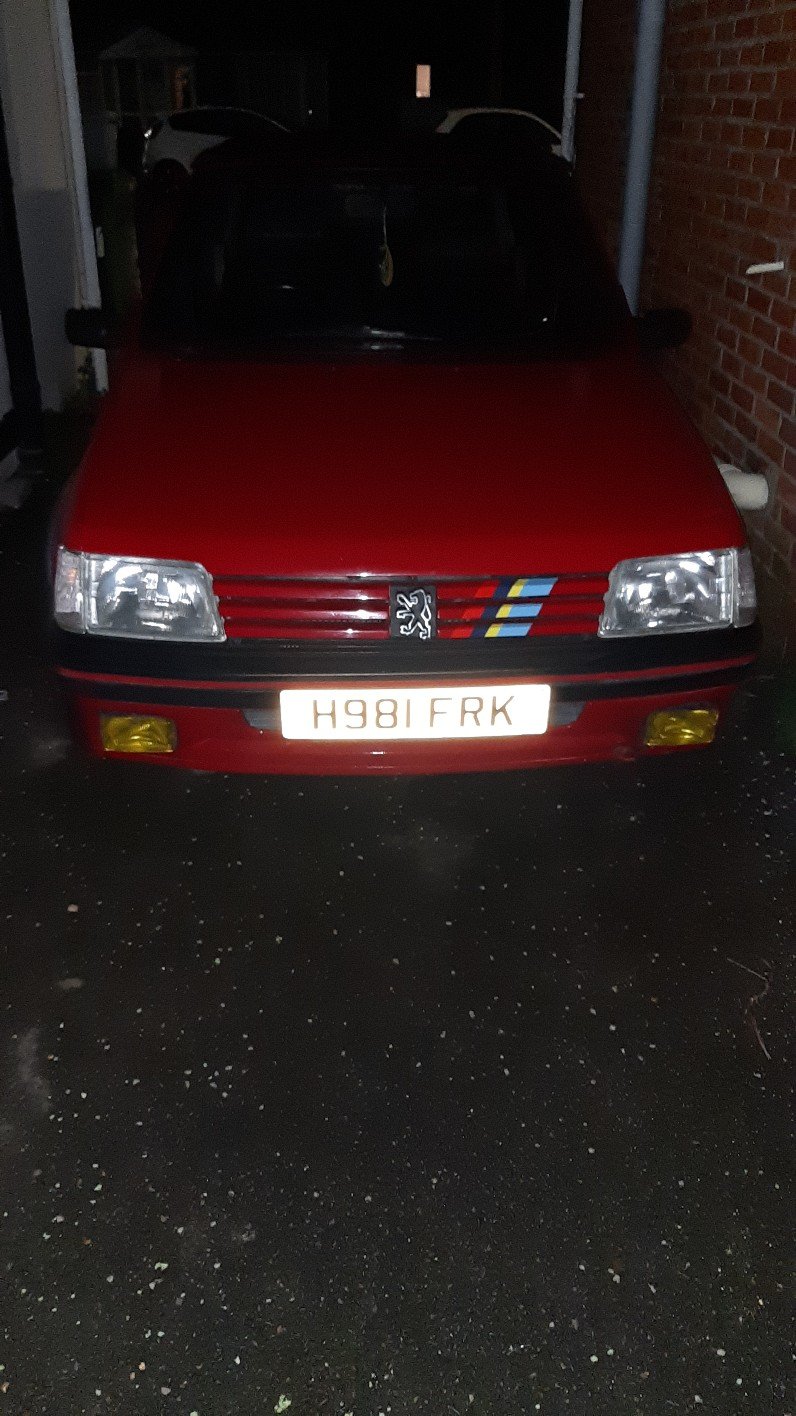

Steve K 5 1 Cars Posted January 10, 2022 Yellow fogs today .. 1 Share this post Link to post Share on other sites
Tideee 3 1 Cars Posted January 11, 2022 On 1/10/2022 at 7:42 PM, Steve K said: Yellow fogs today .. Looking good Stephen :-).....may I ask what you might be doing with your old clear fogs ?? Share this post Link to post Share on other sites
Steve K 5 1 Cars Posted January 11, 2022 Thanks Tidee. They are the clear ones wrapped in yellow film. . 1 Share this post Link to post Share on other sites
Tideee 3 1 Cars Posted January 14, 2022 On 1/11/2022 at 8:50 PM, Steve K said: Thanks Tidee. They are the clear ones wrapped in yellow film. . ha ha....nice one - Thanks Share this post Link to post Share on other sites

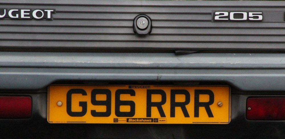

E933LVN 2 Posted January 15, 2022 Hi Steve, I've literally just done the same thing regarding number plates, I've found somebody who makes 90s style plates using the original Charles Wright font, he puts dealer names and logos on them etc, he's on Facebook..... retroplates@hotmail.com They aren't cheap but I've seen examples and they look excellent. Share this post Link to post Share on other sites
E933LVN 2 Posted January 15, 2022 .......... If you aren't bothered about getting original font dealer name and phone number etc below, you can get these made up.... Share this post Link to post Share on other sites
E933LVN 2 Posted January 15, 2022 I forgot to say, they're from Plates for Cars. ☝️ Share this post Link to post Share on other sites
Steve K 5 1 Cars Posted January 16, 2022 Wow! Perfect, thank you for that. Will sort them out definitely.. Share this post Link to post Share on other sites

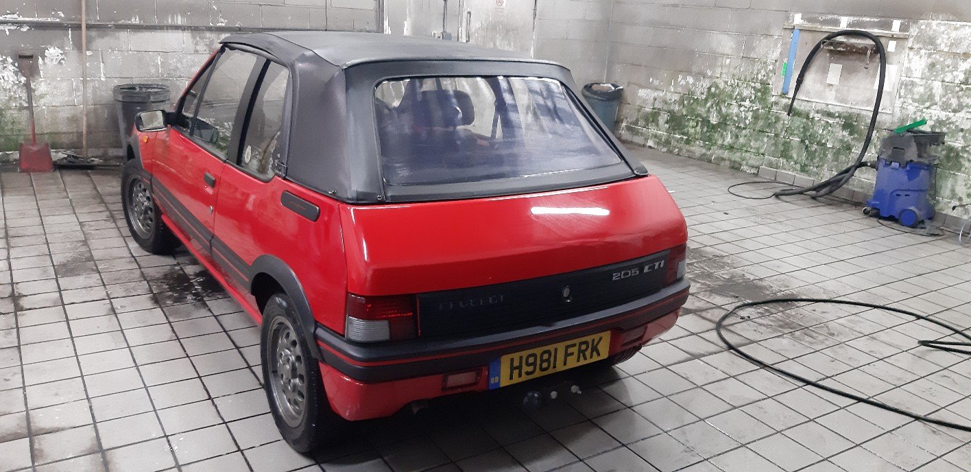

Steve K 5 1 Cars Posted February 26, 2022 Tow bar ... gone! Share this post Link to post Share on other sites
