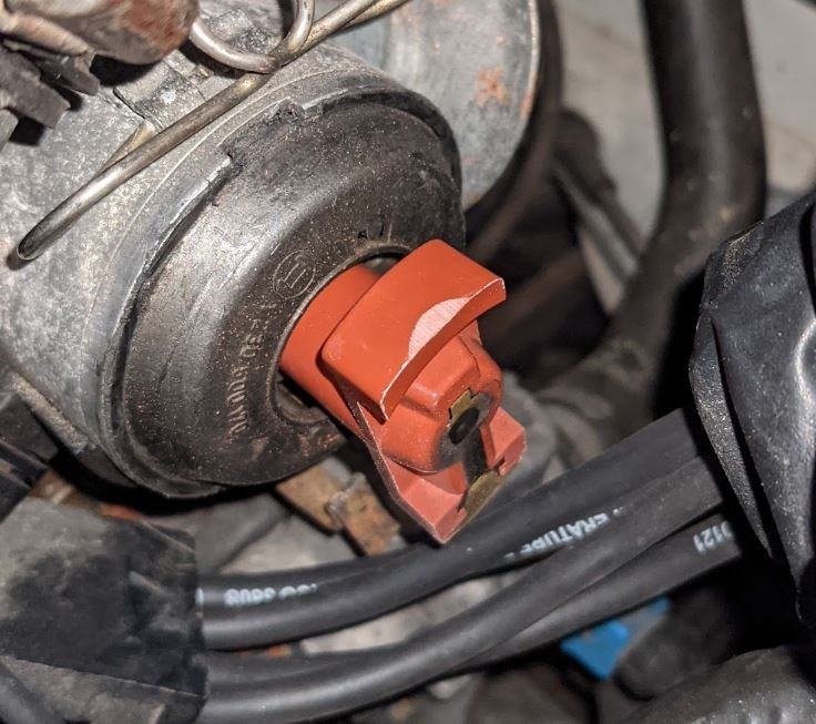

I also checked my distributor cap and found something strange, although I don't know how it's meant to look! It looks like two of the copper prongs have been worn/filed away, and the rotor shows some sign of wear. I thought it was meant to have four prongs like the two on the right?
Edited by ACJJ619
No that's fine , it's Bosch cap , they have that kind of "offset" terminal layout .
