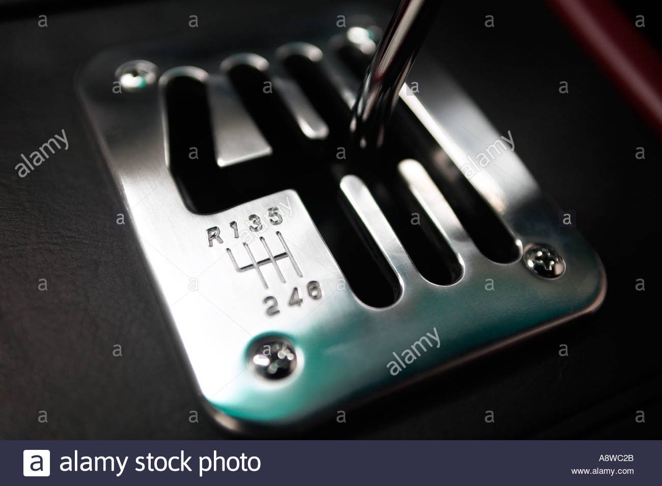

Sorry, one last thought/question - has anyone heard of anyone fabricating a gate to guide the gear lever in? Something like this....
SeasidePete
I fancy putting that in to help guide selecting although with the quick shift installed its pretty easy to get 2nd to 5th - its just first and reverse that I have trouble with. Or perhaps i'll get used to it over time.
