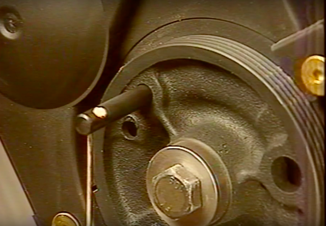

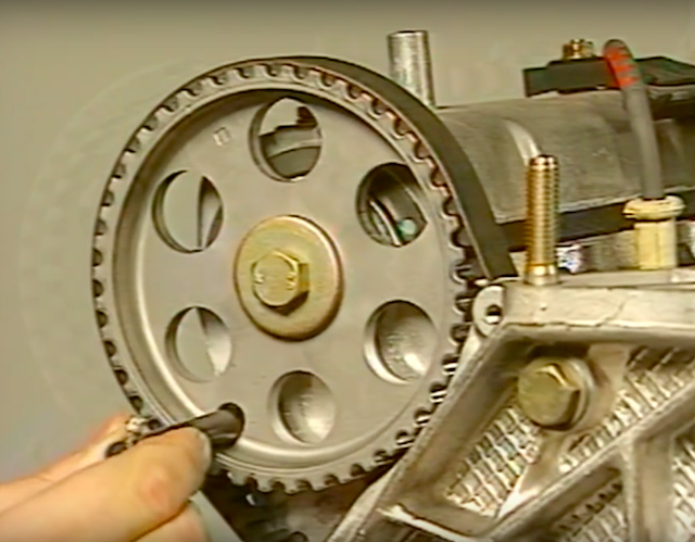

They do run if they are one tooth out. Tbh I don't understand what difficulty they could've had setting the timing right, they are as easy as they come. Checking the timing you can even do yourself, it takes a (shortened) 10mm drill in the crank pulley and an 8 mm drill in the camshaft pulley. You only need to take off the top cover to verify it yourself.

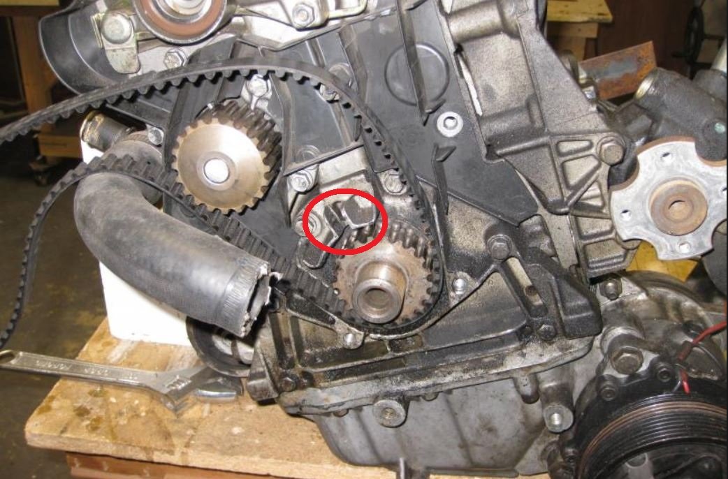

What often has happened in the past on there engines is that idiots use the bottom timing mark for loosening the crank pulley bolt. That will result in a timing slot breaking off. See attached pic for location. You can ask your mechanic how this slot looked when he had the pulley off.

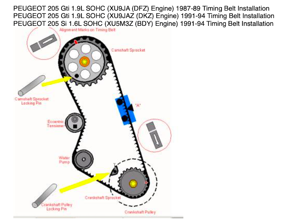

Some more info:
Haynes is pretty spot on with timing belt changes tbh, it would be easy enough for you to check it, top cover off and lower water pipe off its mountings and see if both pins will go in
karabas

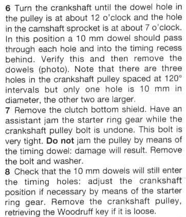

Hope this helps too.
1952838090_ScreenShot2019-12-23at22_28_06.png.eeee3a6455054fceebcbdb577296232c.png1886400487_ScreenShot2019-11-20at20_44_44.thumb.png.00209c50f9a2880b743536cfb92090a7.png

Removal of the cover at the bottom of the flywheel allows access to the ring-gear. Locking the flywheel provides much better leverage against the force required to loosen the crankshaft nut.
See image below clipped from Haynes/Coomber.
  • Thanks 1

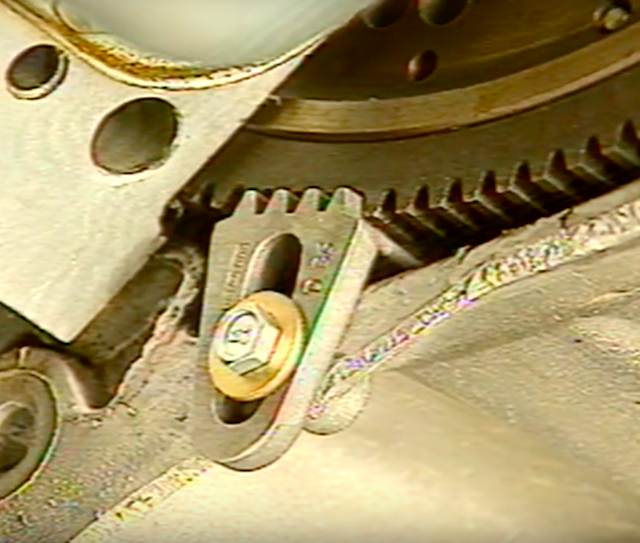

You can also lock the crank with an decapitated 8mm bolt just above the starter motor. It slides through the block into a hole in the rear side of the flywheel.
Good impact gun and you don't need to worry about trying to lock the crank or flywheel.

There are 2 "timings" that can be wrong here. Cam timing and ignition timing. Both will make a difference.
Cam timing needs to be checked first, using the pins as described in other posts above.
Then ignition timing which is adjusted by slackening the 2x nuts that hold the distributor and rotating the distributor relative to the cylinder head.

On 7/9/2021 at 7:00 PM, karabas said:
got one of these flywheel lockers, but haven't had the need to use it yet
didn't know where it slotted so was kind of fiddling around the flywheel thinkin it was supposed to slot in the top inspection hole or something..
and then I see this, so now I know
good pic hakan
  • Thanks 1

@Thijs_Rallye , I took it to another shop today with 8mm and 10mm shortened drill bits and the explicit instructions kindly offered above and they said it was 2 teeth off. And it progressively runs like s*it as further proof. So I will take it back to the original shop and ask them fix it, even though he said he was very happy to see it leave his shop, which is foreboding.  Thanks for the encouragement and help.

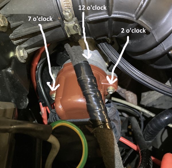

Can you snap a picture of the distributor mounting nuts? (if it is sorta centered in the adjusting range). If the distributor has been re-timed in the past with the cam out of phase I can image it will not run properly if you set the cam to the factory positions. If it runs ok now something else must be wrong.

Here it is. Can adjustments also be made to the MAF ? I ran it again today and when it became hot, it ran almost just right.
