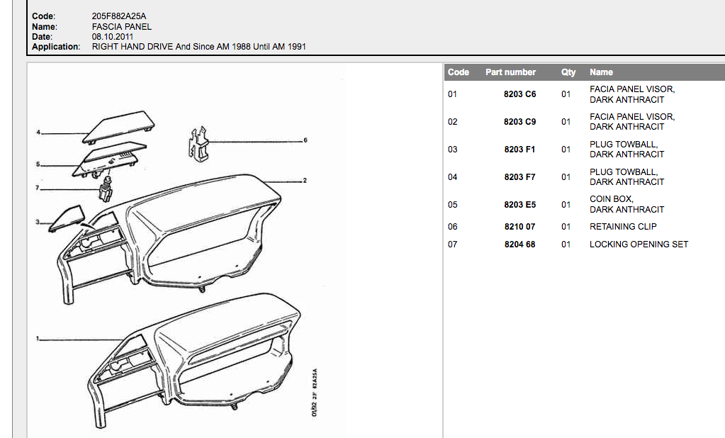

a "bonnet" is outside the windscreen, I think you mean visor, part marked 2 in catalog pic below
your visor needs to come off/out first, then you can take out your instrument cluster

if it helps you can look around the 205 catalog here : https://catalogs.ssg.asia/peugeot/?lang=en
