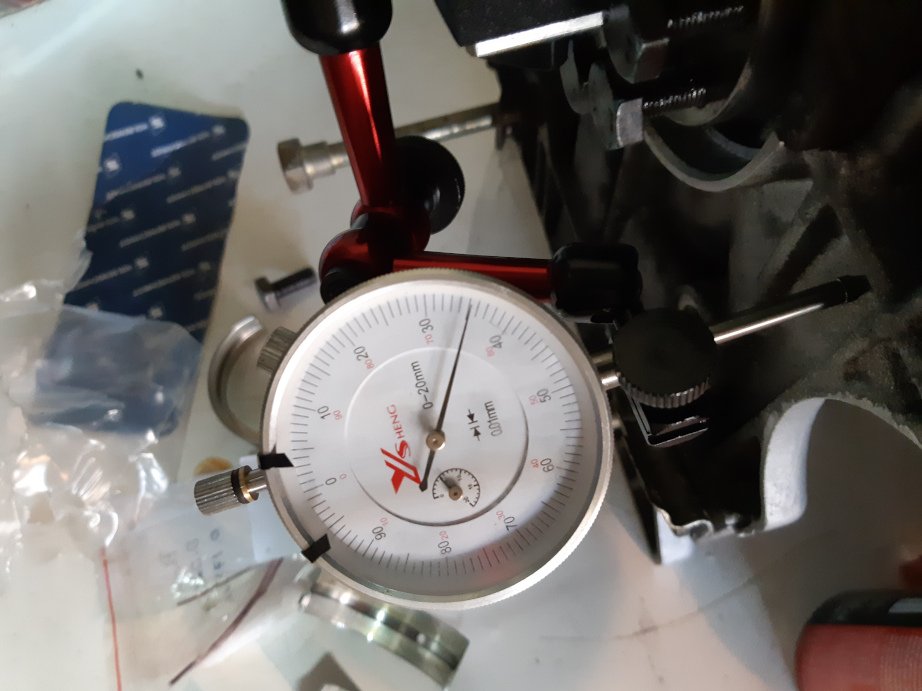

I didn't try to put the crank yet to see if it fits, I receive this week a set of platisgauge, I'll try it maybe this week end,  but it doesn't seems normal to me, what do you think, and what could be my mistake ?
Because I can't find the main bearing in the part I ordered, I want to buy a new set, but on the 2 main website I'm used to order, there is 2 parts number for XU5J, 0113 79 before 1987 and 0113 91 for after 1987. The car is before 1987, but this part is not available, what is the difference between the two, are they compatible?

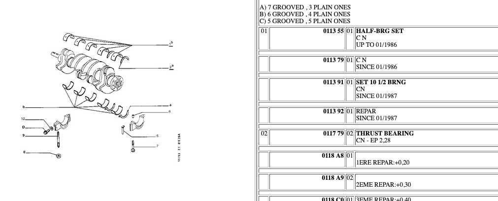

2015477576_Capturedecran2021-04-10a15_15_51.thumb.png.4e2e2f5e0be1bb173cf9c8a6f6245f24.png
Like I said early in the thread, only the 0113 91 is available, is it the C version, 5 grooved, 5 plain, or is there other différence?
Thank you,
Pierre
Leslie green
I think the only difference is how many plain or grooved bearings you get as Peugeot had a few variations , as you say you can only buy one set now so it doesn't matter  .As long as the oil holes align it will be fine.
Leslie green

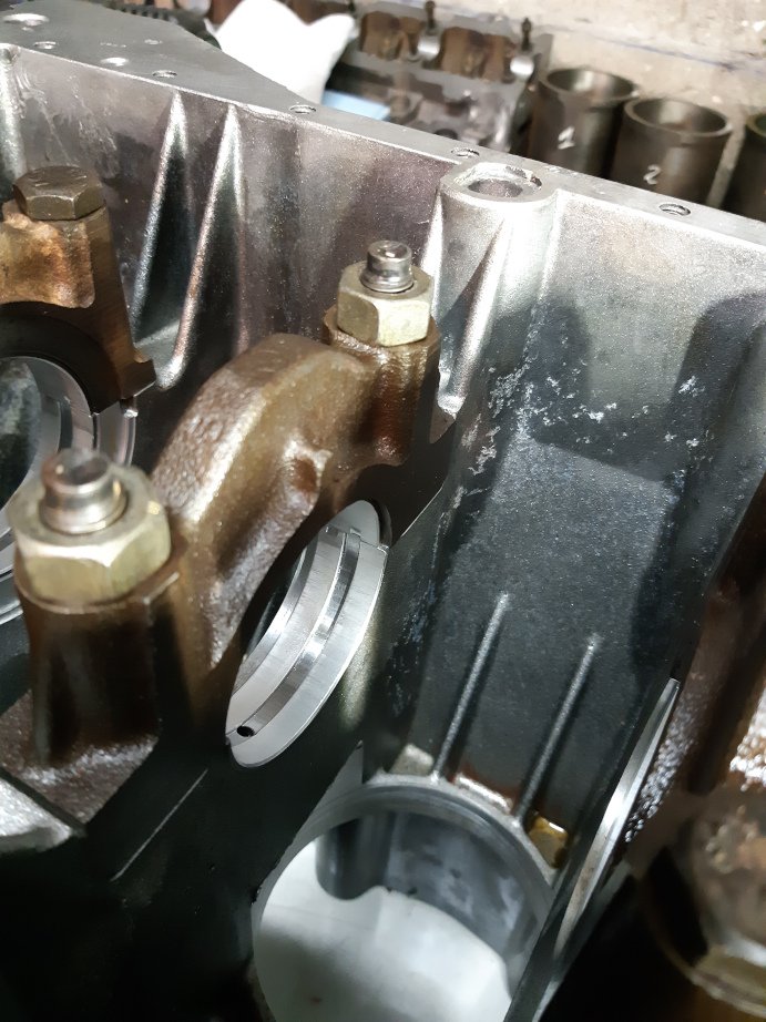

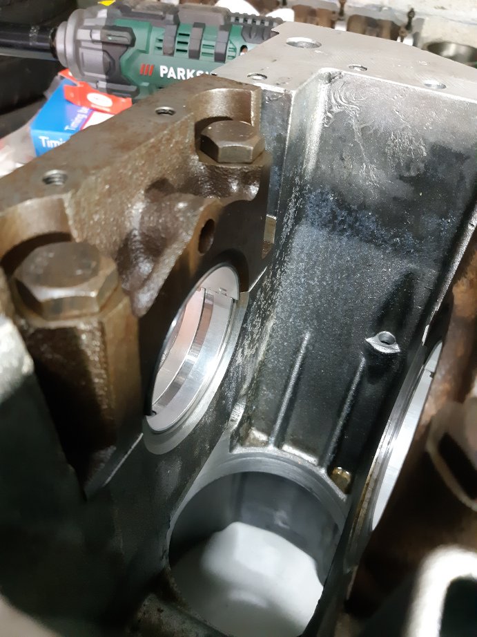

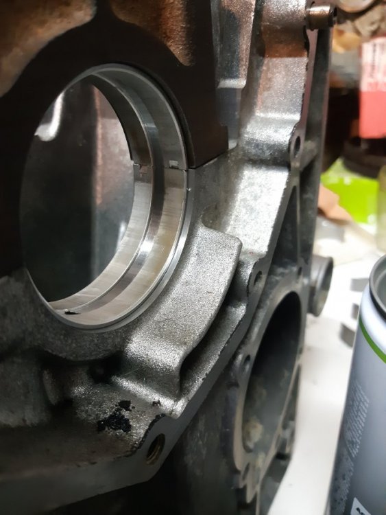

Hello,

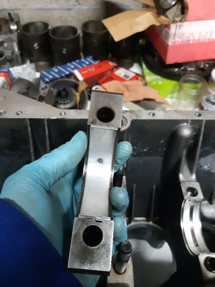

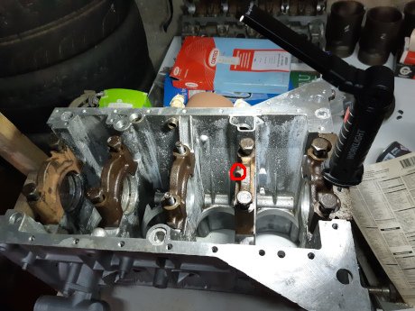

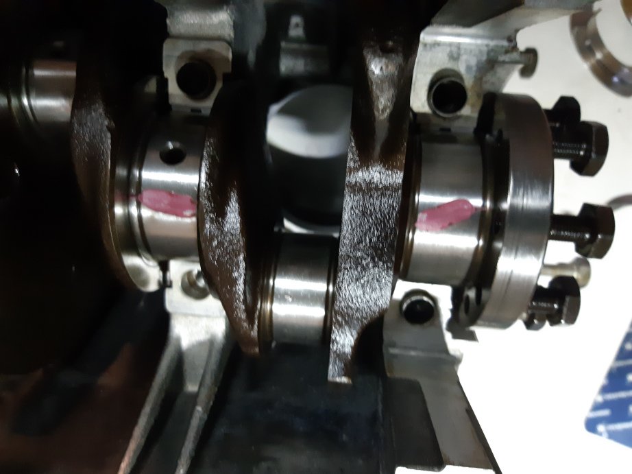

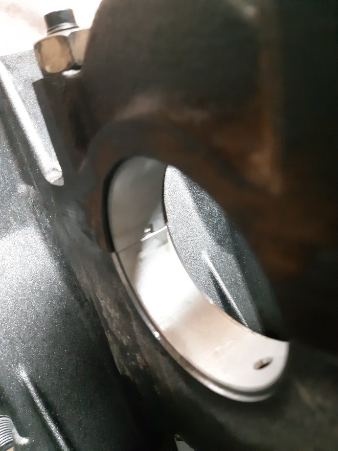

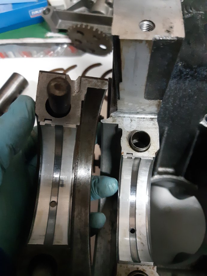

I went to the car this morning. The caps are correctly placed, and the bearing localised by the notch in the cap and the block (I hope my english is understandable on this one).
It can be noticed on the N°1, that can't be put the wrong way:

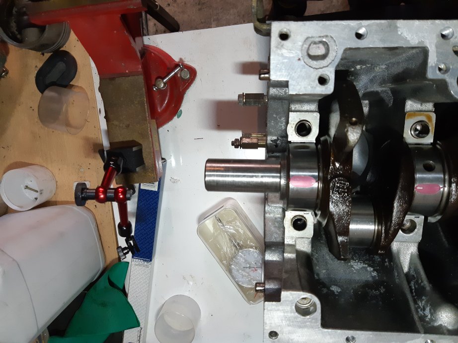

I put the crank in, and the bearing does not touch the crank, they do not protrude from the caps. The crank spins freely. I tried a plastigage on the number 5, and I have a play of 0,06mm so seems fine :

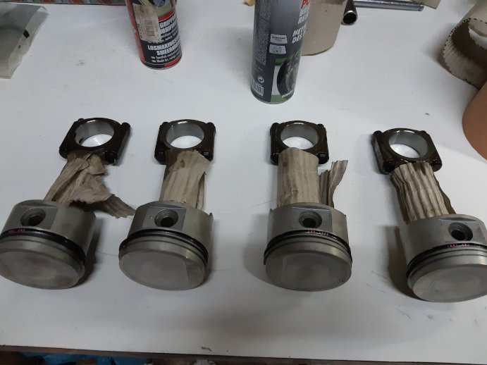

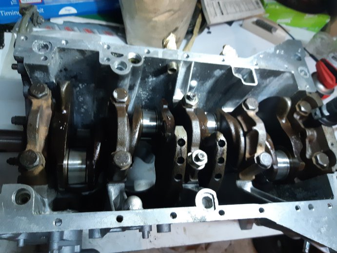

Just for sharing the picture, I took out the pistons and rods, to clean the oil I put there before storage on the big ends. The machinist has changed the pistons, and put ARP bolt.
Thanks for the answer Leslie Green, I remember something like on the thread you put, about all being compatible, just simplified with time. I am going to order a new set of bearing, and try again. Ideally, I would like 4 plain and 6 grooved, to supply the maximum oil to the rods on the main 2, 3 or 4 (depending on the one that is the best aligned.

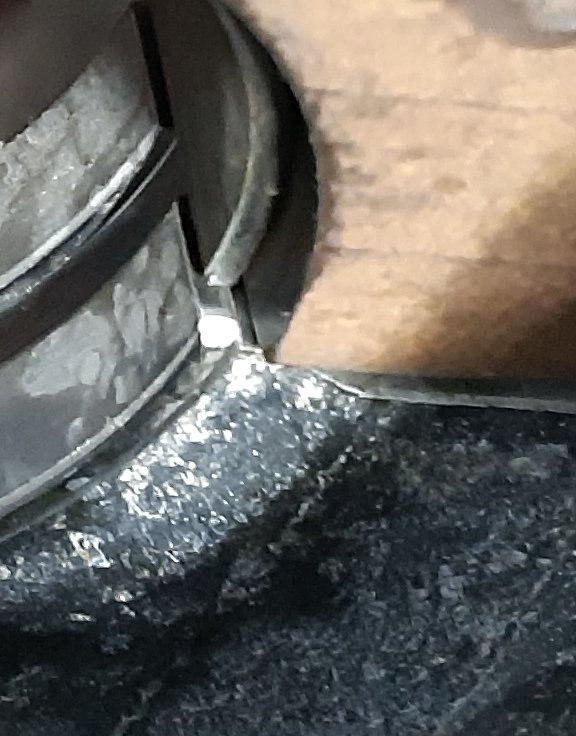

I have another issue, on one main bearing, the oil hole is not aligned, by more or less 30%. I'll check with the new bearing.
Pierre
Leslie green
1 hour ago, Pierre_b said:
Hello,
Pierre
Hi Pierre the way that top and bottom bearing shell are not aligned looks wrong to me , you may have been supplied the wrong shells as they should meet exactly inline id have thought.
Pierre_b
Yes, I agree, but I can't understand why. Those are old one, that i supposed came out of this engine, but like 10 years ago, maybe I have mixed them, I don't know. I am going to try again with the new set of bearing and I let you know, I have found a website that supply the 4 plain/6 grooved in glyco and STD.

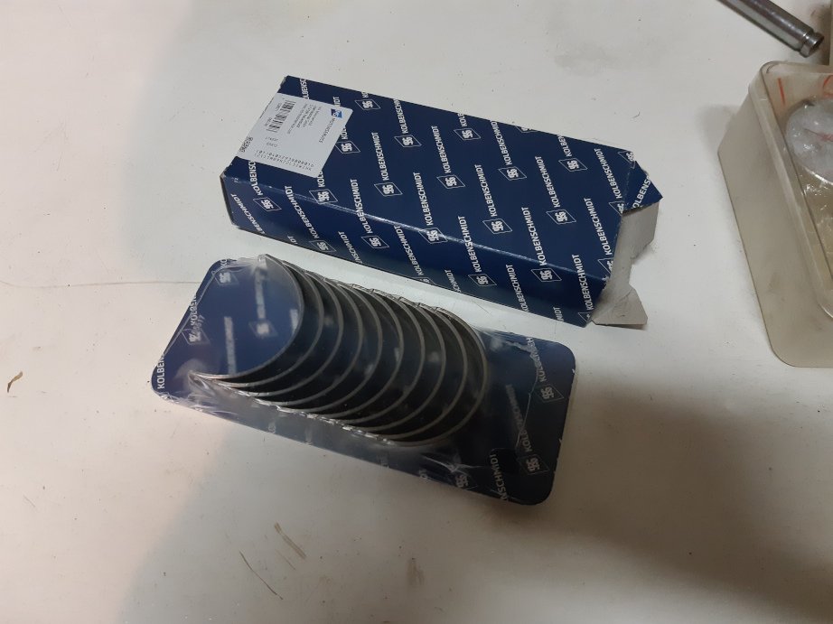

I am still waiting for my main bearing to arrived, the supplier switch to Kolbenschmidt, and I probably will have 5 grooved and 5 plain, not what I was hoping, but, I'll do with it

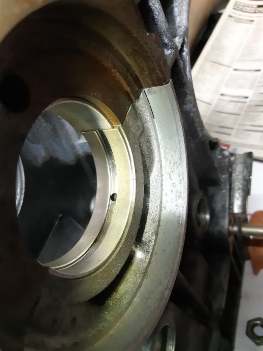

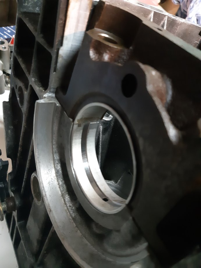

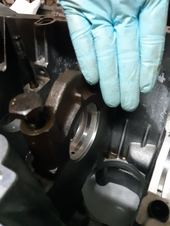

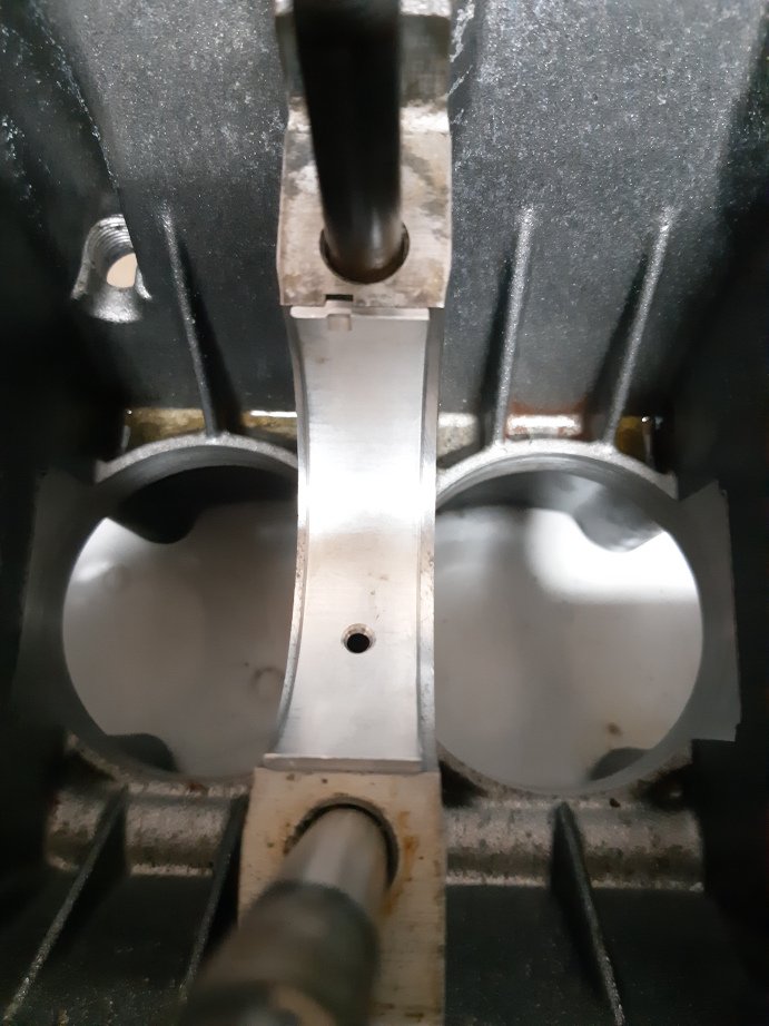

Hello,
After a week of vacation, I have received my new main bearing :

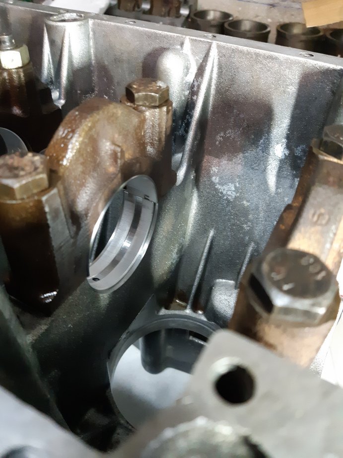

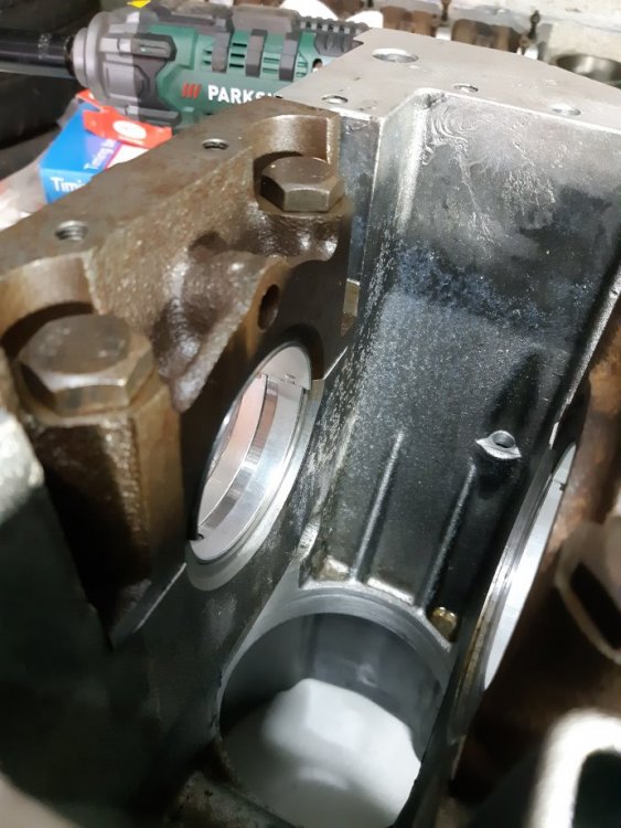

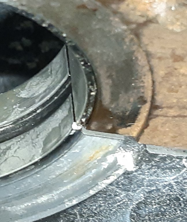

so this morning I went to the shed to try them, and the problem is the same :
N°1:
N°2 : It's the only one correctly aligned.
N°3 :
N°4 :
N°5 :
I think that I have the wrong one, one this post https://www.planete-205.com/forum/205-gti-1-9l-am87-en-restauration-remontage-t44868-405.html , there is this picture, making me think that I may have the wrong bearing, the slot of the top and down are shifted on this set, I am a bit lost...shidenkai_o_1crt6htl3cbe1lb0lqgel4sop.JPG.9dbe221704319fb4bd5f78df54d8370c.JPG

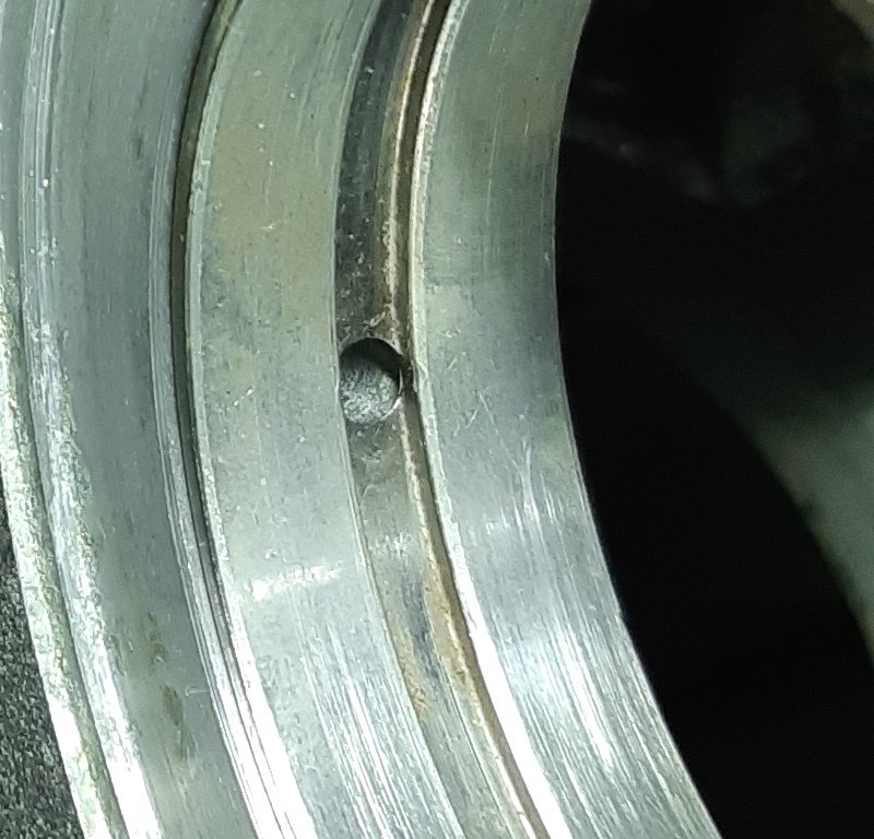

Another problem is that the oil hole of the number 3 is not aligned :

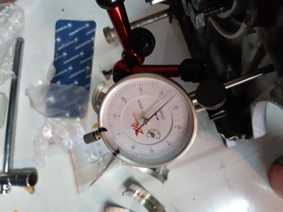

Still I plastigaged the bearing, it's around 0,06 mm, and 0,1 mm of lateral, so it's ok.
I am a bit lost, and bored, I threw some money away in those bearing and I don't see a solution, so if you have any advice...
Pierre

Put the plain bearings in the block and the grooved ones in the cap see if it makes any difference Pierre as they appear to be the right size anyway Do the plain ones have oil holes I can't tell from the pics  ?
I will try this, good idea, and yes the plain ones have holes. The car is in a shed few miles away, I won't be able to try before the end of the week.

DamirGTI
18 hours ago, Pierre_b said:
the correct part number should be 0113 55, but I can't source it.
0113 55 Bearings shells seem to be for early 1.6's - 171A , 180A and B2C ... 205 and 305 1.6 from 1982 up to 1985 .. but some part catalogues lists them for later engines as well , both 1.6's and 1.9's .
There's 7 grooved and 3 plain/solid shells in that 0113 55 bearing set .
Maxi bore OD. - 63.726mm
Width - 20.29
Thickness - 1.854
Available from (all STD 0.00mm) :
King Bearings - MB5536AM
Glyco - 6605M
KS (Kolbenschmidt) - 77129608
.. some i see on stock some you'll need to order , depending on where you buy parts from .
To me , looks like the locating tangs on the bearing shells which you've bought till now do not match the machined recces for the tangs in the block/caps . Bearing tang spacing is wrong/different .
Do you know any history of this engine ? and do you have old bearings shells from that engine/block ?
If you cannot find suitable shells , grind off the tangs from the shells and center them by hand , as long as the dimension is fine (which you've checked with "plastigauge") and the thrust bearings/measurement on the crank is good it'll be fine ... it's the "crush" what keeps the bearing shells in the bore anyways .

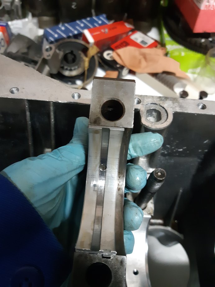

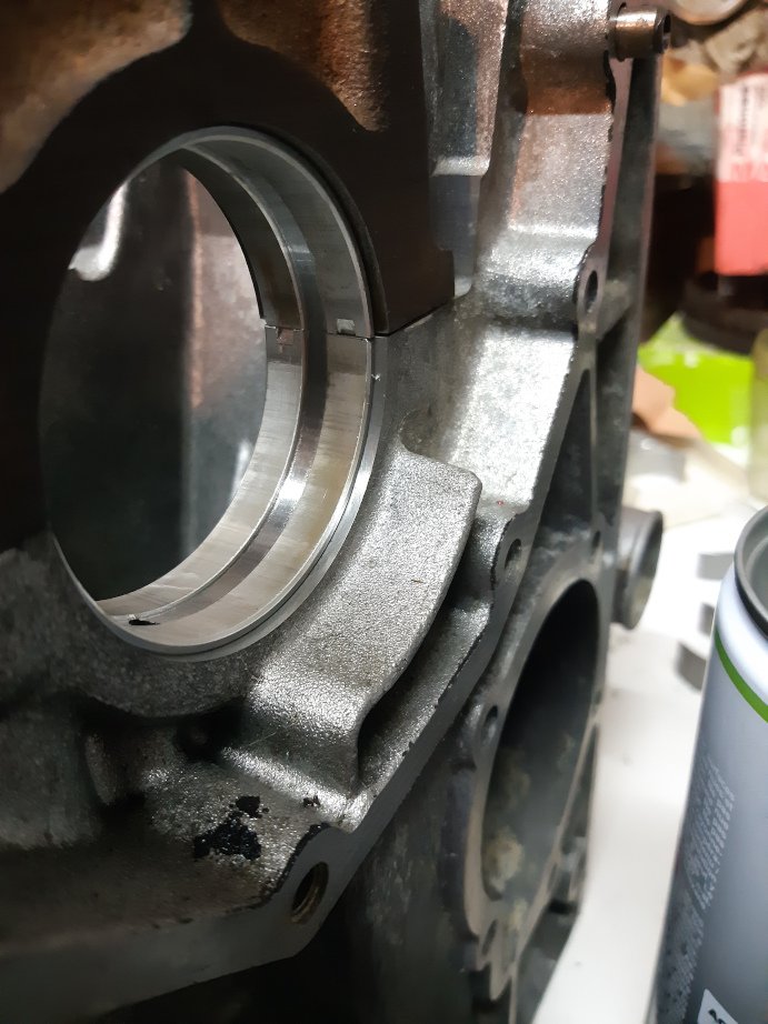

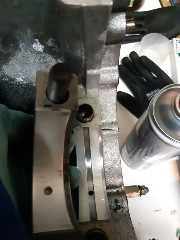

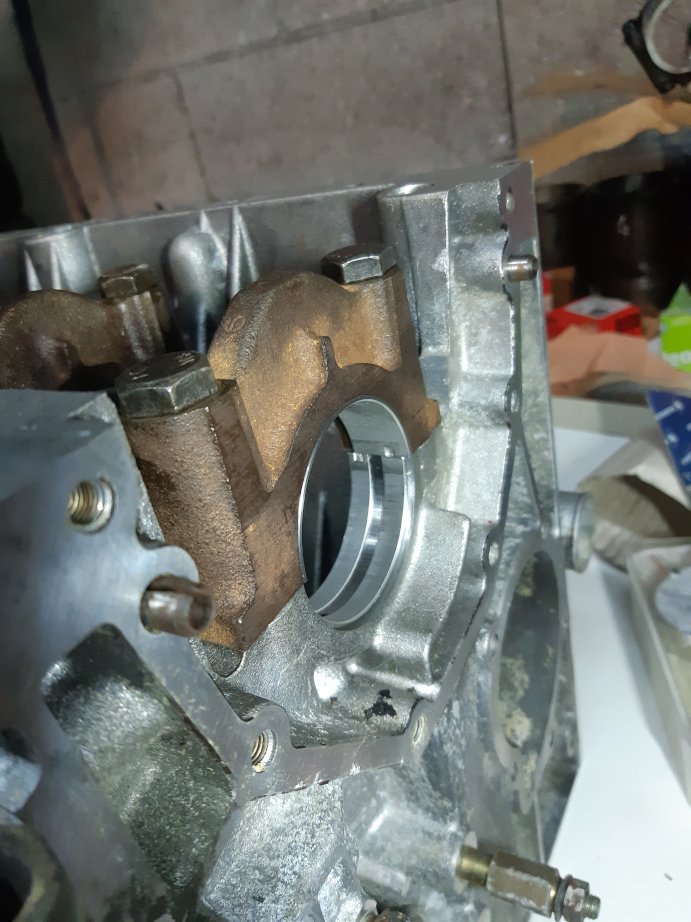

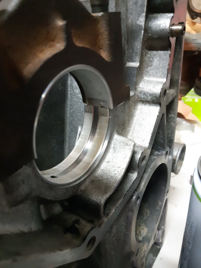

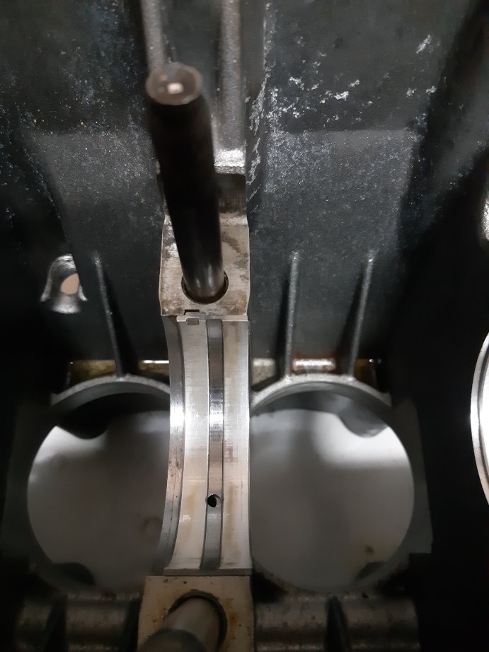

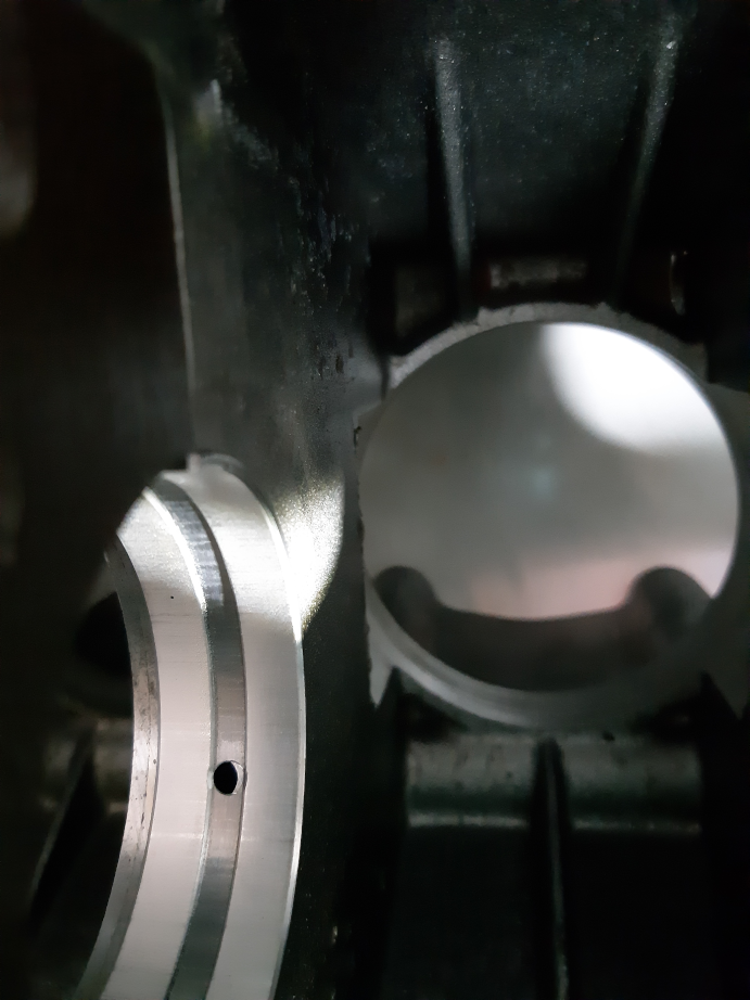

This morning I went wrenching a bit, but I only have half an hour on the 205 engine. I wasn't able to search for some old bearing from my mess (maybe the bearing at the top of the post are from the 115 engine that I bought for the crank).
I tried to mixed the bearing with interesting results :
Number 1 :
52143789_20210501_083155palier1plaingrooved.thumb.jpg.068417dd9ed8f65f5ebbf205cc6c3761.jpg400463603_20210501_081701palier1cap1grooved.thumb.jpg.2dd5a5ccfaf94518b75e223ab81c73d5.jpg
The best result is with a grooved on the block, and a plain in the cap.
Number 2 :
I didnt take a picture, but same as the 1 : a grooved on the block, and a plain in the cap.
Number 3 :
395401989_20210501_081432palier3grooved.thumb.jpg.bea325b492a09e4f6c4829439baf4a0d.jpg1988792317_20210501_081500palier3plain.thumb.jpg.9fb229290f9b73449912fd2b46acfbe5.jpg36002089_20210501_081538_palier3capsgrooved.thumb.jpg.27a68b2fe9617cb91f501b2cd4a1fbb8.jpg66010648_20210501_081611palier3capplain.thumb.jpg.7eb963dd88201fffcc8fca9e33a55b60.jpg
1420753643_20210501_082700palier3plain.thumb.jpg.cfb182cf77980a1421803d9d4f32fdb2.jpg
The best result is with 2 plain bearing, and the oil hole is aligned. I don't like it for the reason I stated earlier in that post.

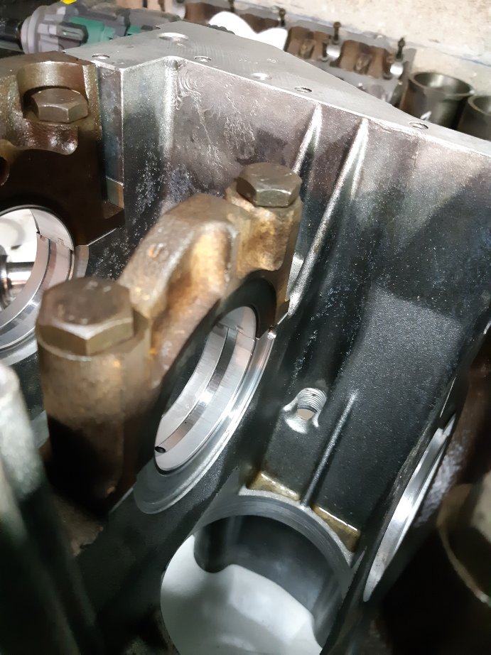

Number 4 :
407277926_20210501_082446palier4grooved.thumb.jpg.c6748ec3b9b8eac2f131d3183e9332f6.jpg
The best result is with 2 grooved bearing
Number 5 :
865269094_20210501_082123palier5groovedplain.thumb.jpg.5283a67e0702fa6cc9d4e7fa7bbb78da.jpg122873174_20210501_082257palier5groovedplain2.thumb.jpg.0f27123da8ad337440b74ccb985da696.jpg1009829038_20210501_082229palier5grooved.thumb.jpg.5d9826b0f670328f23598a73bb0be02e.jpg
The best result is with 2 grooved bearing, like the number 4.
So, to sum up :
1 : 1 plain, 1 groove
2 : 1 plain, 1 groove
3 : 2 plain
4 : 2 grooved
5 : 2 grooved.
So I could do with 6 grooved and 4 plain. But I don't want to have 2 plain on number 3, because it's feeding the rod 2 and 3.
- The rod number 1 is fed by 1 plain/1grooved from number 1, and half of the flow from number 2 1plain, 1groove.
- The rod number 2 is fed by half 1 plain/1grooved from number2, and half 2 plain from number 3 (I spuned that rod on that engine)
- The rod number 3 is fed by half 2 grooved from number 4and half 2 plain from number 3.
- The rod number 4 is fed by half 2 grooved from number 4 and 2 grooved from number 5 (it should be the most oiled rod).
The rod number 2 seems really badly oiled.
I am pretty sure that I am going to modify a grooved one to be use in the block, in main number 3. I am wondering if  I am going to take one grooved for example from the cap number 5, and modify the plain bearing from number 3 to make it fits, or by a new whole set. I am also not really confortable on the way to suppress the locating tang.
Thank you for your advice and returns on my thinking,
Pierre
DamirGTI
Posted (edited)
No that doesn't look good ... new shells , or modify/grind off the tabs and re-locate them by hand .
If the oil holes on the grooved shells don't line up 100% with the block oil feed holes - file them carefully with an small/thin round file till they line up .
Grooved shells always go into the block (ie. - up) .. they're grooved to provide oil feed from the block to the crank journals .
Plain/solid into the caps (ie. - down) .. plain/solid surface in order to increase load carrying capacity .
The locating tabs on the bearing shells are not to secure the shells from moving/wandering off , also they do not secure the shells from spinning round the bore while in use .
There's many engines/blocks of other car brands/makes which do not even have them tabs on the bearings at all .. it's starting to be the "thing of the past" , was meant mainly for the factory facilities for ease of engine/block assembly on the production lines .
The "crush" is what keeps the shells securely in the housing bores , as an "press fit" , not the tabs ... need to note , it's very important , when installing the bearing shells in it's housings they must feel springy/snap into place/housing tightly , only then you'll know the "crush" on the shells will be good once the cap is on and torqued up . If they're loose fit in the housing - no good , need to investigate why , make some additional measurements etc.
https://www.championbrands.com/wp-content/uploads/2019/11/TB072015-1.pdf
Needles to says , surfaces must be spotlessly clean when doing engine rebuild , lint free cloth and lots and lots of brake cleaner fluid/spray .. also check/measure two or three times the same part to be double sure it's right and ready for the assembly .
