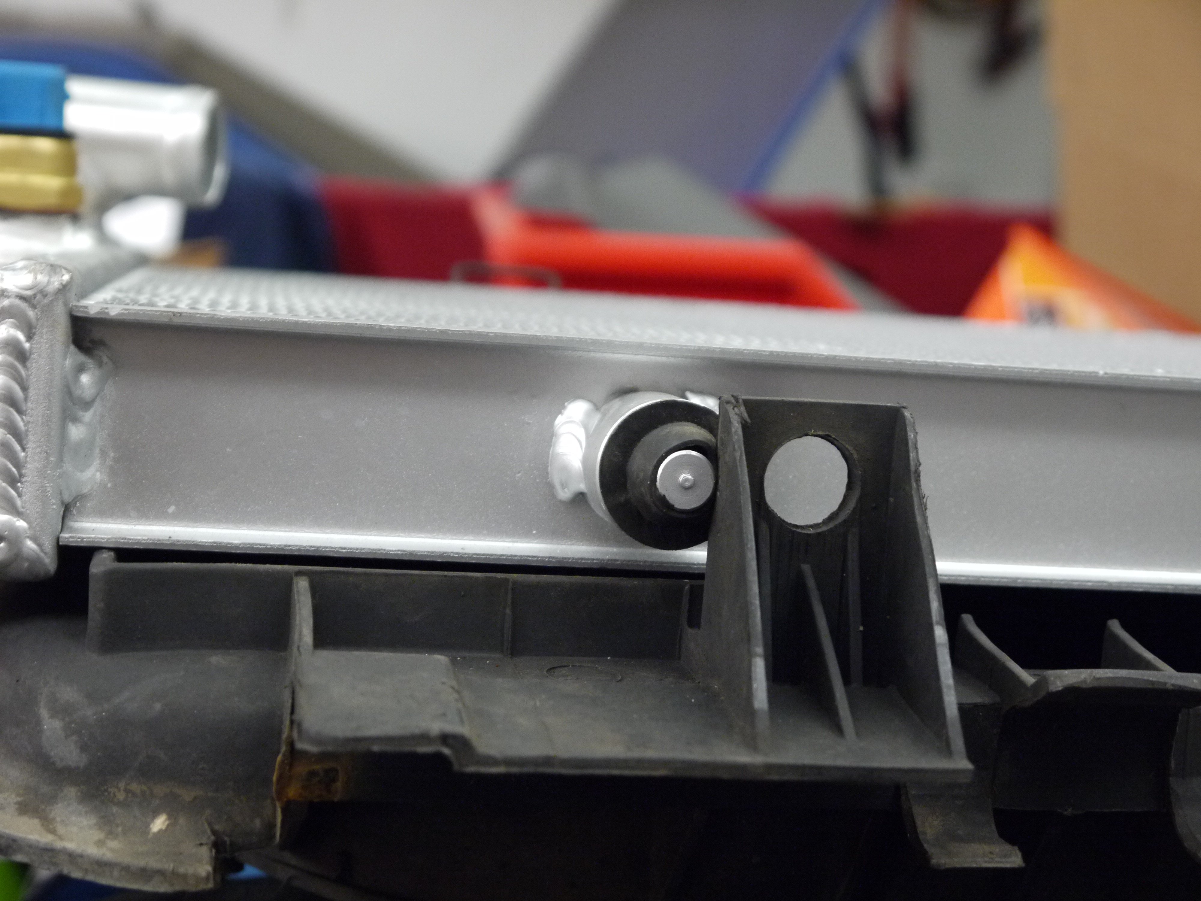

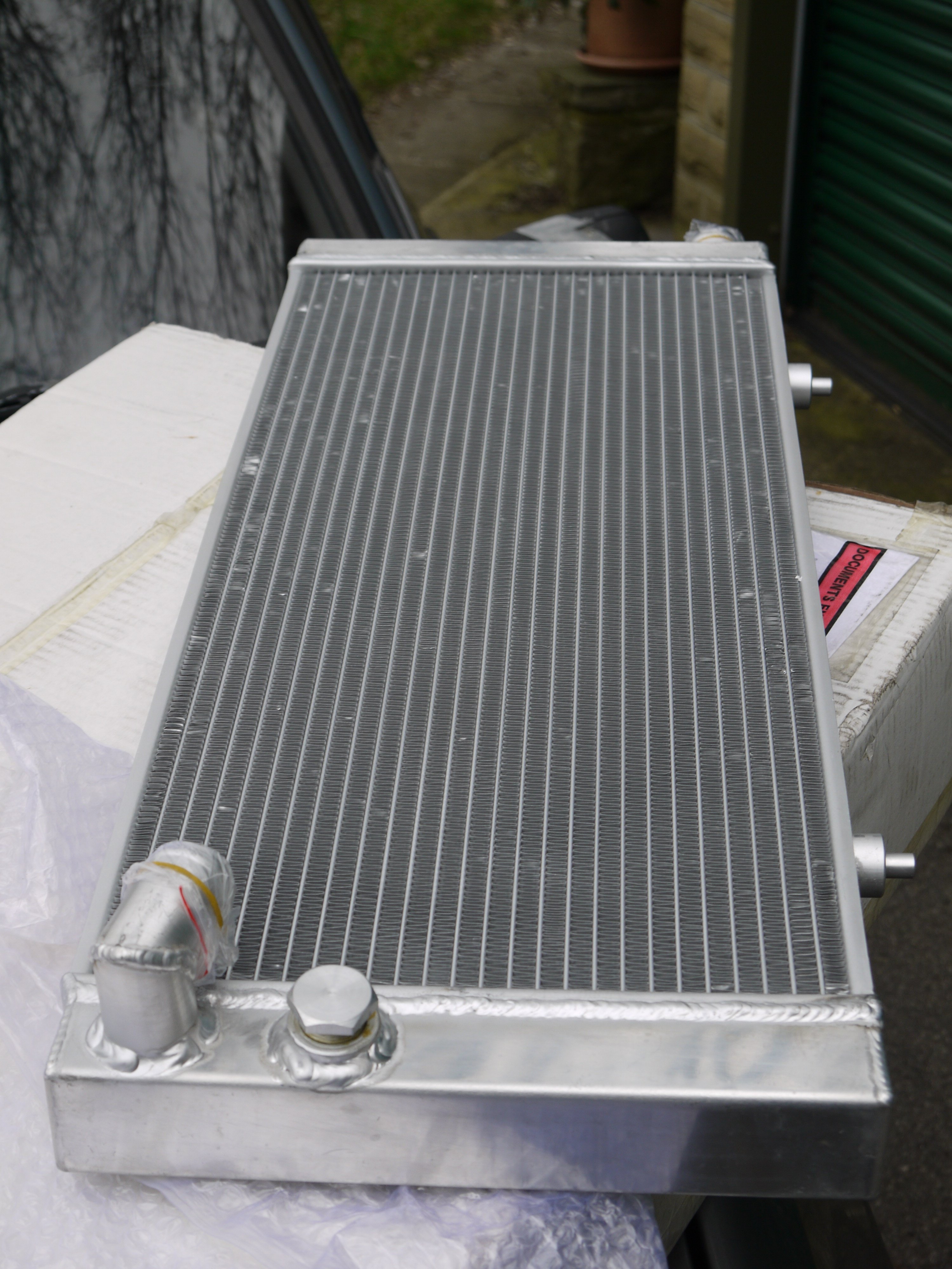

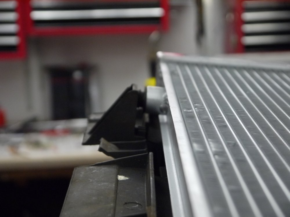

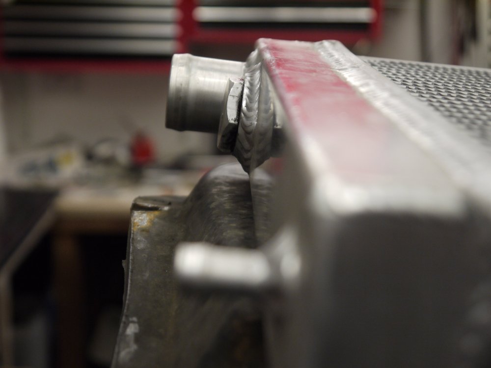

Ozymandis 104 Posted April 4, 2021 (edited) Fleabay cheap alloy rad. The 2 threaded bosses are machined wrong and needed a large amount filing off at an angle to get the plug/thermo switch to seat, its 8mm too short so the top spring retainers wont work and the bottom mount bobbins are welded on in the wrong place. 1* Watch this space to see if it leaks. Edited April 4, 2021 by Ozymandis Share this post Link to post Share on other sites
Ozymandis 104 Posted April 17, 2021 I got around to making an adapter to fit it, 8mm x 25mm strip , drilled and tapped m10 and a couple of VW T5 wheel bearing bolts, fits perfectly in the standard mountings now. Share this post Link to post Share on other sites
