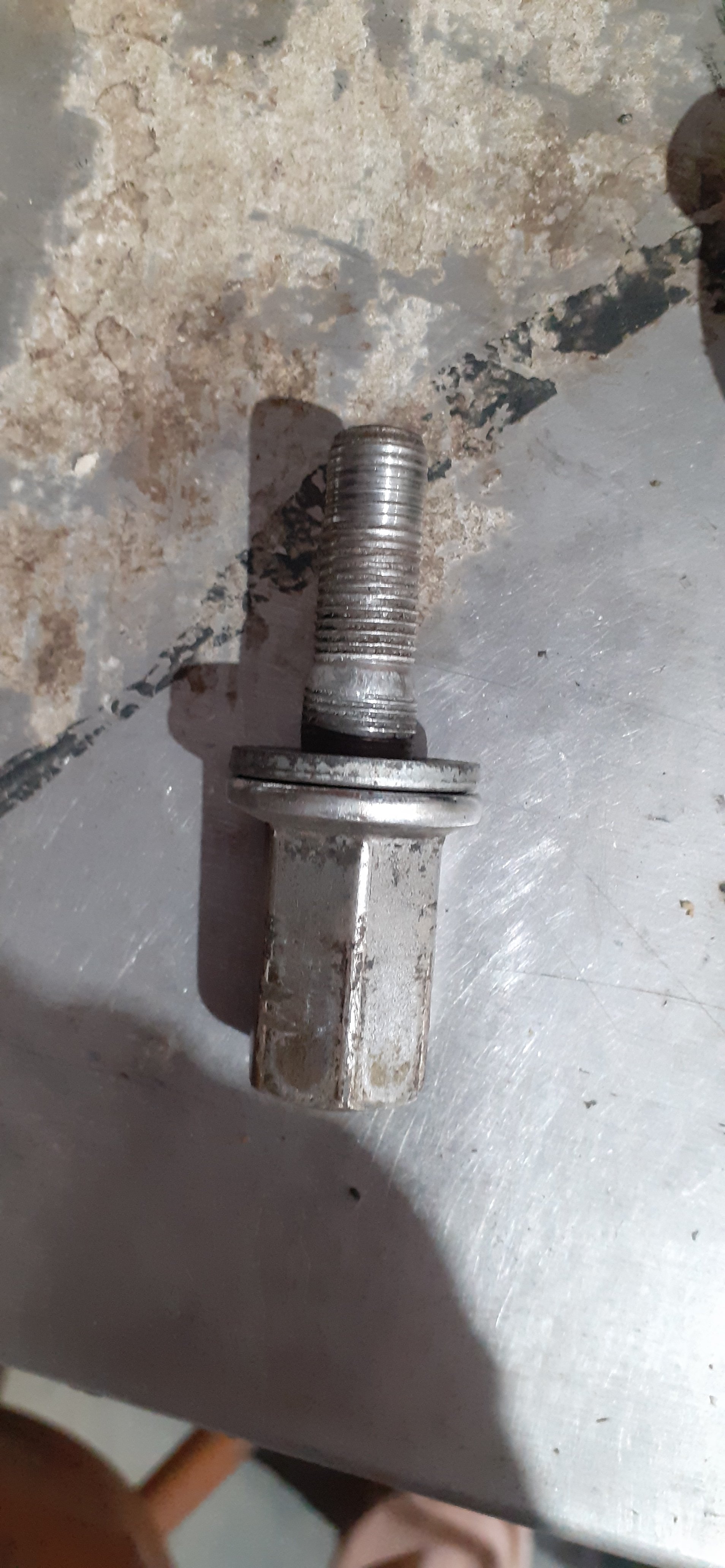

Steve205 16 1 Cars Posted March 29, 2021 Hi all. Can anyone tell me whete I can source bolts for 14' pepper pot wheels off a 1.6 gti? Got wheels balanced today and 2 bolts are pulling on the thread and not tightening. They are the long headed bolts. See photo. Thanks. Stephen Share this post Link to post Share on other sites
welshpug 1,682 Posted March 30, 2021 pepperpots are ford XR wheels... have you checked the drive flange/drum threads? these bolts are pretty tough things and don't just pull threads, they will have been crossed under many many Uggaduggas at some point. Share this post Link to post Share on other sites
Steve205 16 1 Cars Posted March 31, 2021 Apologies Welshpug. Was not sure of correct name for the pepperpot effect wheels on the 205 gti. Thanks for information. Just took off wheels and I have 2 drum threads that are both letting 1 bolt spin endlessly. Probably from over exuberant tightening by previous owners/car shops. Forgive the silly question,can these be re-threaded or what's my best plan of action to fix? Newish to this 205 life, but want to have car in great condition. Thanks again. Stephen Share this post Link to post Share on other sites

Tom Fenton 1,582 Posted April 4, 2021 Drum threads can be helicoiled easily and safely I have done it a number of times. Share this post Link to post Share on other sites
Steve205 16 1 Cars Posted April 7, 2021 Just Helicoiled drum threads. Snug as a bug. Thanks for the advice Tom. Appreciate the info. Shiny new bolts fitted now. Stephen Share this post Link to post Share on other sites
