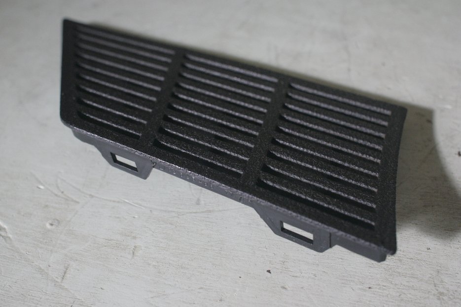

here's what it looks like out, this is the Right Rear
there are two small tabs along the bottom pic2, and two more substantial ones along the top surface

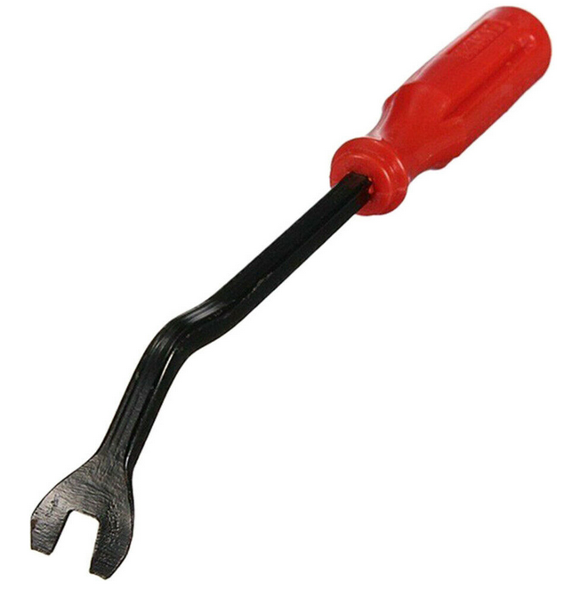

I've used a flathead or a panel clip remover in the past
I found the plastic here to be more forgiving than other areas, but still be careful as its old
