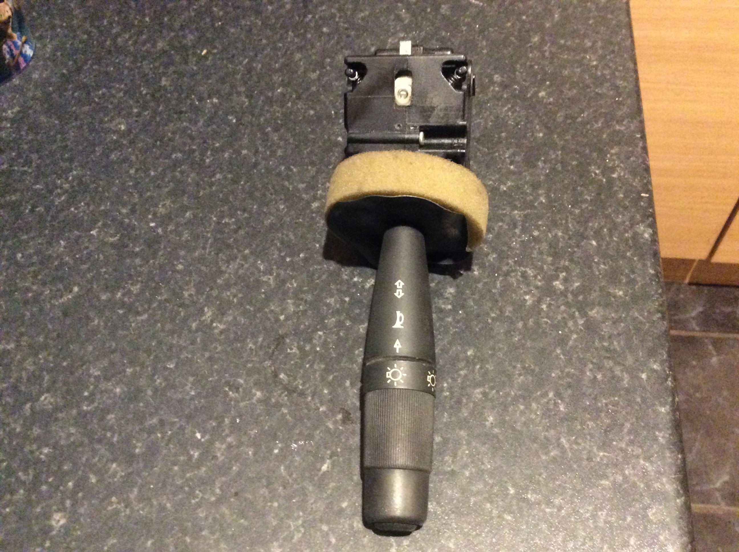

Anyone had an issue fitting a non genuine headlight stalk? Bought one from France and the little plastic lever which moves when indicating seems to be wrong shape and stops it from fitting correctly - genuine one has a flat lever whilst aftermarket seem to have an L shaped lever meaning it catches on the steering wheel and won’t sit right? Anyone else had this issue?

Ditto , bought two Valeo stalks .. one is in use for some time now with no problems what so ever .
Valeo stalks are good .. unsure about other aftermarket alternatives .
All the stalks i've seen for 205/309/405's have flat leaver , never seen one with L shaped .
The leaver on Valeo stalks is metal made , if yours is plastic modify it/cut the L part off and make it flat  .. if it's otherwise good ?
Or if you still have old one you can disassemble it and switch over the leaver on the new one .. it's a bit fiddly taking the stalk apart but if you're patient it's doable .. but if you can make L "straight" as it's plastic that's the easiest .
D
Pic of the new Valeo stalk :
You can see the L shaped lever here, cutting the end off makes it too short to reach the tab on the back of the steering wheel to turn the indicators off

£319.99 + postage for that "L" shaped one on ebay !! :o , cheeky bastards , someone needs a bloody good hiding ....
Those are Chinese Aliexpress knock off stalks , for average 5-to-6 quid per piece .. hence the ebay listed price for them ridiculously inflated !
Identical stalks also came as re-boxed "Italian made" stalks , in blue "Hoffer" or yellow "Sitad" box .. also as "Meat & Doria" , "Stark" , "Polcar" and possibly some other too  ... those are around 50 quid per piece at the EU car parts shops . So be aware .
Dunno what they made them for anyway , with that L shaped tab ... strange .
Valeo currently seems to be out of stock ... try : "Febi 17941" , or "Van Wezel 4025Z91" , they look like the Valeo stalks on the pics (with correct indicator tab) possibly they're made by Valeo but repacked in different box .

Mystery solved , the "L" tab stalks are for Renault's ! (R19 , Clio Mk1..) .. so ingeniously , they're using the same stalk main body with just the different switching leaver slapped onto it and sold as fit for Peugeot .

I ordered a Febi one but the stalk was longer than the original Peugeot OEM one, so ended up sending it back!
That'll be 405 stalk then me thinks .. overall same shape as 205/309 stalk but with the longer activation/switching leaver .
Anyhow the 405 stalk wont fully work when plugged on a 205 loom , lights will but not the indicators .. not sure if it can be rewired to make the indicators work .

This looks like the issue I'm having , the aftermarket L shaped tab wont left you operate the indicators without a fair bit of force at times depending on steering wheel position , it was bought to replace another the same new one as I cut the tab of while fitting and tightening the steering wheel.
I opened it up thinking I could take the tab of my old jageer stalk and put in in the new one as the end had come of it but damn these things are complicated inside and there are tiny little springs and a metal c clip have fallen out which I've no idea where they go.
Not sure if anything can be done with the l shaped tab like shortening it a little to make it work but a shame as its otherwise well enough made.
