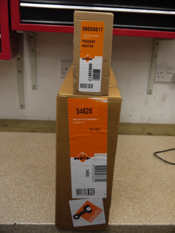

Has anyone used an NRF (NetherlandsRadiatorFactory) radiator, do they fit well or have any problems anyones aware of please?
I ask as my local supplier has these and as i want 3 rads he will give a good price and is a decent guy so i`d like him to have my business.

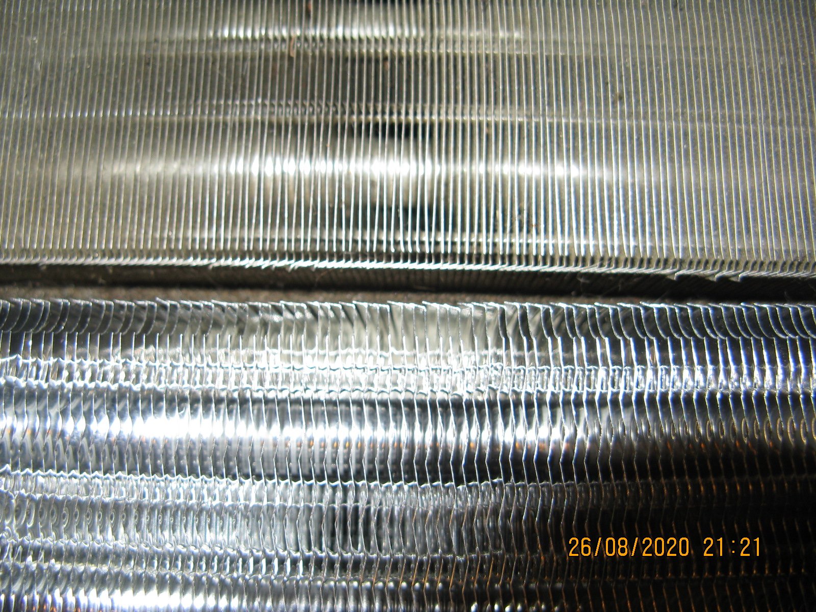

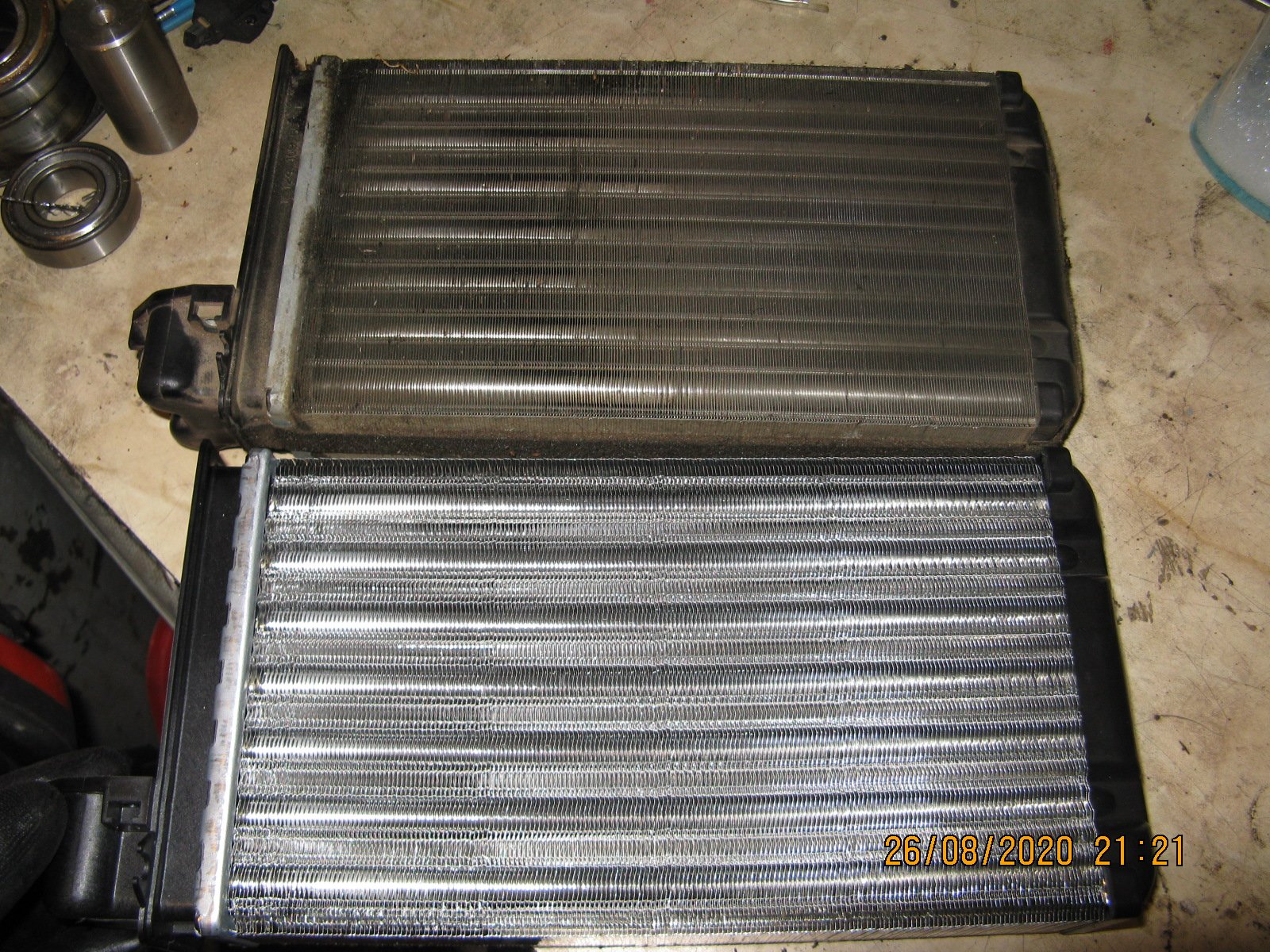

Further to this, I had to fit a heater radiator today, I  got an NRF one when I got the rads, just to see if they are any good, and I fitted that.

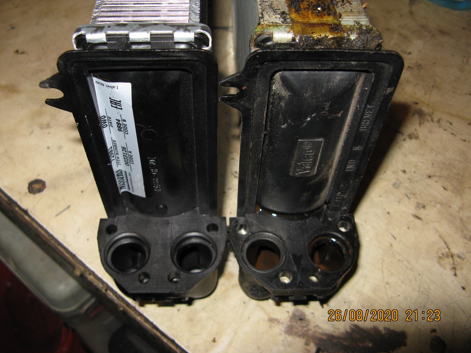

It fitted fine, It had new philips cum straight pan head screws, spring washers and screws supplied, they were rubbish and I re used the originals, but the square nut holding areas were a bit too shallow in the moulding so it needed a stroke of the file on one face of each original nut to get them far enough down in the recesses.

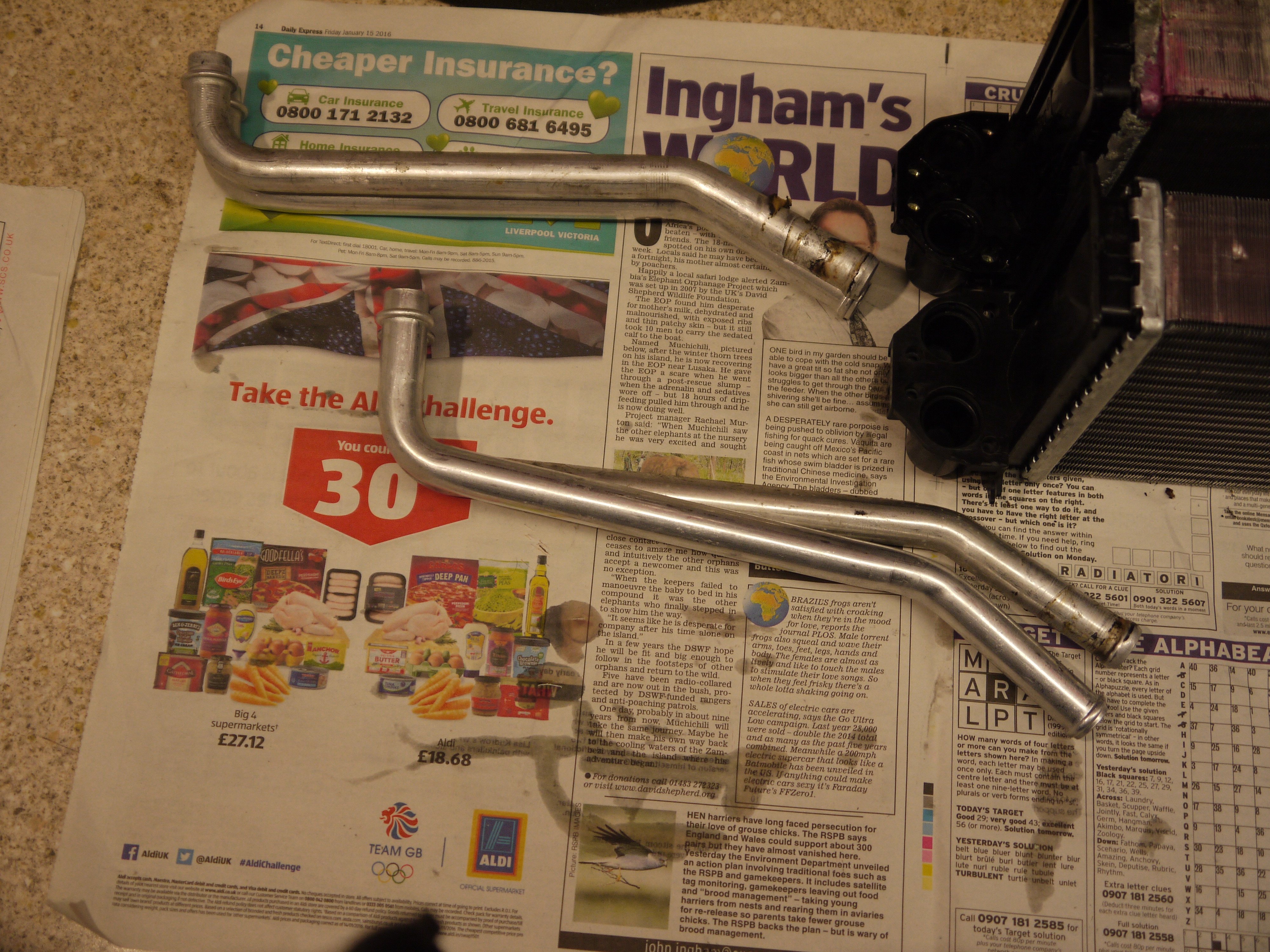

The shorter alloy pipe was fine, the longer was not right at the heater end , it wasnt quite 90 degrees, a touch of the pipe bender sorted that.
There was a bit of moulding flash in the screw holes that needed clearing and a little around the o ring / pipe holes that needed a quick shave with a stanley knife.
Overall a bit cheaply made but seems adequate and useable.

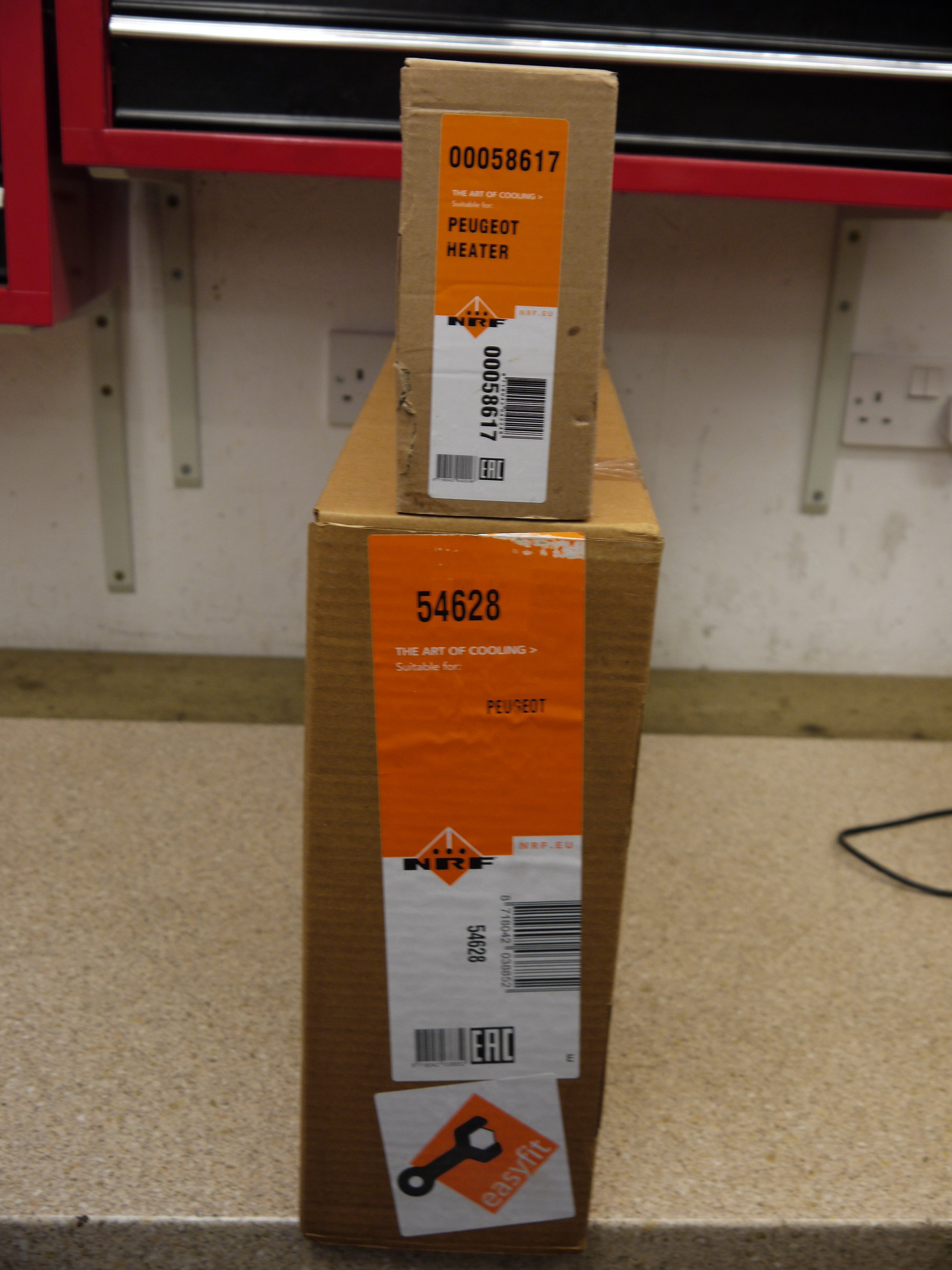

Its different to the current Nissens one in Your picture the plastic end tank moulding is not the same, so there are at least two factories somewhere making 205 heaters.
