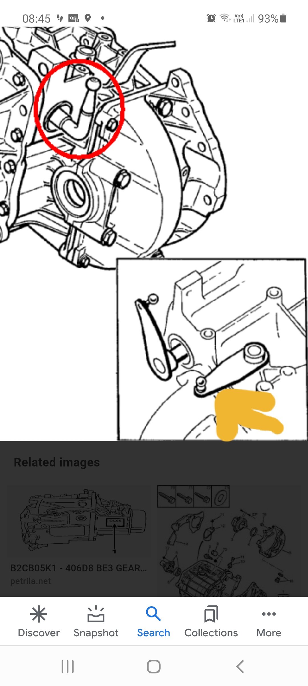

Hi, I have a BE3 box, its an Mi16 box with the appropriate arms to use on a 205.
I'm currently fitting a sachshift,  and can't seem to get the gears.
My question is: Is  the arm arrowed supposed to move both left and right? This arm seems to do the left and right on the gear stick, and I only seem to have travel to the left.

Yes its goes left and right:

Fantastic diagram,  thanks!
Any link on where thats from?
I can only get the purple arm to move one way, against a spring.

Thanks. Just took a look at the attachment.  I seem to be missing 5th and reverse,  so I assume that's a problem with the smaller 'flat' leaver only moving one way.
The box was working fine prior to me starting to fit the sachshift.  The kit comes with a new 'flat' leaver, which I fitted, maybe I've messed something up?

Did you drop the shaft whilst changing the 405 arms to 205 arms? If so, sorry, you’ll need to pull the box apart.

dont need to dismantle the box, just drop the arm down far enough to move across and engage in its rightful slot and pull it back up, a strong magnet will help.

At the moment the arm only travels towards the passenger side ( think), against a spring, this allows the gearstick to move towards the passenger side, as if to select 1st and 2nd.
So I need to drop the pin and turn it the opposite way to the direction it currently travels in?
SRDT
The lever ends with a fork and should catch a disc, if the disc is inside the fork then you can push and pull.
Right now the disc must be outside de fork so you can still push it but can't pull anything.
