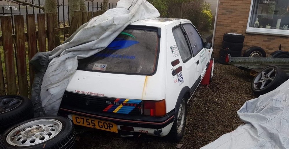

Been lurking for the last 2 years but never actually got round to starting any work on the 205 project I have until about 6 weeks ago, after searching through the forums for the last 6 weeks for info I thought it would be handy to start a thread for it so that I have all the info in one area if nothing else.
So I bought this in Dec2018 whilst I was away in Norway at my in laws who are Norwegian, I also sold a 1992 mini cooper so in that respect it was a fairly successful 2018 xmas break.
The car was a stage rally car from very early in its life as it did the 1989 and 1990 RAC and the original 205 challenge when it was run by Del Dowds in the hands of a guy called Andrew Nevitt. It had however passed through many hands and each time suffered a bit more neglected and abuse till it ended up with the guy I bought it from who had it sat under a sheet for the last 5 years.
I found it via a wanted ad on FB for a 1985 gti, we do historic HRCR rallies in my 1971 mini clubman but after doing a historic event that’s notoriously rough I decided I didn’t want to accelerate the killing of the mini so went looking for something historic compliant but more able to stand up to the abuse.
The guy I bought it off had been, in his own words, the end of Scotland to get it (and bear in mind he was in Glasgow to start with) and when he got there the guy he was buying it off had failed to mention to him that it had previously had a very light roll! From what he said he was less than impressed by this as I think he had travelled over 5hrs to get there.

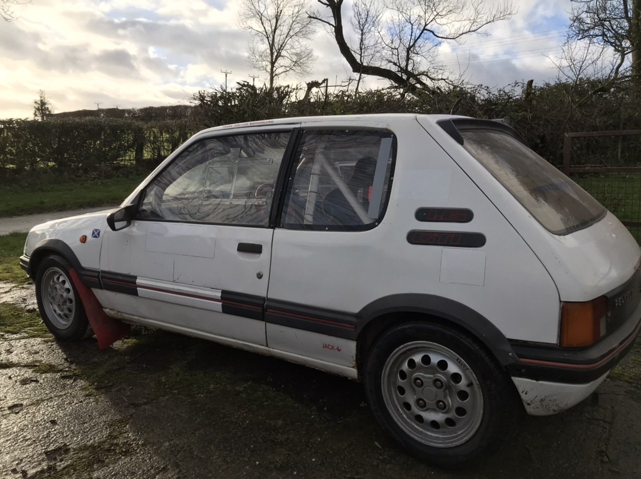

Anyway, I did know about the roll, and to be honest, wasn’t that bothered as the pillars etc are good and straight but there is filler on the roof as the roof skin is a mess at a guess, my magnet still sticks to it so it can’t be that bad.
The car has an SD roll cage and headlining in, so I cant see the roof skin from inside to understand how bad it is, but have been keeping my eye open for a roof skin local to me.
He was told that the engine was freshly rebuilt but was honest with me and said he had no evidence for this other than it looked like new with the block freshly painted and it sounded clean with no horrible noises. It had been used for single venue stage rallying at crail and ingliston by a Robert Prentice but last seen around 2007 and last MOT was Feb 2008.
The car is rock solid, not in terms of bodywork/condition, but very much so in terms of suspension! the only give is in the tyre sidewalls so I need to get the Gaz coil overs off it and something more suitable on it. I’ll send the rear beam (which I think is a 1.9 beam as its got discs on it) off to Andy Williams in the new year and then I’ll put it back on with a grp a solid mount kit. The rear has Tarmac bilsteins on it at the minute and 19mm TB
The car came with an abortion of seat mounting bars that I chopped out and chopped the std seat rail out also. My brother is a fabrication welder, so we chopped the tunnel and put some boxes into it to allow for the seat rails to be mounted to and allow for the seats to be sat lower.
That done the car then sat for about 18months, we had it running and the majority of the elecs were working but a combination of lack of time and money due to spending most of it on my real hobby of racing bikes meant I didn’t have surplus of either for the Peugeot.

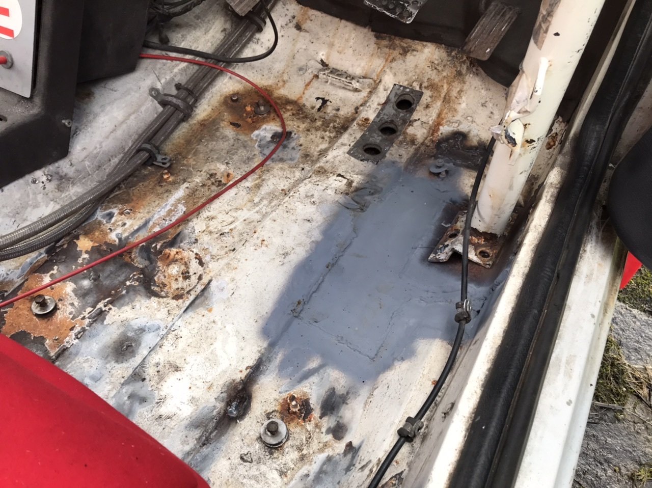

However about 6 weeks ago I started spending a day a weekend on it doing the FOC bits, namely, chopping out rust and replacing with steel.
The car had rot under the front cage feet as well as a couple bits in the footwells that needed attention so I have done the drivers side as well as putting in the required 3mm base plate for the cage feet. And hoping to have the passenger side done over xmas.

It looks worse than it is in terms of rust, the rear quarters inside behind the rear door cards are pretty clean and it’s only rusted around bits where fixings have been put onto the shell for the footplate and 2nd floor skins etc.
When welding the floor it all welds really nice the metal that is there is really good. When welding the mini it’s a lot trickier so this is pretty good for me.

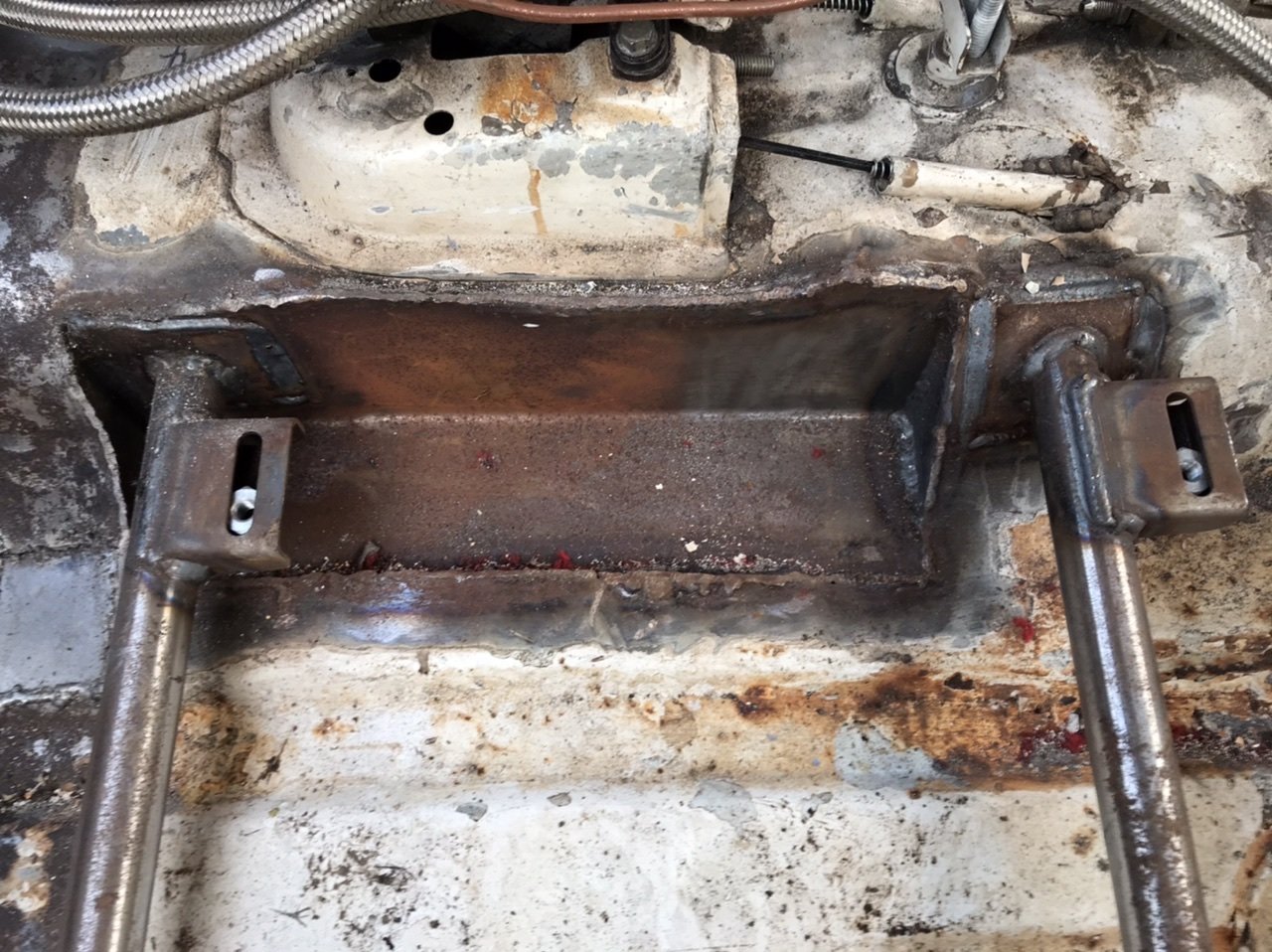

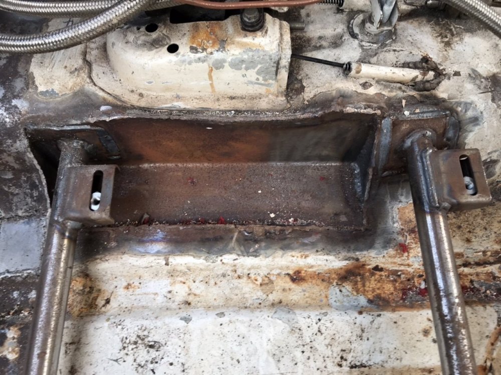

62EAD3E9-1353-4DD7-8F94-71487C72C6FD.jpeg.cda342027606571e2fa9541826731eba.jpegGet these fitted this weekend with some luck and the Gaz suspension off and sold. They are grp n with the tarmac insert and std springs which will do for now whilst I continue cutting out rot and replacing with fresh steel. Spent all of yesterday cutting out the passenger floor under the cage foot and replacing with fresh metal.
will need to put another 3mm plate under the cage foot and then refit the cage leg.

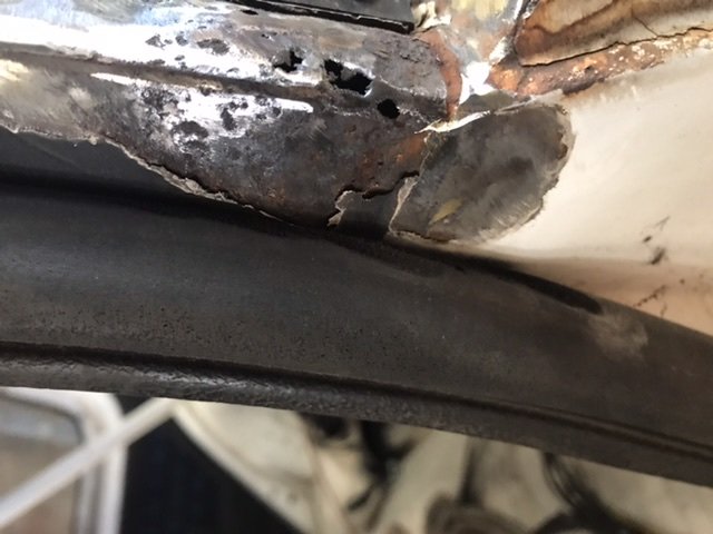

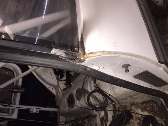

next big issue is the external skin of the b pillar which is pretty rotten at the base where it meets the rear quarter panel. If I could find a half decent shell I’d buy it for cuts and the roof skin. If not I’ll see how I get on fabricating the external skin of the b pillar but it may be one for my brother as he is a fabrication welder.

Been making steady progress managed to investigate the b pillar properly and its not as bad as I first feared, the steel is good and solid half an inch above where the corrosion is which is right at the base when the b pillar meets the rear quarter, and its only the external skin of the b pillar and not the structural internal element.
Id be happy enough patching this and then covering back up with paint and the b pillar trim, seen some people use blackboard film but also seen some kits on ebay. Are these any good or am I better getting black paint and putting plenty of layers onto it? Difficult to understand what the original application/covering is/was?

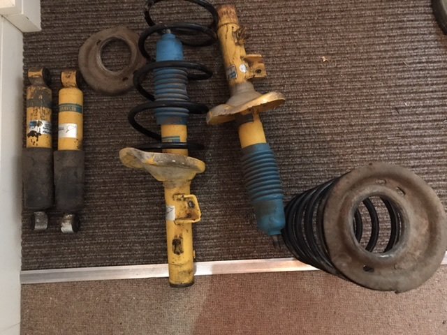

Suspension on the front is swapped over and on the grp n Bilstein struts, the ride height is way up compared to previous, it really exaggerates how low the rear is now so the beam off and some dummy shocks to make up to set it to the ride height stated in the grp n/challenge build manual is next up as well. Hoping the torsion bars aren’t too seized in place and don’t put up too much of a struggle though I am not holding my breath!

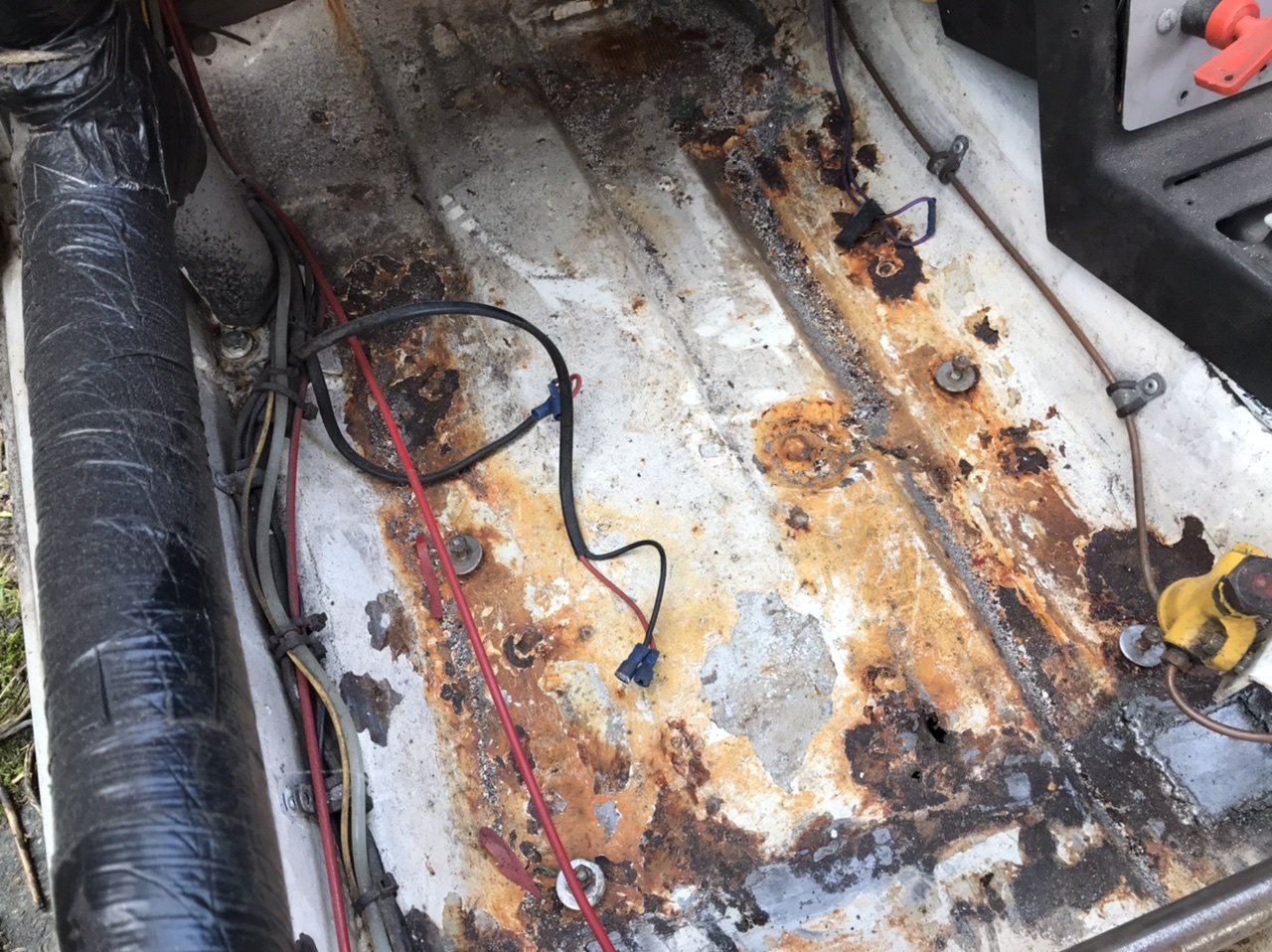

The floor on the passenger side is worse than I thought so has taken a bit more cutting out and fabricating than I thought it was going to, and as a result I ran out of welding gas to complete it last weekend so need to get that finished off and sprayed in primer so that I can get the cage mounting points marked up and drilled through and then bolt the cage back in fully.

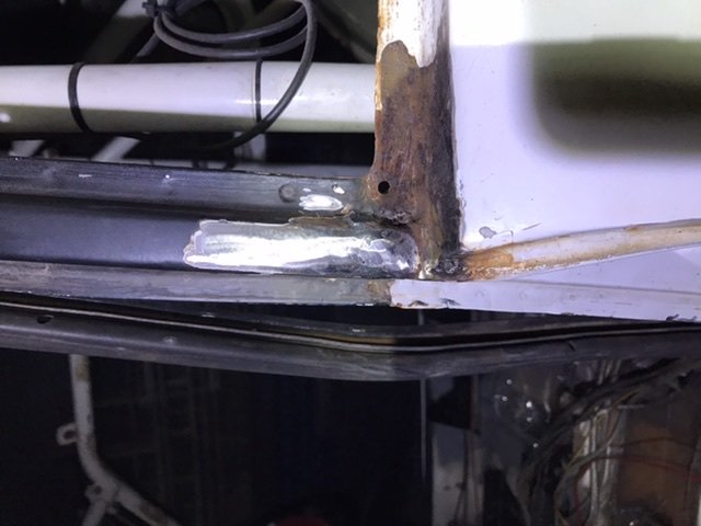

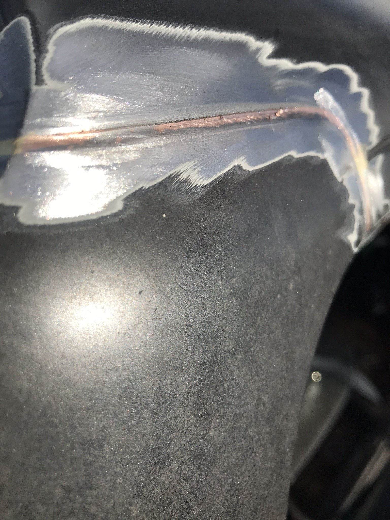

Got a couple hours today so had a look at the b pillar. Managed to clean it back and build it up with a very smaller filler patch and weld.
went from this
to this

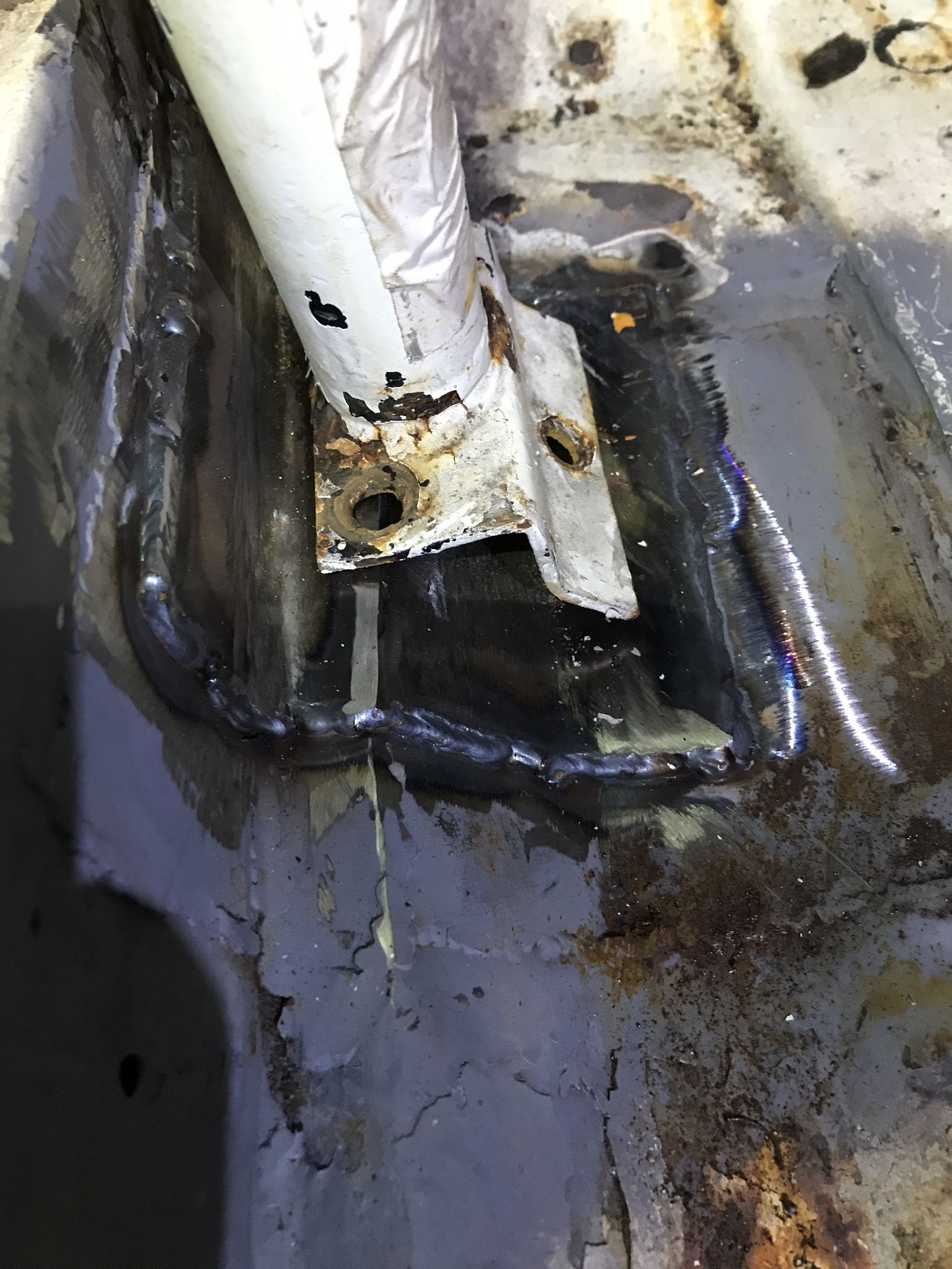

Cage foot welded in and holes marked for the bolts, nearly gave myself a belter of a black eye getting the cage out after marking the holes, it got a little snagged so I gave it a tug and it all came free with a bit more of a rush than I thought. And stopped about 5mm short of my face.
i also had to weld up up a number of small holes and cut out a couple other small areas and patch back, car floor has taken quite a kicking but it’s been a rally car since 1988 at lease so in truth it’s pretty staggering that’s it’s still here.

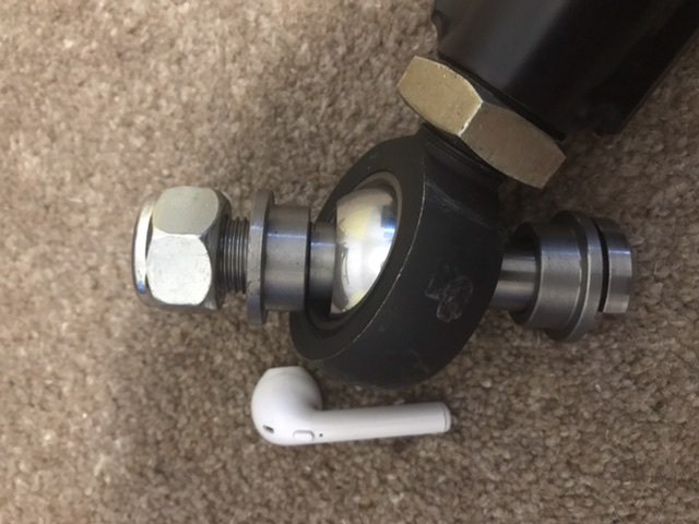

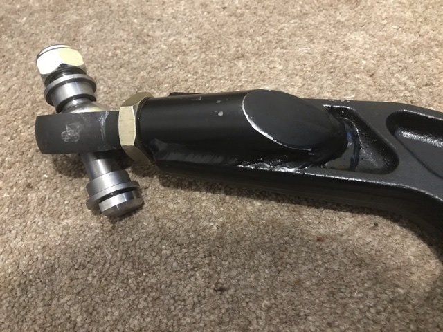

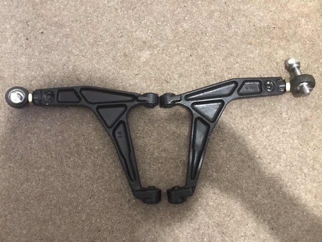

These turned up today, I may be very sad but I can’t stop looking at them, workmanship is top quality. Come with fresh bushes rod ends and drop pins. Reasonably excited to actually put some nice new parts on it rather than just cutting out rust and welding in fresh metal.

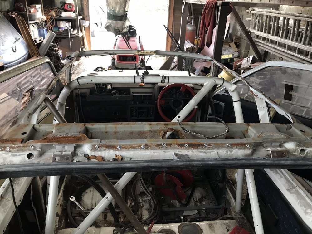

Have sorted finally a rolling shell to cannibalise for the roof, also need a rear quarter off it as the rear drivers quarter has taken a bartering on mine and has lots of filler in it.
struggling at the minute to break the brazed joints without trashing either panel, I need to keep the rear quarters intact and obviously the roof also, any advice on how to split the brazed joints.
I tried to v this one out with a poly strip disc which has worked but I still can’t split the joint without trashing the rear quarter. Can I heat them and sweat them off or will I just warp the steel?
28hodge
not had loads of time and as the other 205 i have is in the garage at home and this one is away elsewhere ive not had the same time to get much done on it.
However i did get the roof all trimmed and ready to mark the spot weld positions so i can grind them back and weld it on.
