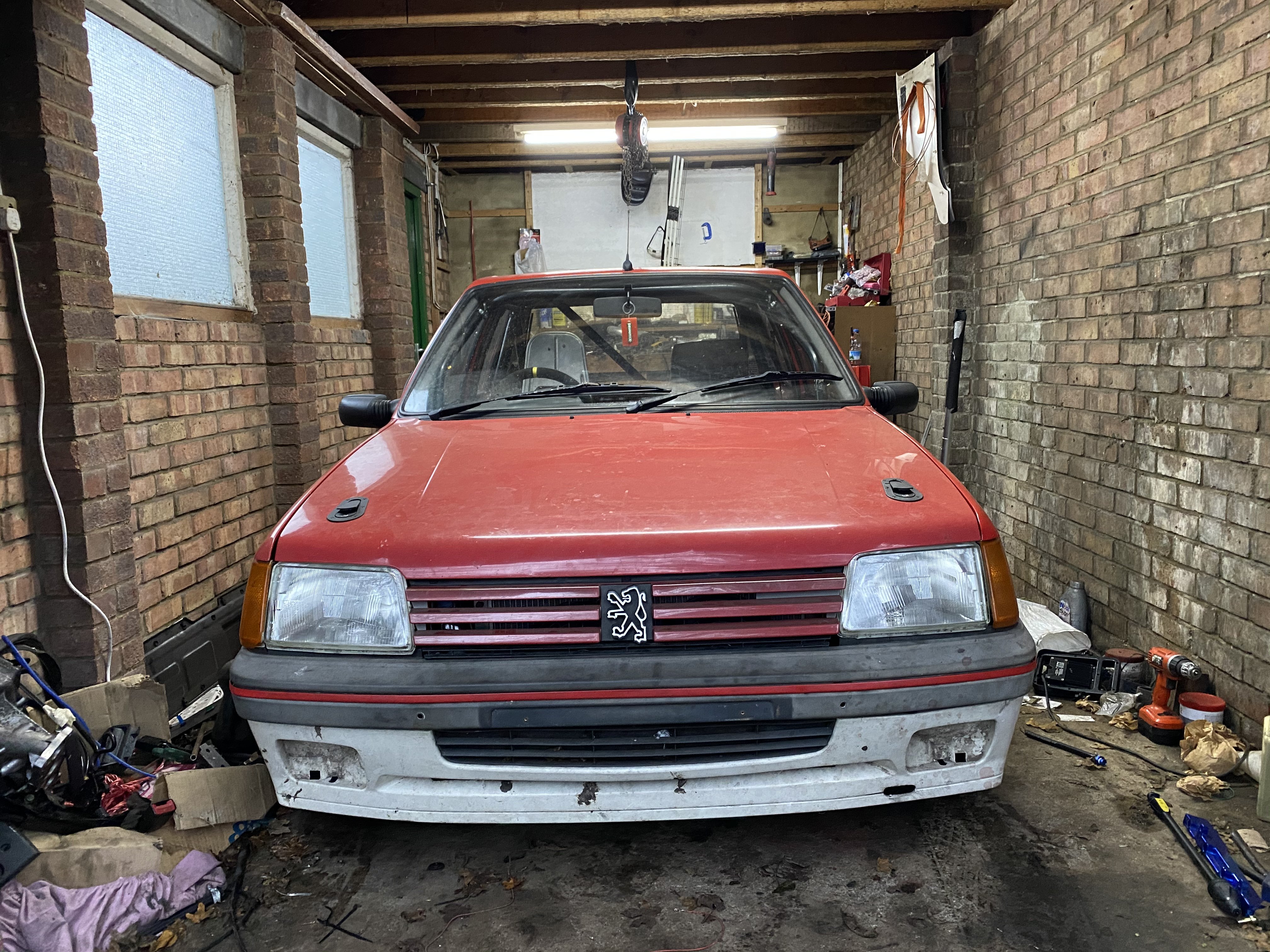

K20205 5 Posted December 17, 2020 1 hour ago, welshpug said: sounds like the contacts in the motor need cleaning up and the wiper arms are going too low because the arm on the motor is in the wrong place, as well as the wiper arms on the spindles too low. I have a spare motor ill give that a go and see if it sorts the cutting out and pause between switching, i repositioned the arms so that i doesn't touch the scuttle panel but now when its resting its too high. what did you mean by the spindles too low? Are they the ones with two 10mm nuts? Can you adjust them? this is how they rest now without touching the Panel. Share this post Link to post Share on other sites

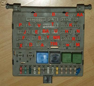

K20205 5 Posted December 17, 2020 1 hour ago, welshpug said: there's two places to adjust, firstly the resting position of the arm on the motor, aand lastly the wiper arms themselves. Will try that mate, thanks alot.. also one question? Would the wipers work if there was no relay in the fusebox? which one is the relay for the wipers? Share this post Link to post Share on other sites

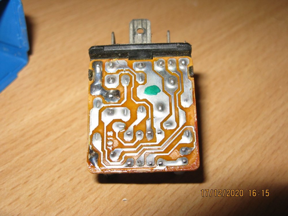

DamirGTI 323 Posted December 17, 2020 (edited) Check the wiper motor linkages too , especially upper ones on which the actual wiper arms bolt on these tend to rust on the inside (metal rods inside black plastic housing) , give everything good clean up and apply some grease on all the moving areas . Greasing the mechanism often makes wonders on the wiper performance . Check the motor earth as well , as it's under the scuttle panel near the motor exposed to environment/moisture it also often rusts creating poor ground connection .. unbolt the earth terminal clean up free from rust , bolt back on protect with some paint on top or apply some vaseline over the terminal for the moisture protection . Blue relay is for the wipers , remove it and pop the plastic cover off and inspect the relay internals , who knows something might've burnt out inside , relay coil switch contacts might need cleanup (best with diamond file and wash off with contact cleaner) , or it might be problem with cold solder joint which will be simple fix (use magnifier glass to check cracked solder joints) . D Edited December 17, 2020 by DamirGTI Share this post Link to post Share on other sites
K20205 5 Posted December 17, 2020 I think my fusebox has a blank where the wiper relay goes into.? the car is a 1.1xl, well the wiring is, engine is k20. does the 1.1s use relay for wipers? Share this post Link to post Share on other sites
SRDT 146 Posted December 17, 2020 It's a bypass, the relay is just for intermittent wipers. Share this post Link to post Share on other sites
