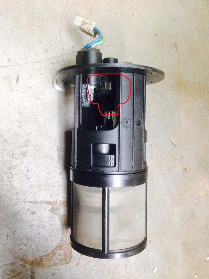

205ash 9 1 Cars Posted December 12, 2020 Hi all, I have an issue with the rubber part that fits between the OEM fuel pump and the housing itself which is split meaning the car down on fuel pressure as the fuel is leaking back into the tank (part outlined below) Are there any other models which share the same housing as the 205 GTI or models with different housings but can still be used in the 205 GTI tank? I am struggling to source a 2nd hand 205 GTI one and I don't want to be paying silly money for a whole new unit when it is just the small rubber part which has failed, I will probably be upgrading the pump itself while its out anyway. Share this post Link to post Share on other sites

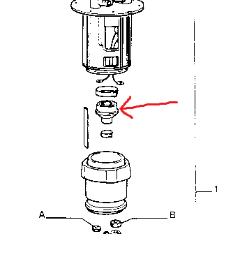

PhilNW 67 Posted December 13, 2020 (edited) Would have thought you would be able to replace the pipe with a short section of injection rated rubber fuel pipe. You will need to get the pump out of the housing. Looks like the earlier pump from the photo http://www.miamistu.co.uk/pug/GB/205F/1/14L50A.HTM Edited December 13, 2020 by PhilNW Share this post Link to post Share on other sites
welshpug 1,737 Posted December 13, 2020 its not a straight piece of hose, the housing end is lots bigger than the pump itself. Share this post Link to post Share on other sites
205ash 9 1 Cars Posted December 14, 2020 as Welshpug said, its not a straight hose annoyingly, its this piece in the diagram: Share this post Link to post Share on other sites
Gohn 73 Posted December 14, 2020 I've taken out a couple of the later version fuel pumps from the 1.6l petrol 205's maybe that's an option ? you could probably get a whole unit (housing and pump) from a car in a breakers yard. may need to check fitment is same early v later versions but the elec plug and pipes look the same and the flat top and screw holes look the same too Share this post Link to post Share on other sites
