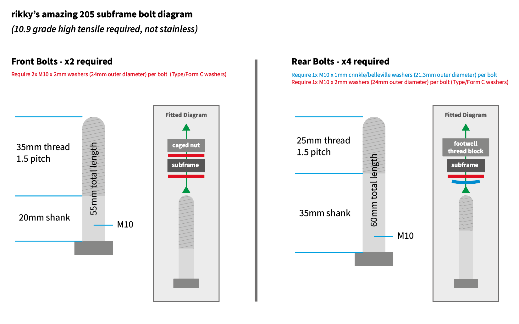

(Also trying to decipher the washer positioning from Servicebox. I've made a diagram that took me way too long and unsure why, but maybe this will help others. Hopefully it's right. Looks like you have 2x washers on the rear bolts, different sizes, to spread load, before it goes through the subframe.)

I've revised the diagram to show the proper washer fitments and sizes, hopefully this makes sense to others following it now. This is a side view of how the bolts pass through the subframe into the body.
The M10 (highlighted red) washers are Form C washers, with a thicker outside diameter than normal washers. They are M10 with an outside diameter of 24mm.
The M10 (highlighted blue) washers are smaller outer diameter (approx 21.3mm) Crinkle/Belleville style arched washers, to help prevent loosening under vibration.
Original bolts are 10.9 grade for the 6x subframe bolts, visible on the end of the bolt if you clean it up, unlike a lot of other 8.8 grade suspension bolts.
Note: Peugeot's diagrams show an M10 washer before and after the subframe on the front x2 bolts (on my diagram), but people have reported not seeing the one above the subframe on their cars.
