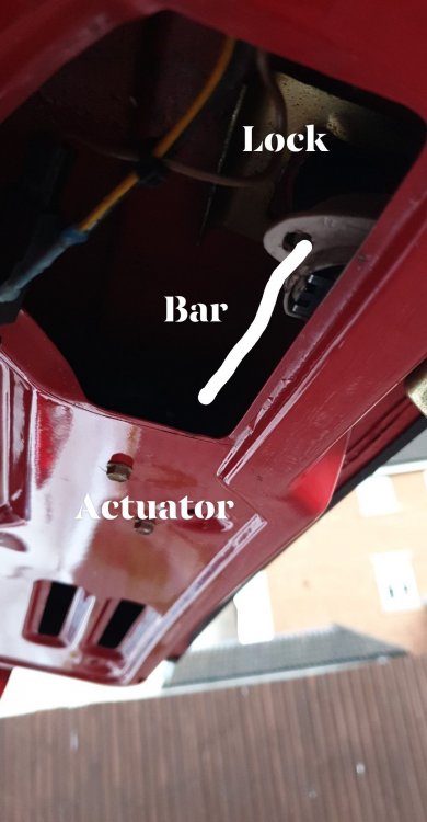

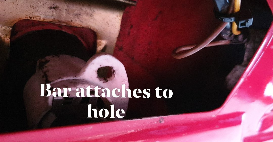

Telf 238 2 Cars Posted November 10, 2020 Steeples, Heres the pics of my boot lock You can see the actuator, lock and the bar is missing. You can see the fitted positions. The bar connects the lock mechanism (the plastic bit) to the actuator. Hope this helps Share this post Link to post Share on other sites

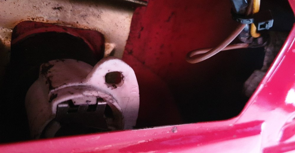

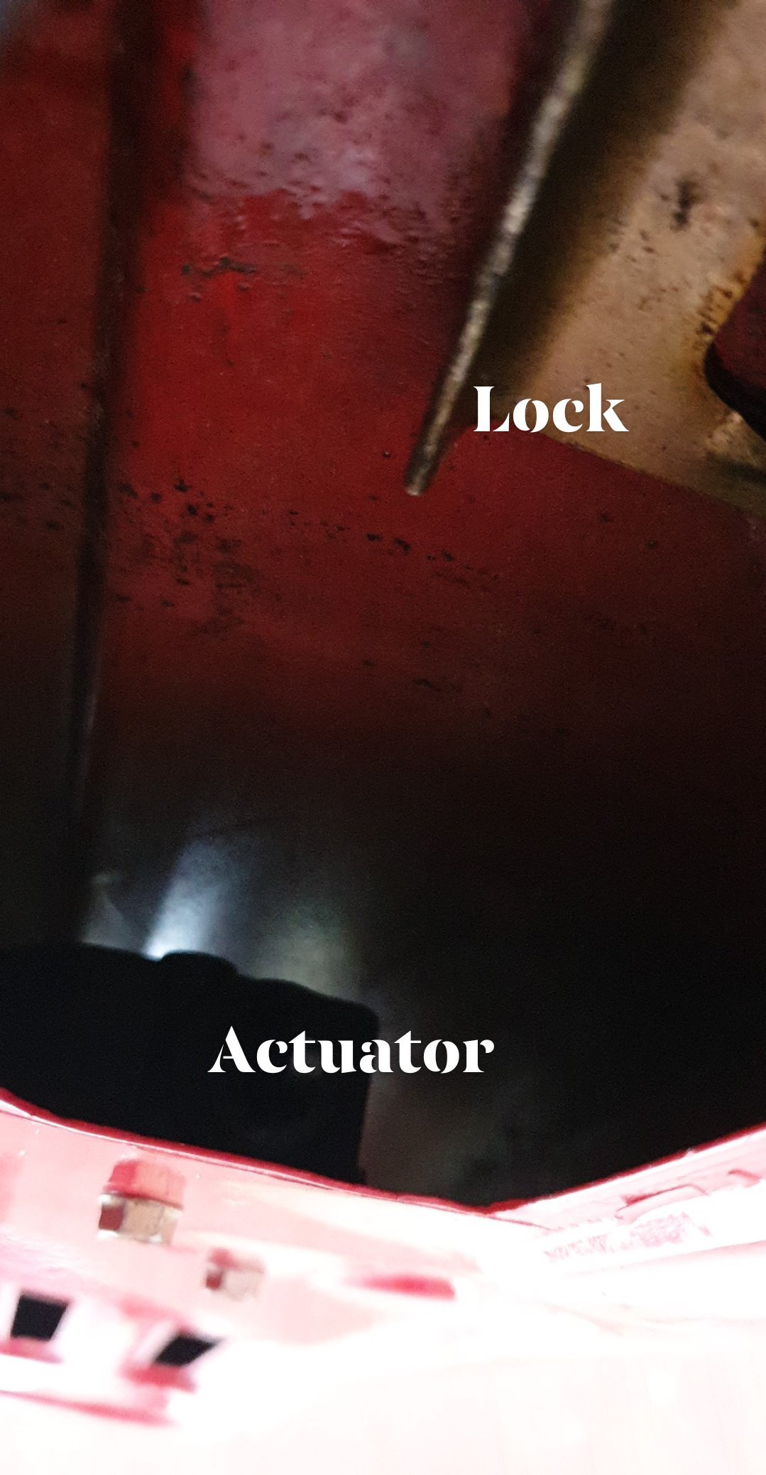

stepples 2 Posted November 10, 2020 Thanks Telf, just been to look at mine and this is what I have left! You can see where they have put a wire through to pull to open the lock! Share this post Link to post Share on other sites
Telf 238 2 Cars Posted November 10, 2020 Having trouble getting my head round that. Looks like it needs replacing. I think I've got a spare lock mechanism knocking around. Share this post Link to post Share on other sites
stepples 2 Posted November 10, 2020 It looks to me like I have this bit and the metal wire attached to the bit sticking out of the top Share this post Link to post Share on other sites
stepples 2 Posted November 10, 2020 However I don't have this plastic bit that I think I can see in your photos and not idea how to fit it without the actual lock Share this post Link to post Share on other sites

Telf 238 2 Cars Posted November 11, 2020 The plastic bit rotates and pushes the bar to lock and unlock the mechanism. Really basic design Share this post Link to post Share on other sites
