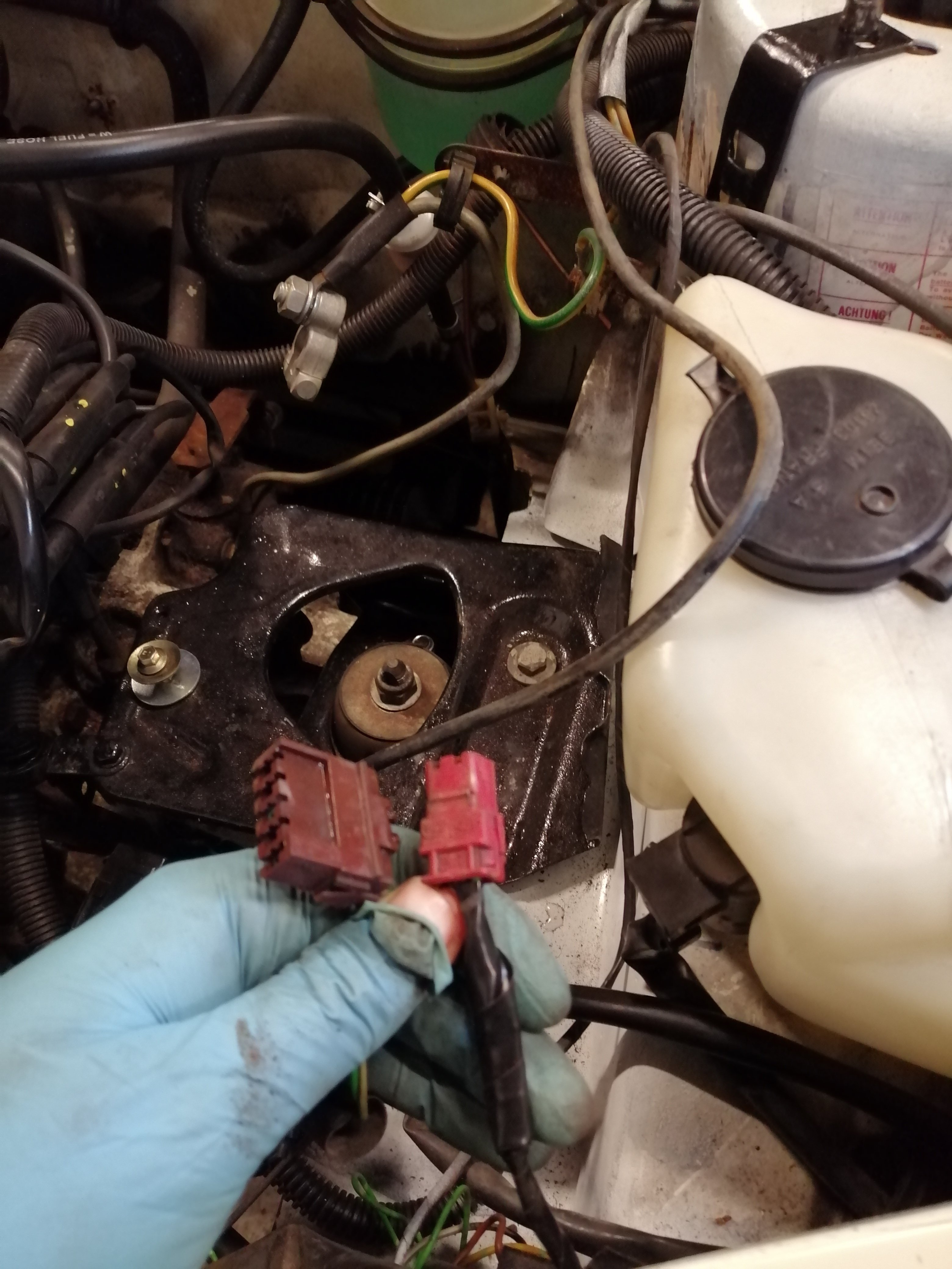

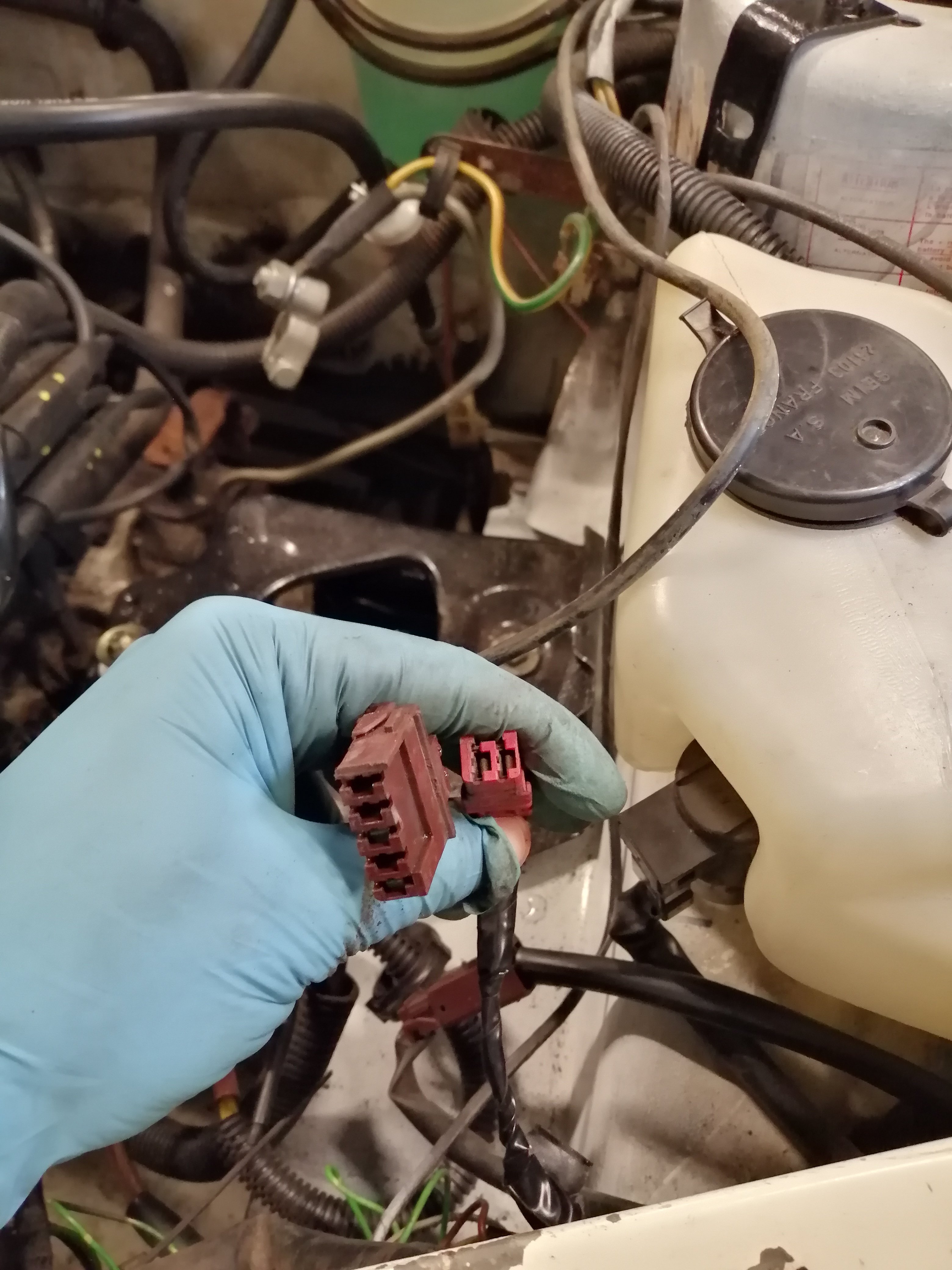

Junior1 0 Posted October 1, 2020 Anyone know what these 2 plugs are off? 954cc engine loom Share this post Link to post Share on other sites
pug_ham 239 3 Cars Posted October 1, 2020 Easy, brown one should have three wires to it, middle & two outer pins & its from the cooling fan loom as a test connector, if you bridge the middle pin to either side the fans should run at either high or low speed. The small red one is for the later TD cooling fan relay box set up. Both are left loose & not connected to anything on your car. g Share this post Link to post Share on other sites
Junior1 0 Posted October 1, 2020 2 hours ago, pug_ham said: Easy, brown one should have three wires to it, middle & two outer pins & its from the cooling fan loom as a test connector, if you bridge the middle pin to either side the fans should run at either high or low speed. The small red one is for the later TD cooling fan relay box set up. Both are left loose & not connected to anything on your car. g Cheers!! Had a bit of a panic there!! Share this post Link to post Share on other sites
