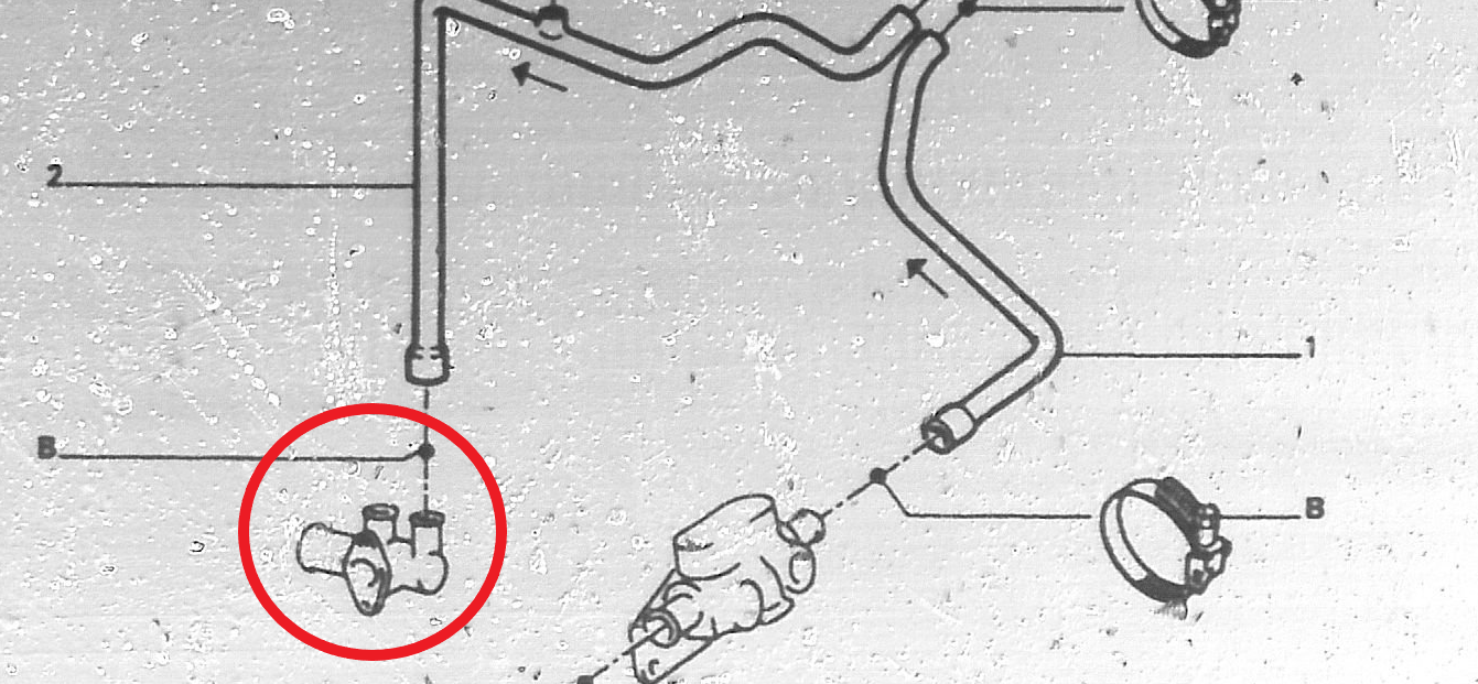

Have had a perpetual small drip coming from the point where the pipe from the hearter matrix connects to the rear of the block... 2 x new rubber pipes and various clips haven't changed things.
Possibility the metal casting is at fault, maybe cracked / corroded for exanmple as it appears to be the original and made of aluminium.
Will hopefully find out for sure in the coming weeks when the car's up on a ramp, as access otherwise is very restricted
In the mean time... does the part highlighted have a recognised name? Found several images of it on servicebox, but none that I can find specifically reference it.
If one is needed would like a head start trying to source it.
Thanks.
That'd be the rear/bottom water distribution block.

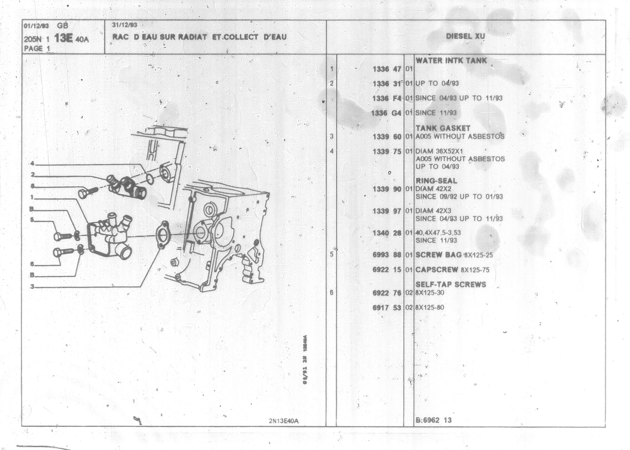

officially the Water Intake Tank
the pic's for the XU diesel but its shows the plastic version with the flat sealing ring and the metal version with its papery gasket
and the various part numbers

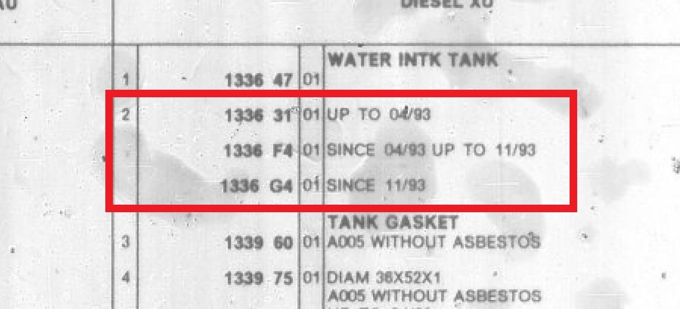

Gohn's capture of a servicebox page has high lighted something else for me... just want to check my way of reading / understanding how Peugeot list parts on it is correct?
Sticking with the water intake tank part numbers as an example and bearing in mind his diagram seems to be dated 31/12/1993 -
1336.31 would be the original part number used up to 04/93
That was superceded by 1336 F4 and that ran from 04/93 to 11/93
That in turn was replaced by 1336 G4 commencing on 11/93 and is correct for the time Gohns diagram was published.
Presumably in this example any of them are suitable?
Yes, that's how I understand it works as well, all of those part numbers should fit in place of each other.

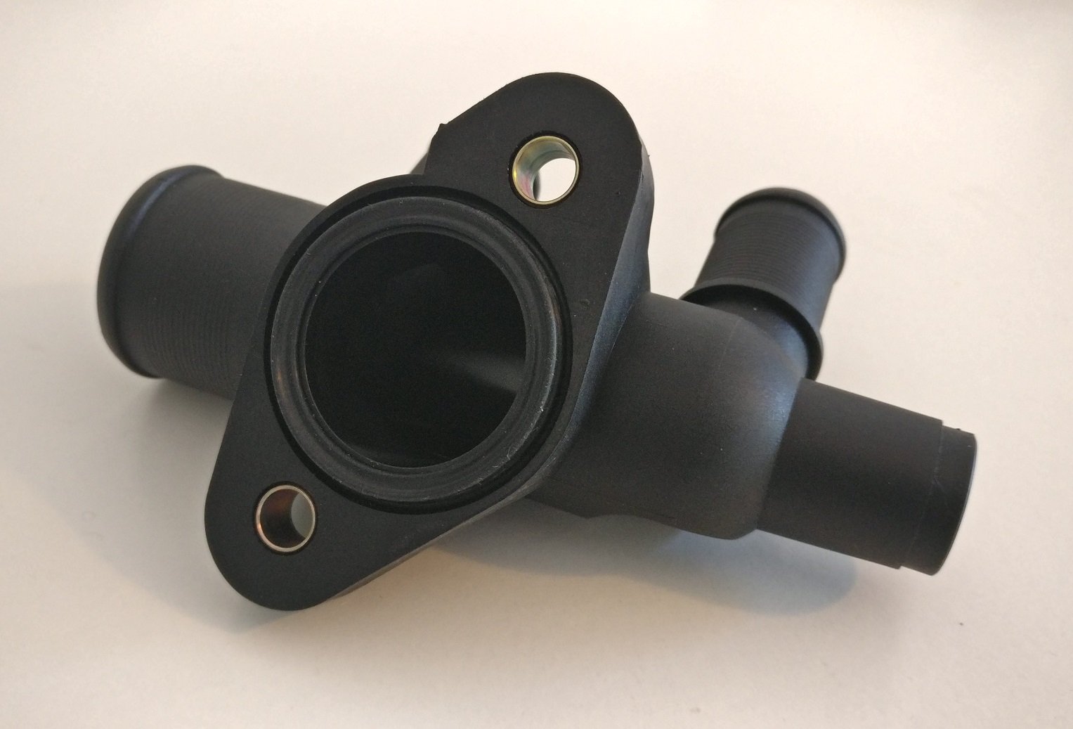

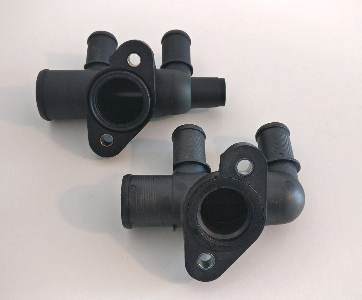

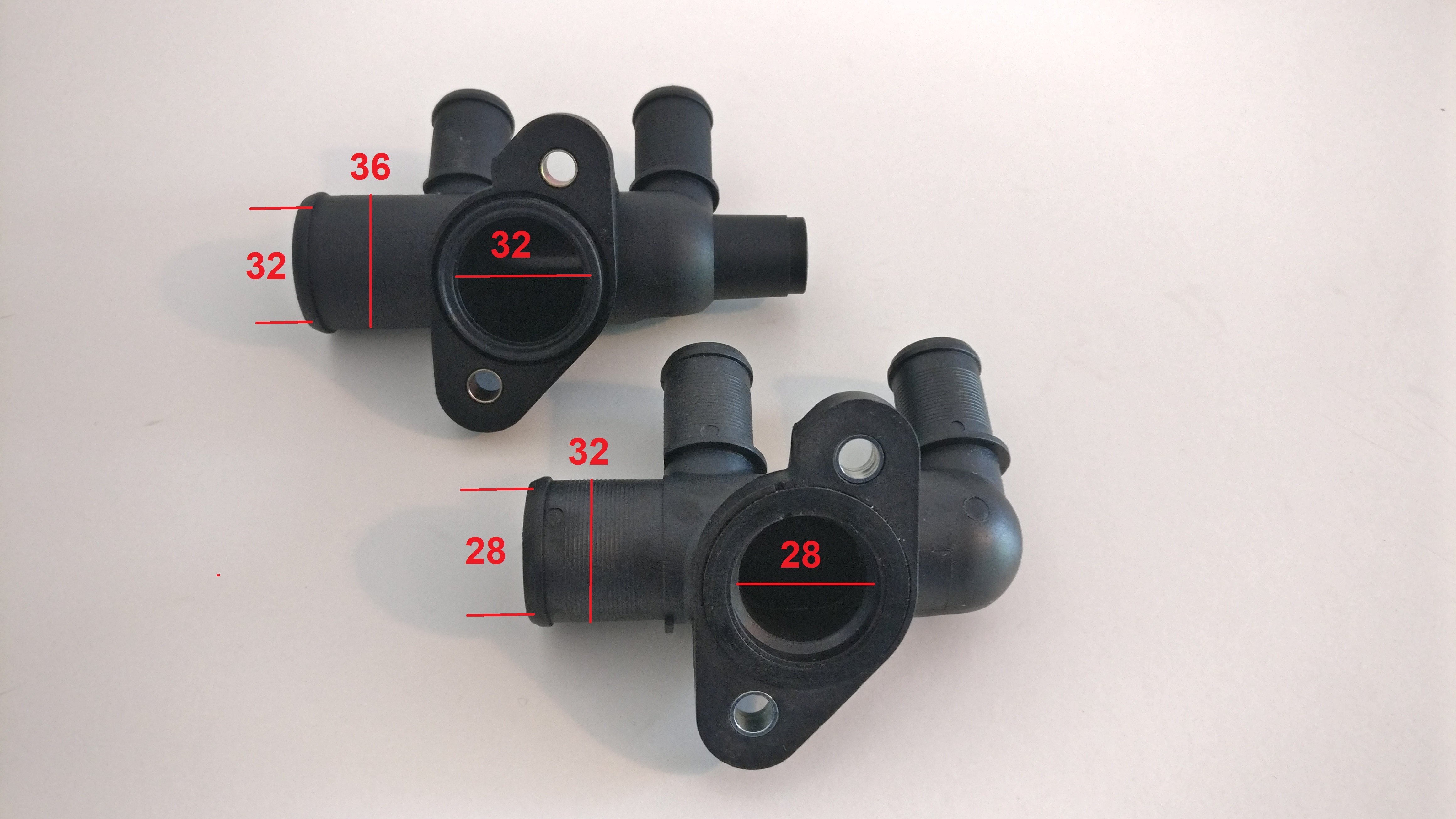

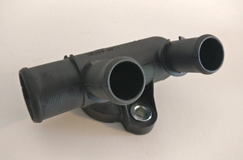

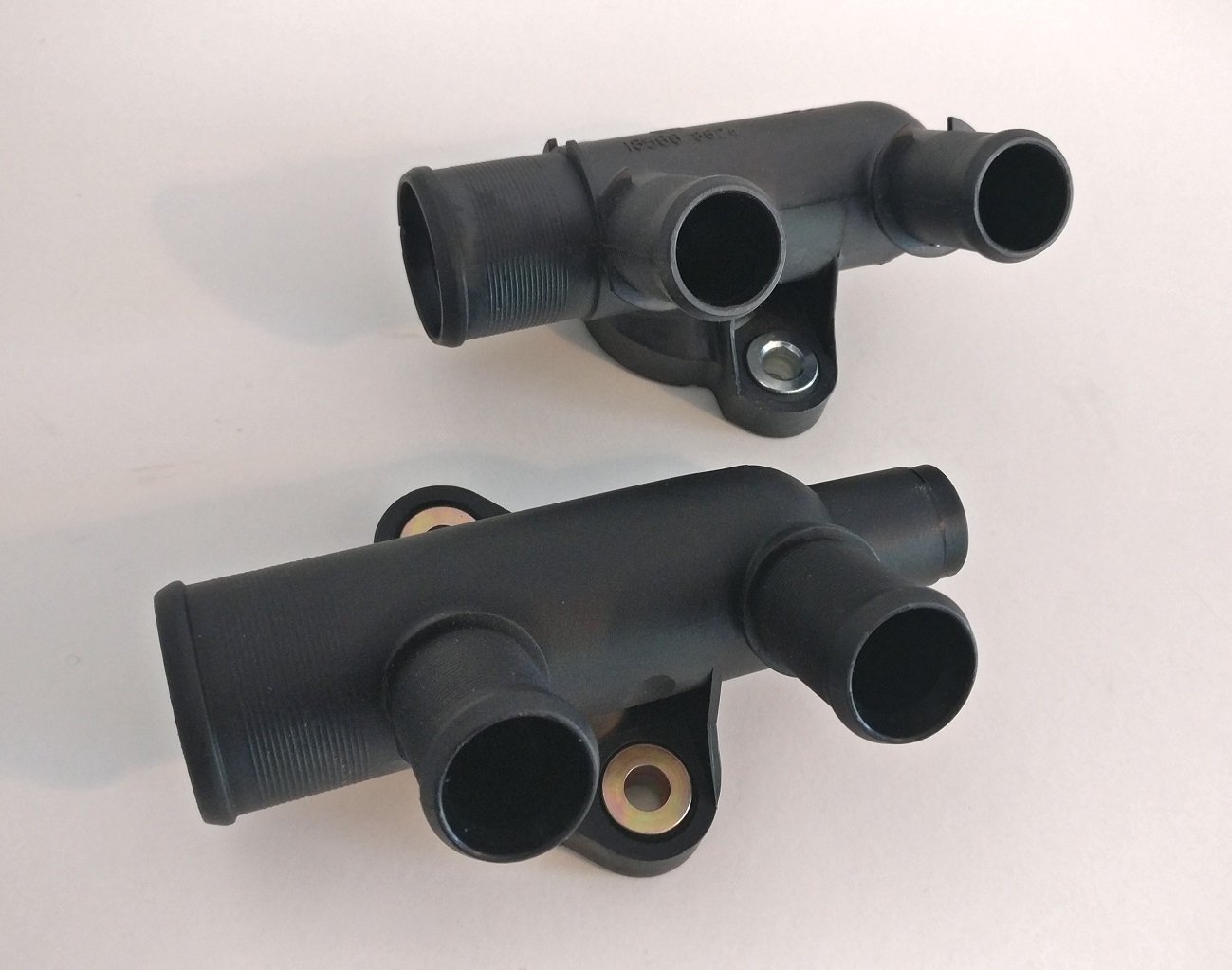

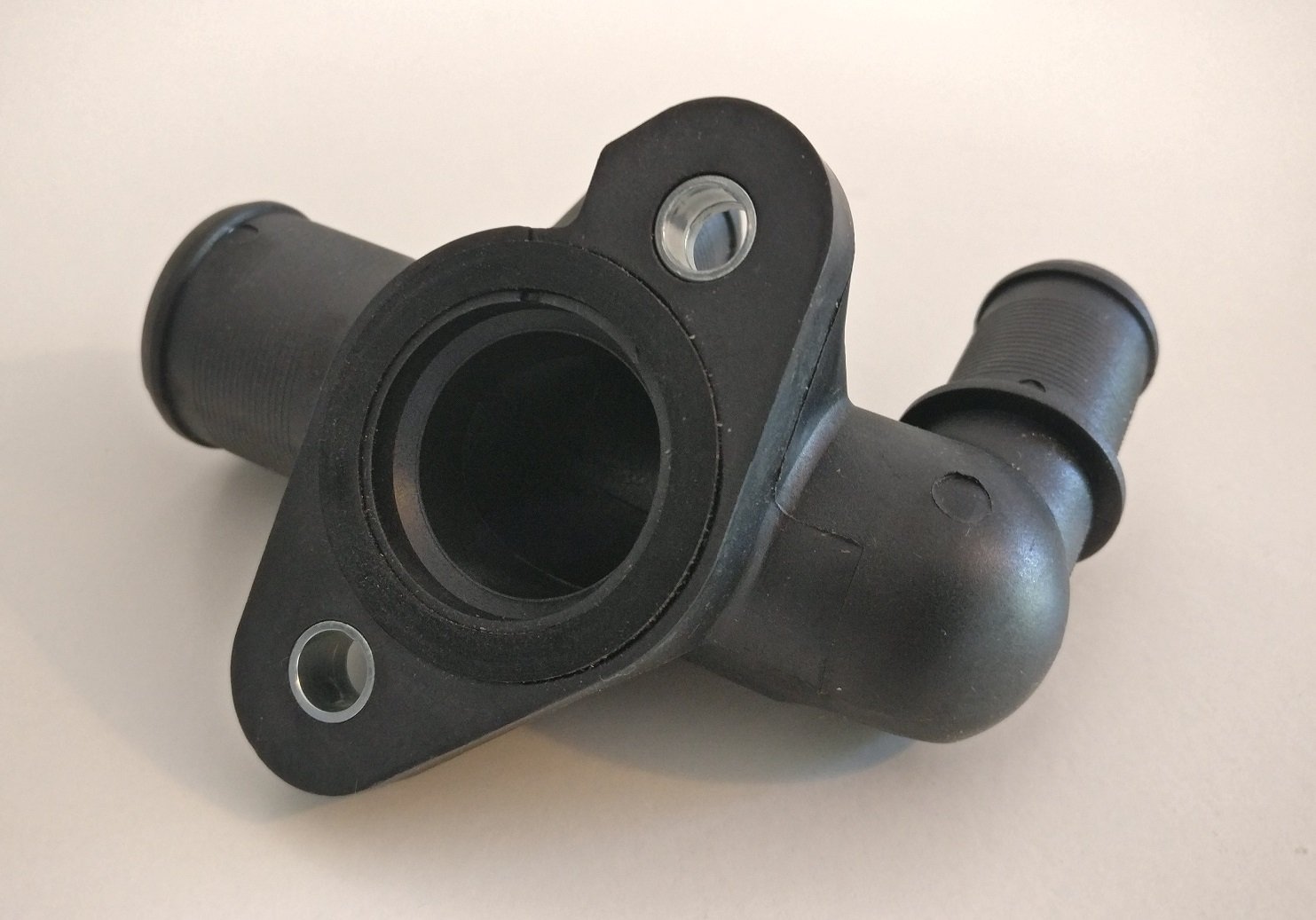

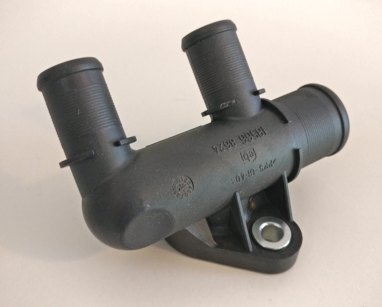

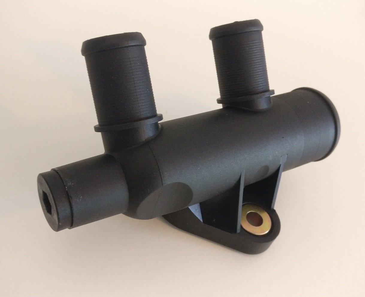

bacardincoke
Found a genuine Peugeot 1336.60 (plastic) for not too much and went for that... could only find used metal ones and all seemed as well worn as that being replaced.
1336.H7's (non-Peugeot) are cheap enough so got one to compare both suitability and quality.
You can see from the measurements on one of the images there are differences in diameter for the main pipe / openings.... The 2 x smaller ones are identical on both.
All other dimensions are also identical so if the main pipe differences aren't an issue they should be intechangable,
The most obvious difference is the absence of the hex plug extension / drain plug of the older style on the new.
Presumably that was designed out as the tank evolved for whatever reason and isn't essential.
Quality wise the original Peugeot 1336.60 is quite a few notches up from the later 1336.H7 versions, Febi in this case.
The Febi's sounds ceramic and brittle... feels very light and not as well cast, there's already a chip out of it straight from the box. Even the ring seal is cheap feeling, the whole thing just doesn't inspire confidence.
So there you have it... both seem to be suitable, but if you can get a metal one, brilliant, otherwise a good second is the proper Peugeot plastic version. The current non Peugoet ones seem to be cheap for a reason.
