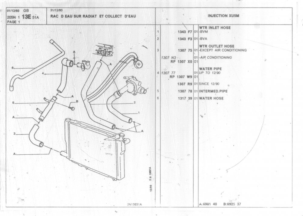

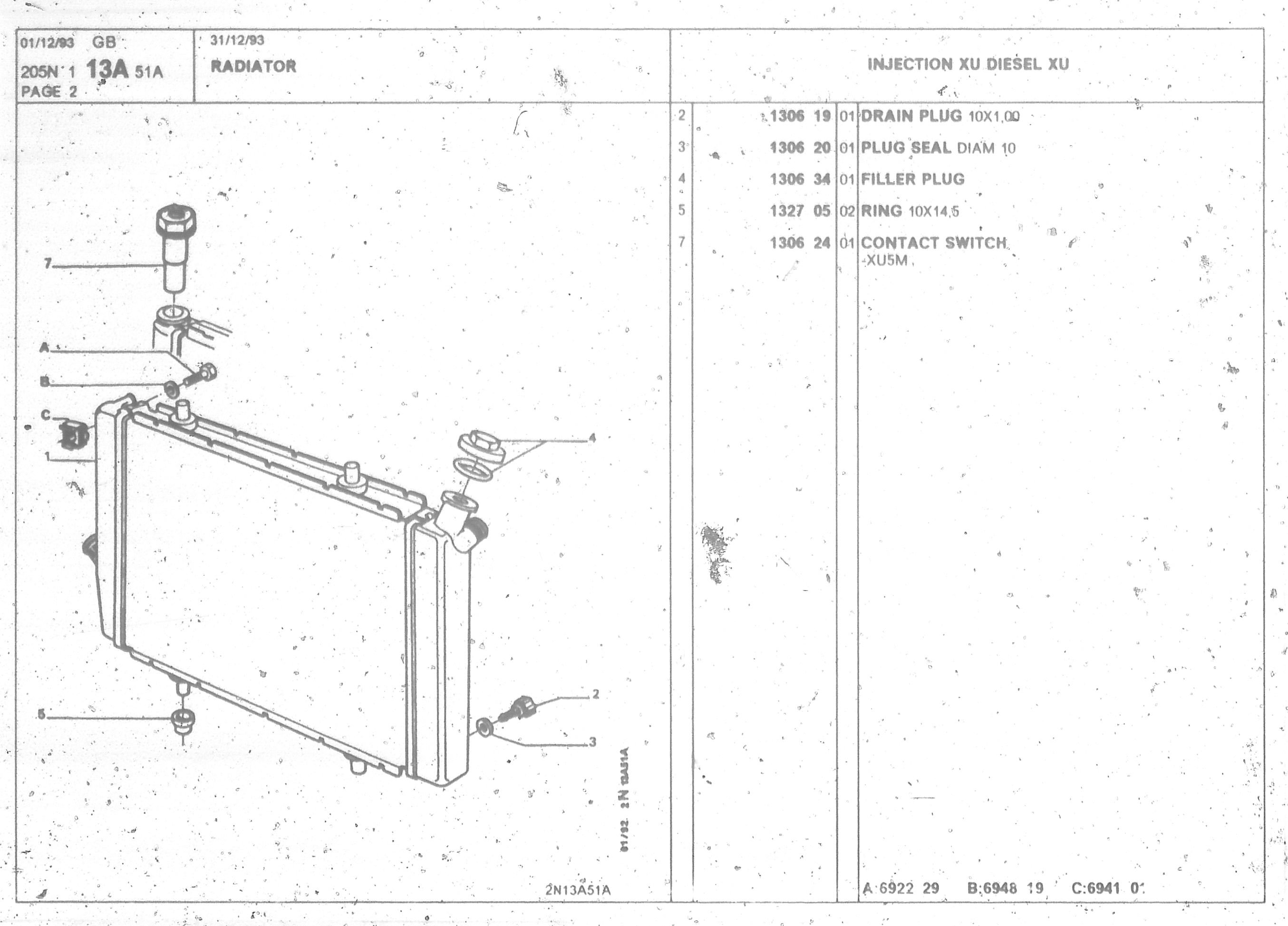

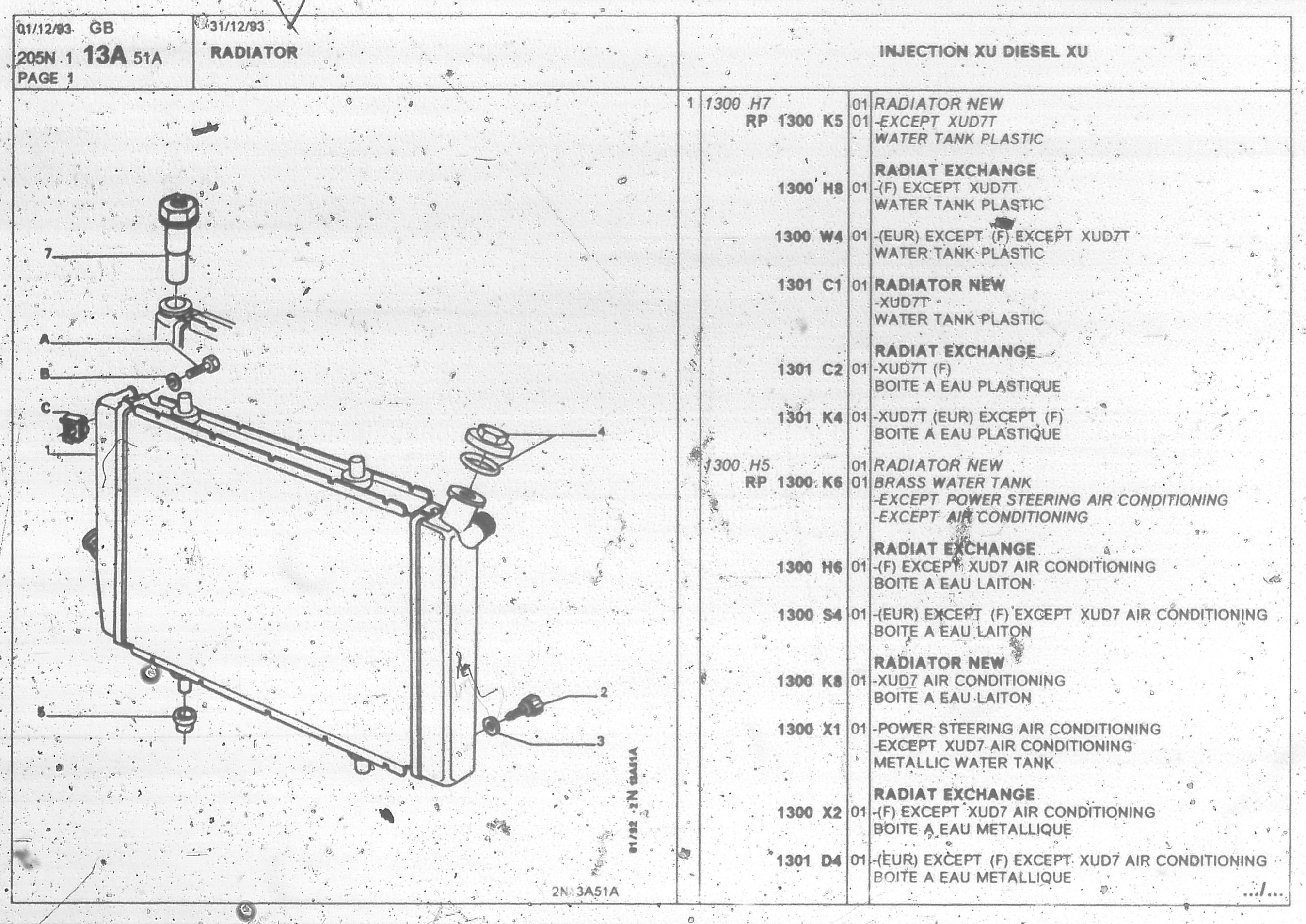

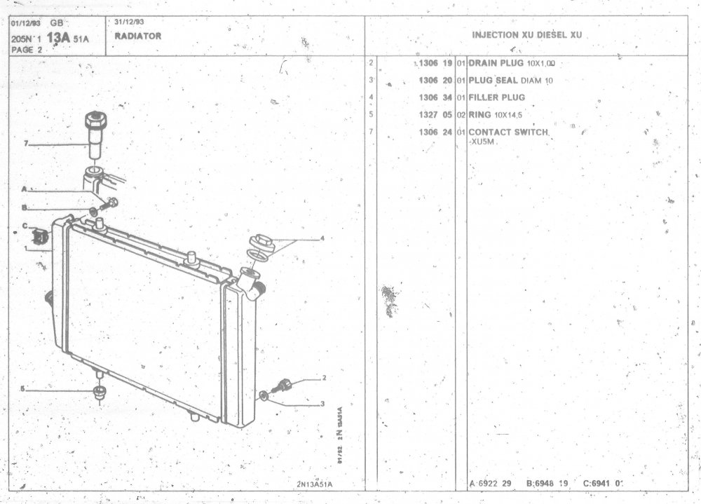

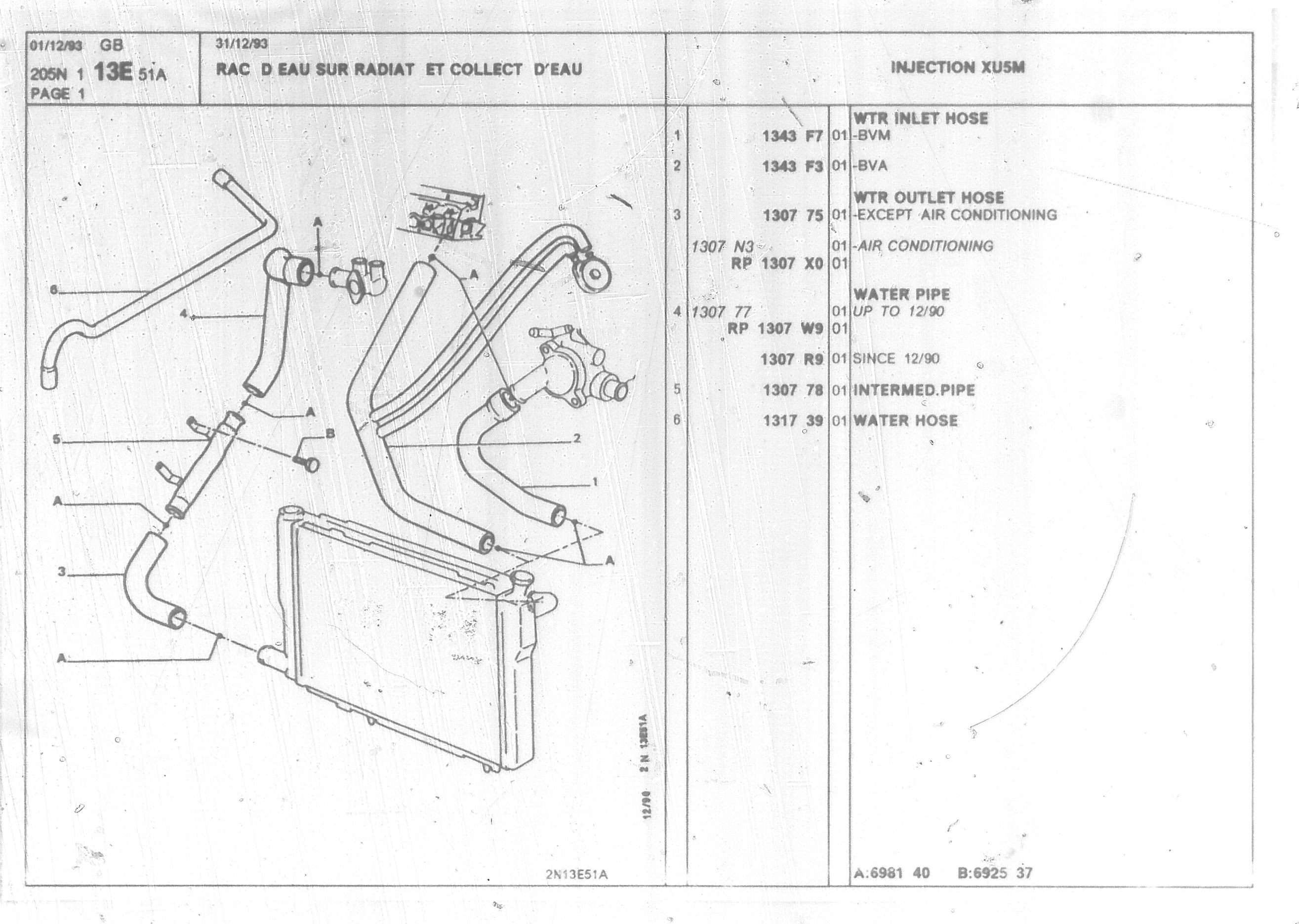

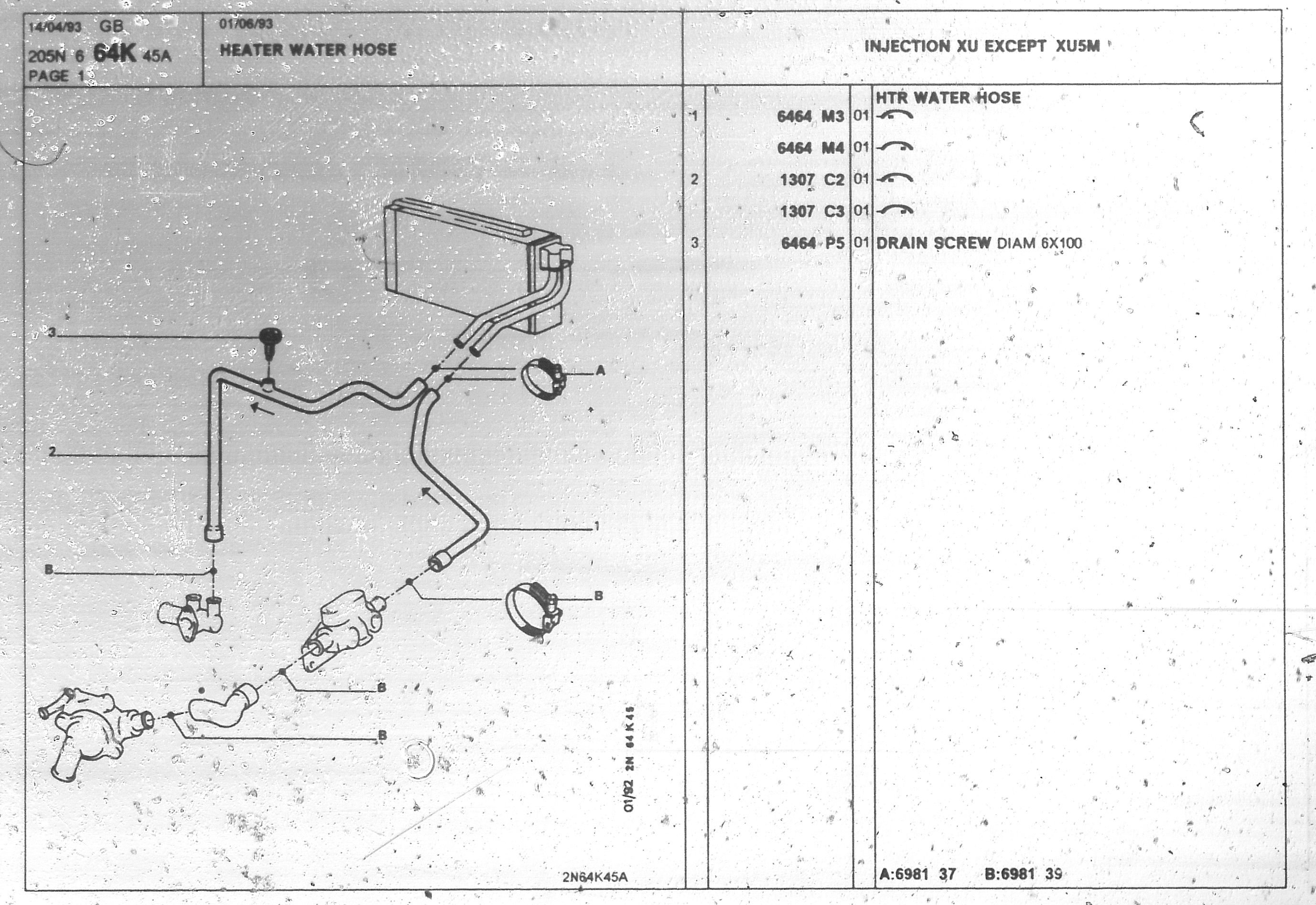

Gohn
had the same problems for ages
I bought an old official microfiche 205 parts catalogue
don't have a microfiche machine and wanted it all easy to use from my computer
so I spent days at a public library scanning each page one at a time to USB
part numbers, schematics, references, dimensions etc
on occasion, deep in the refurb mire I've referred to it a dozen times a day
I've contacted the forum moderators to try to upload it so all of 205-kind can access it free as many times as they like, like me
hopefully very soon a friendly (non google) upload option will be organised and I'll be able to send it all in
until then, I've attached anything that could help, the XU5M pic is not the GTi 1.9 which is XU9 but I've put it in just in case it helps
also, I still find interpreting some things difficult
the ones I scanned are from 1993 which apparently includes previous models superceded numbers etc
  • Thanks 1
