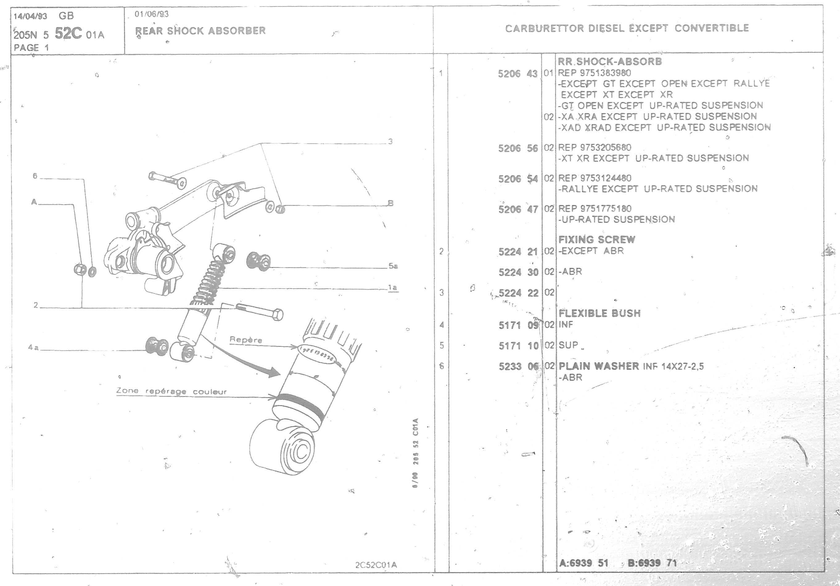

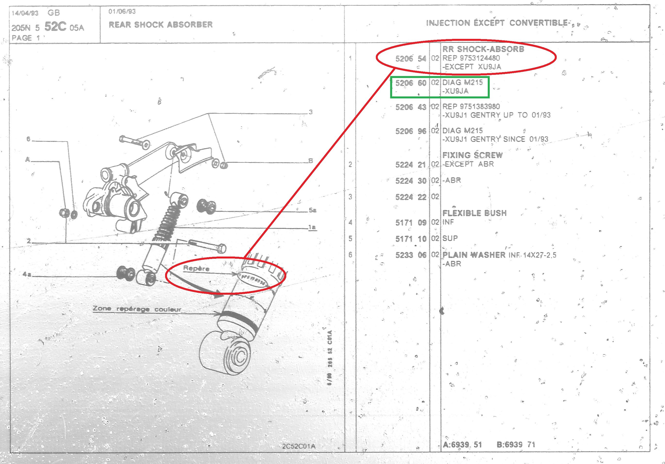

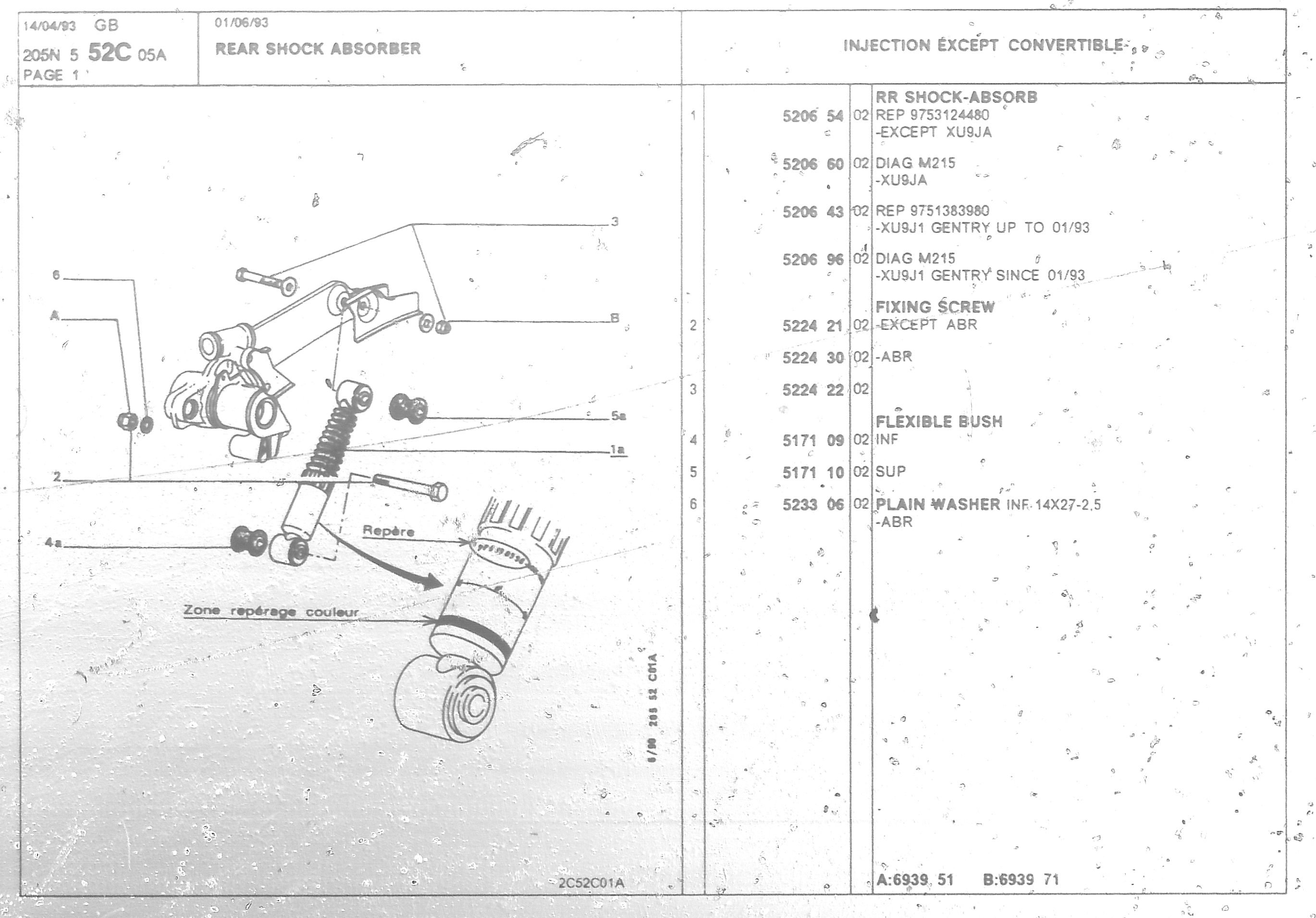

its a bit confusing but here are the two catalogue pages I have that relate to the rear shocker
there's way more version's listed than I thought were used on the different models but that's just my ignorance probly
the "REP" followed by a number may refer to the VIN so everything after that VIN is suitable for that part number ??
In the Reference page of the catalogue REP is translated to MARK so its still a bit unclear, to me anyway ...

Just guessing... maybe that 'rep' number refers to the number stamped on the damper itself.
The service box page I could see didn't have a 5206.54 listed at all, I think it was dated 1990, whereas yours seem to be 1993.
Again just a guess saying as the 'fat body' shocks mentioned seem to be for GTI's - would 'Dia' be diameter and 'G' for grande?
Perhaps 'M215' refers to a significant measurement they have, again just speculating.
Originals presumably have coloured bands as that's also highlighted in the schematics.
Colour coded for ease of identification maybe? If so woild be interesting to know what colour refers to what spec.
Your second scan seems to answer my question regardless and specifically excludes 5206.54 as suitable for XU9JA cars.
