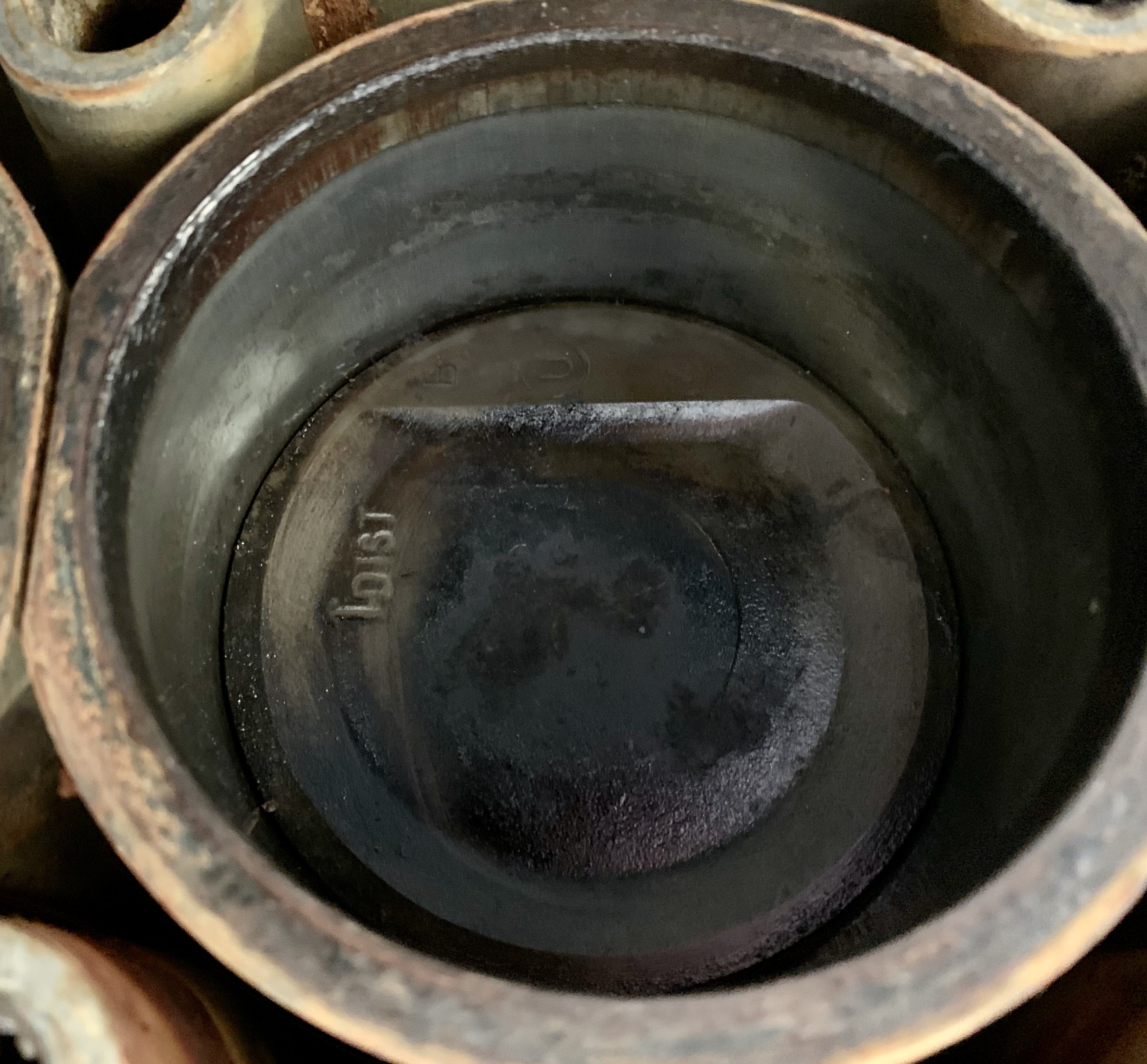

1991sorrento205 0 Posted September 14, 2020 Thanks for that. The head is off and good job I did. The previous owner didn’t clean off the surfaces of the old gasket and slapped the new one on. The head was only torqued down to 1st stage so that explains the oil pissing out that side of the head . I’m now Doubting the whole engine. I have an arrow on each piston with DIST next to it. I’m praying that has no consequence and that doesn’t mean they should be the other way pointing to the distributor! Share this post Link to post Share on other sites
Tom Fenton 1,650 Posted September 14, 2020 Dist points to cambelt end. Share this post Link to post Share on other sites
1991sorrento205 0 Posted September 14, 2020 Phew! Had a panic on for a second. Head gasket set, timing belt kit, Water pump, thermostat all coming tomorrow so all being well it should sound a lot healthier by Wednesday. Fingers crossed. Share this post Link to post Share on other sites

Andy 105 1 Cars Posted September 21, 2020 Err, ‘dist’ means distribution , referring to the camshaft drive. So the arrows on the top of the piston should point away from the distributor and towards the camshaft drive. If incorrect, this would not cause your non starting issue but will give other longer term mechanical problems as the pistons have an offset built in to the gudgeon pin centre line . Share this post Link to post Share on other sites
1991sorrento205 0 Posted September 21, 2020 Thankyou that’s a relief as the head is back on already. Anyone know what the voltage should be to the injectors? There’s fuel pressure up to the rail but I am now suspecting whether the injectors are opening Share this post Link to post Share on other sites
