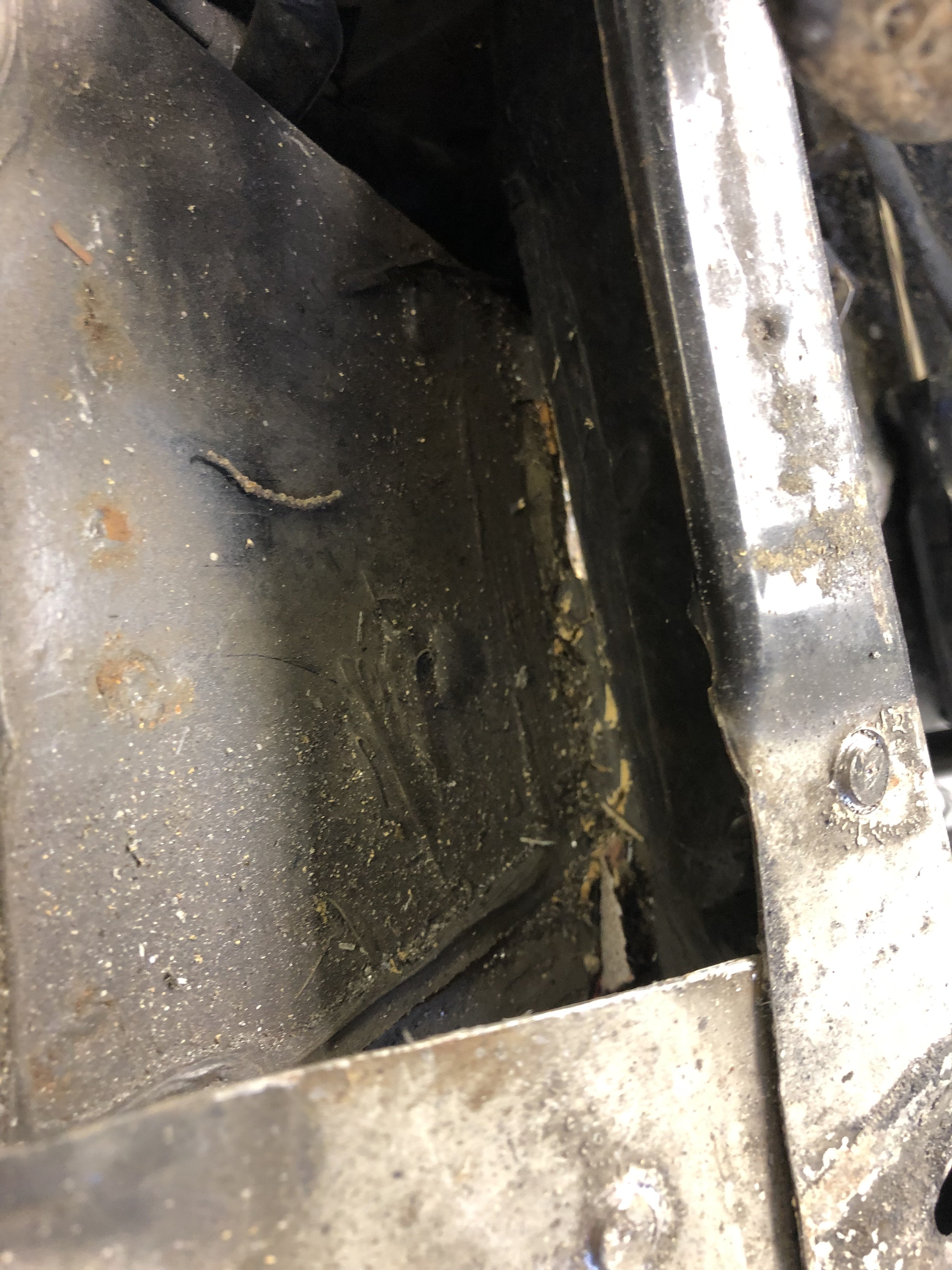

Connor 1 Posted August 31, 2020 Hi Everyone, Well after my GT filling with about three inches of water back in February, and me running the car with no interior since then, my parents have had enough and want their back room free of old car parts. I've sorted out the leaking rear window seals, but the big one seems to be coming from somewhere above where the steering column goes through the bulkhead, since the foam that remains in the car around there is always wet. The front passenger footwell is always dry, but the driver and the rear right footwell regularly gets soaked. I've ran the hose over the car a few times now and never manage to get any water to enter the car. The two channels just behind the front wheel arches seem to run free too. Anyone know of any spots worth checking before I take the whole dash out? Cheers Connor Share this post Link to post Share on other sites
Telf 222 2 Cars Posted August 31, 2020 My leaked from the scuttle panel. Search for it and see the corrosion I found Share this post Link to post Share on other sites

nixonmi16 4 Posted September 2, 2020 Check the seam sealer from the strut top mount to the bulkhead/scuttle panel Share this post Link to post Share on other sites
Telf 222 2 Cars Posted September 7, 2020 yep peel that sealant off - mine had tiny holes beneath it Share this post Link to post Share on other sites
