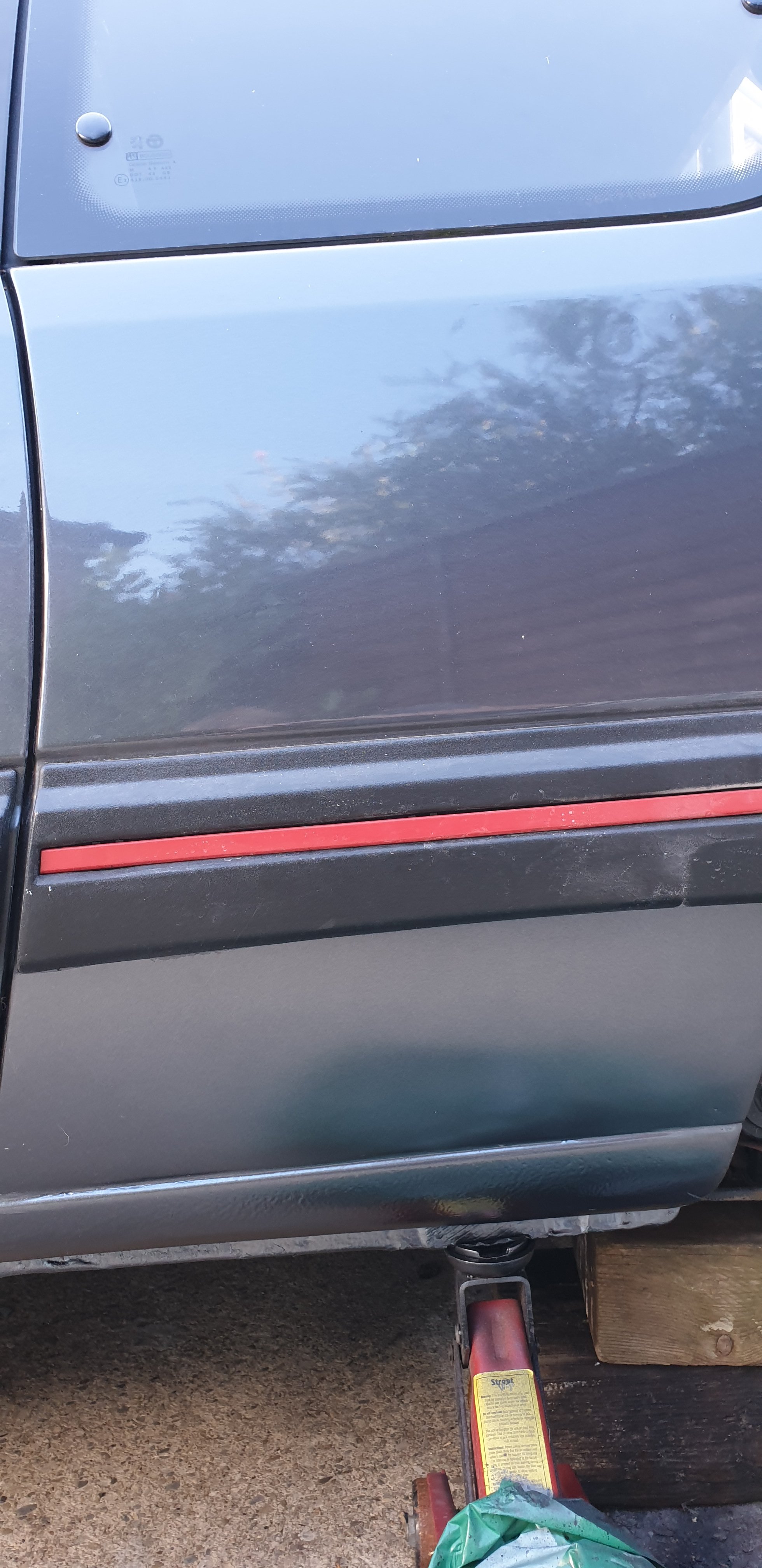

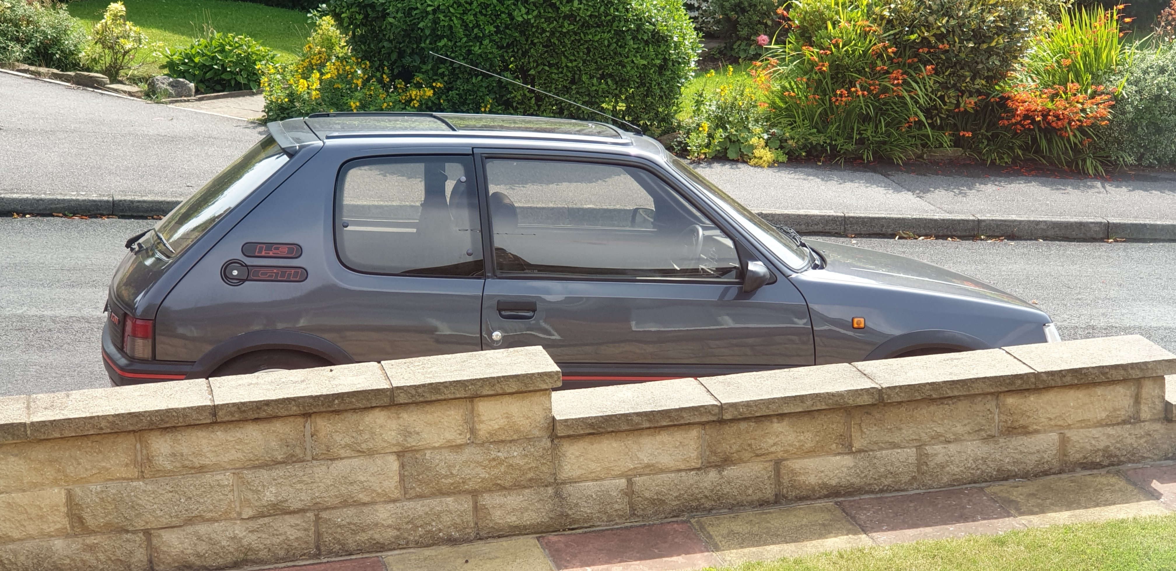

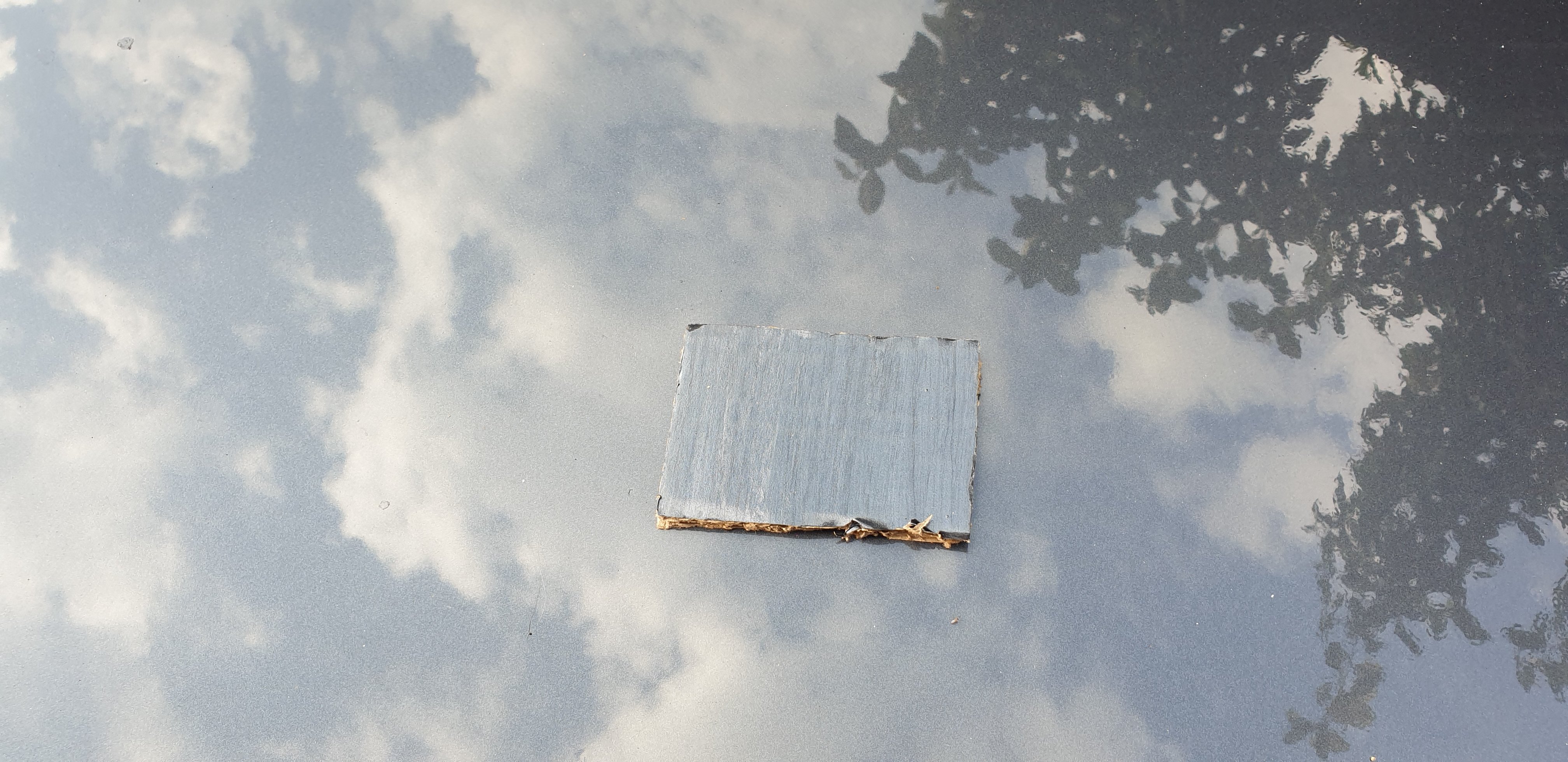

DSYKES5500 22 Posted August 10, 2020 When I bought the car it was advertised as Magnum grey. I ordered a sample pot of paint to later be made into aerosols, giving my reg number but it came labelled as Steel grey. I've sprayed primer onto some card, then the paint with the brush and then sprayed lacquer over. I've called Peugeot but all they've got it listed as is grey. There's no paint code under the bonnet as it's either faded or been painted over in the past. I've checked the vin but there's no paint markers in there I believe. Here's some pics: Share this post Link to post Share on other sites
welshpug 1,737 Posted August 10, 2020 really needs to be on something with the same surface finish and same colour base primer to get an accurate gauge if its a match Share this post Link to post Share on other sites

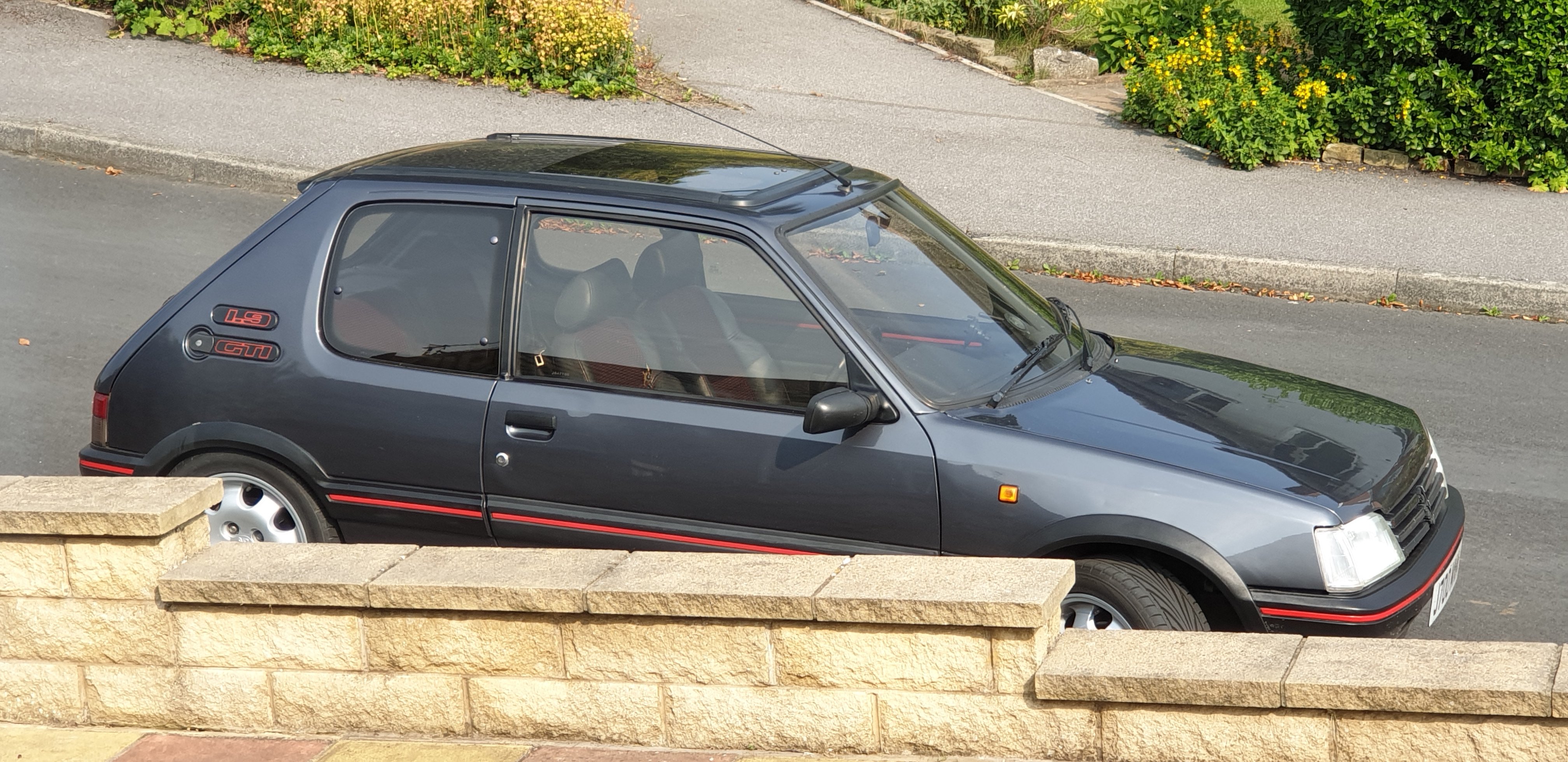

DSYKES5500 22 Posted August 10, 2020 Here's a pic of mine in the sun today... I'm confused! Share this post Link to post Share on other sites
Tom Fenton 1,650 Posted August 10, 2020 Take it to a paint shop and get them to mix to the car. There are usually a few shades of each colour. It looks like Steel Grey to me, graphite is darker. Share this post Link to post Share on other sites

DSYKES5500 22 Posted September 14, 2020 Thanks everyone, I managed to find an original Peugeot Magnum Grey M1TA aerosol and I've had a Steel Grey M0TA one made up. I've done a small repair on the sill this weekend, rust removal, stonechip back on and paint and tried the Magnum grey on it. It was way too dark and had an almost greenish tinge to it. I smoothed it down with wet and dry and the Steel Grey one is perfect and has blended in so you can't even tell. Mystery solved!! Share this post Link to post Share on other sites

DSYKES5500 22 Posted October 19, 2020 Sorted it! Peter at xtremeautoaccessories.co.uk knew exactly the dilemma I was having with the Magnum vs Steel problem. He re-made the paint and sent it over free of charge. I did it this weekend and the match is perfect. I've a bit of orange peel to remove but other than that it's spot on. It's definitely Magnum M1TA. It just looks so many different shades in different lighting it's untrue! Share this post Link to post Share on other sites
