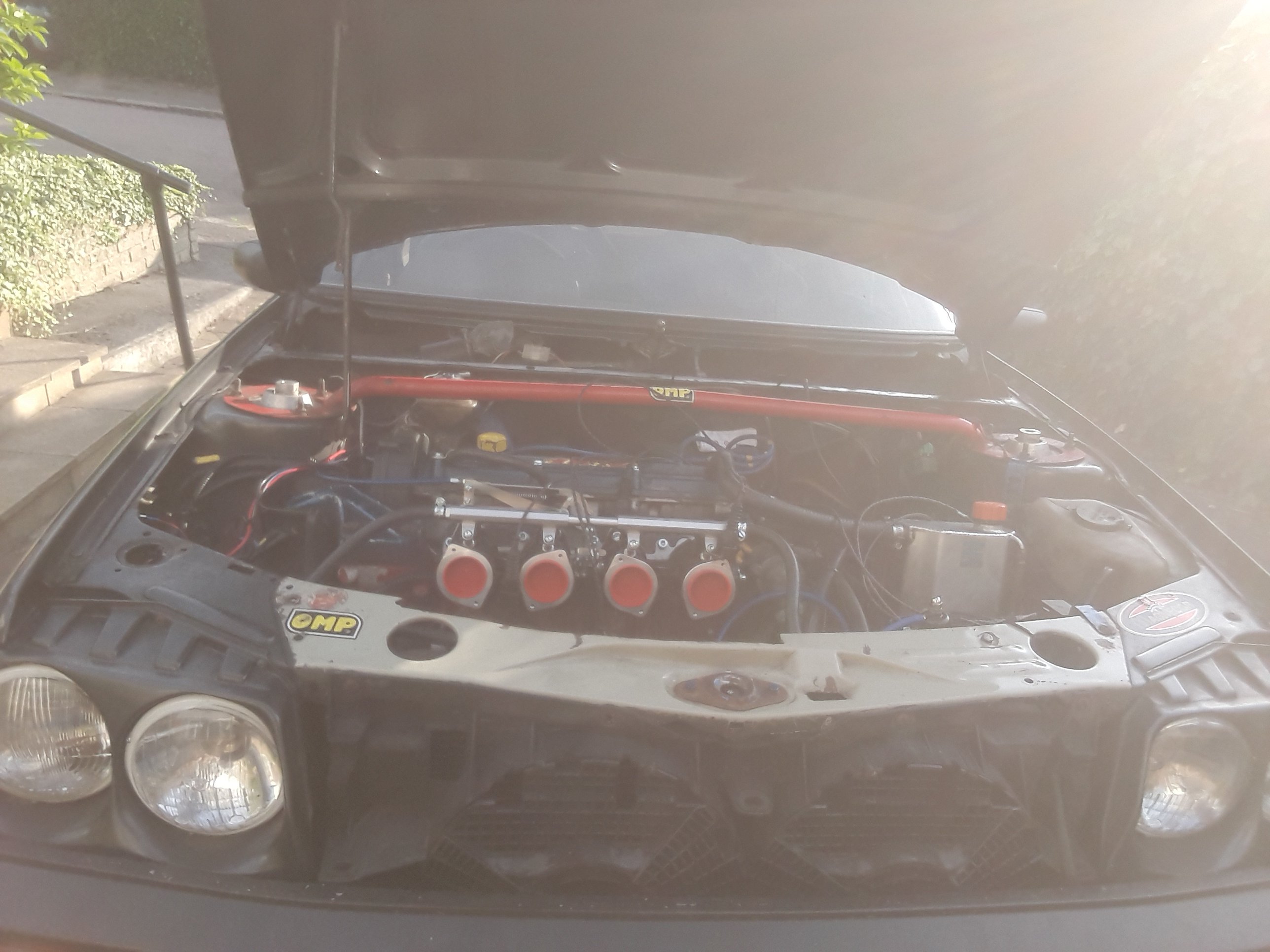

jimbojim 0 Posted July 31, 2020 what will cause my car to wonder off line on acceleration and lift of,car is 205 gti mi16 1.6 gear box and Quaife LSD ATB looked briefly at the suspension and there is nothing really wrong with it, anyone that can shed a light on the problem will be much appreciated thank you just added few pic of ITB conversion Share this post Link to post Share on other sites

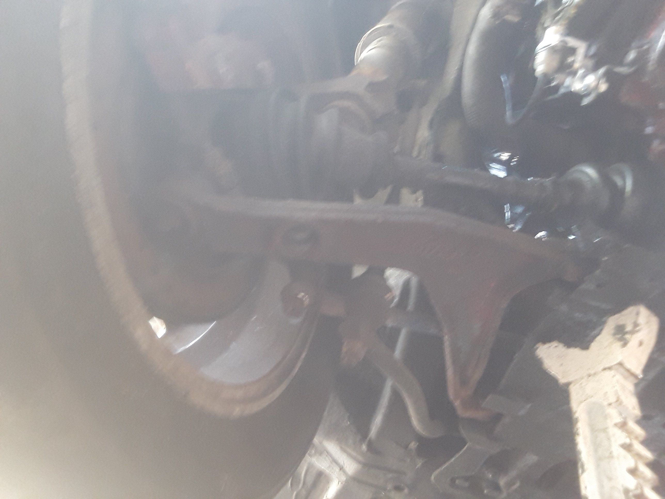

jimbojim 0 Posted August 1, 2020 i think from memory the wishbones are from another Peugeot 306 ( probably? to add to the width something that at the time were popular i will add a pic i am also in the process of ITB conversion and finding communicating between emerelad ECU end my leptop a bit of a daunting exspirince Share this post Link to post Share on other sites
welshpug 1,682 Posted August 1, 2020 309 that will be, same bushes as a 205. Share this post Link to post Share on other sites

jimbojim 0 Posted August 2, 2020 you are absolutely right but i hope it is just that LOL, i am also just finishing the wiring and have green light from the crank sensor with the aid of somewhat a batter missing wheel from pug1off which although wesent a fit but better then the one i had from emrelad,i now have an issue with communicating from my pc to the ecu,probably just a cable issue,yet to be seen,i have tried to figure out what are the two sensors just below no 4 on the inlet side, kind of bulge sensor could be engine knock sensor and oil pressure or oil temp,questions are1,do i need the knock sensor with the new ecu and 2 will a wide band lambda be preferably over narrow band,just looking for easy correct mapping realy Share this post Link to post Share on other sites
