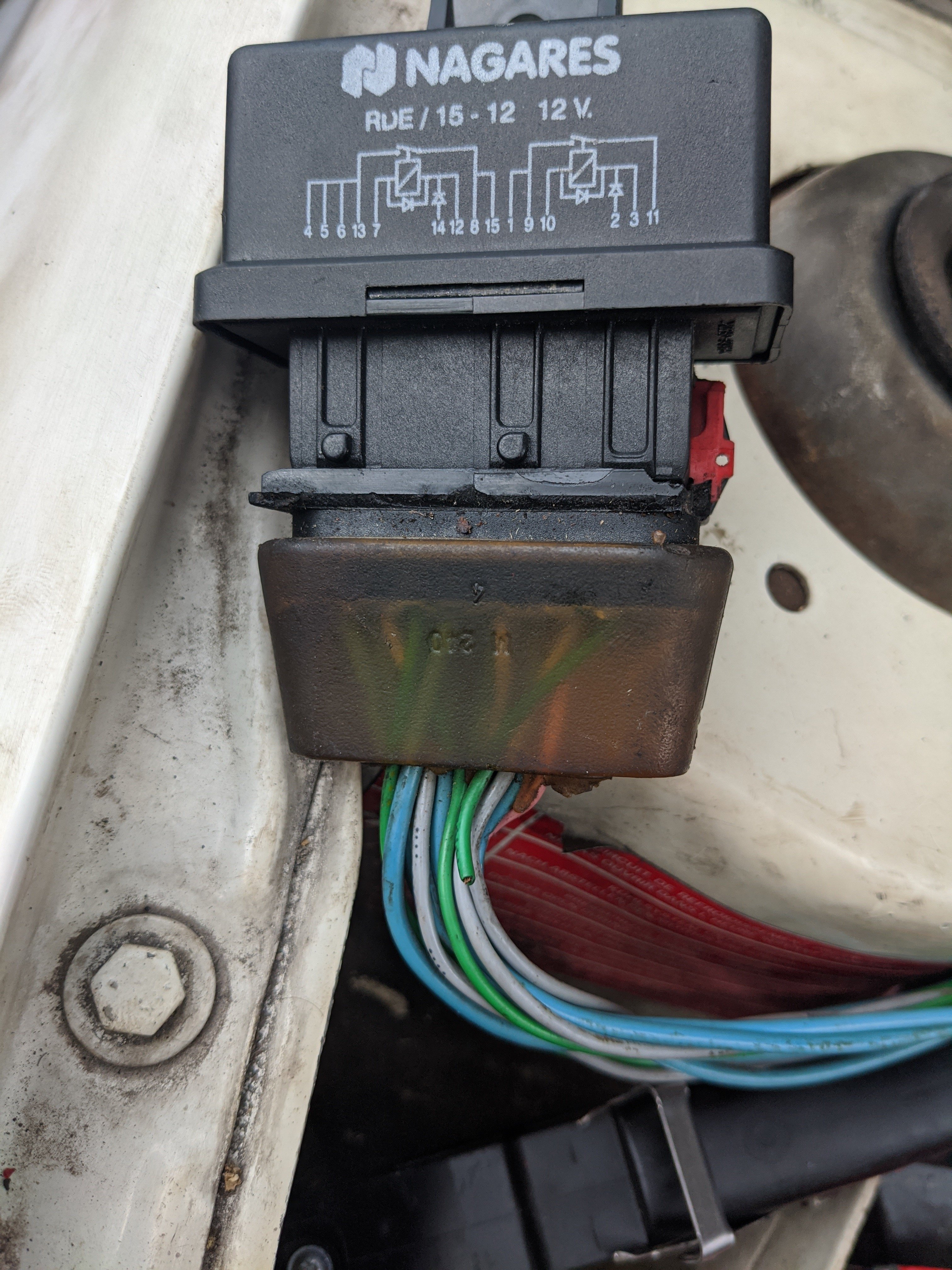

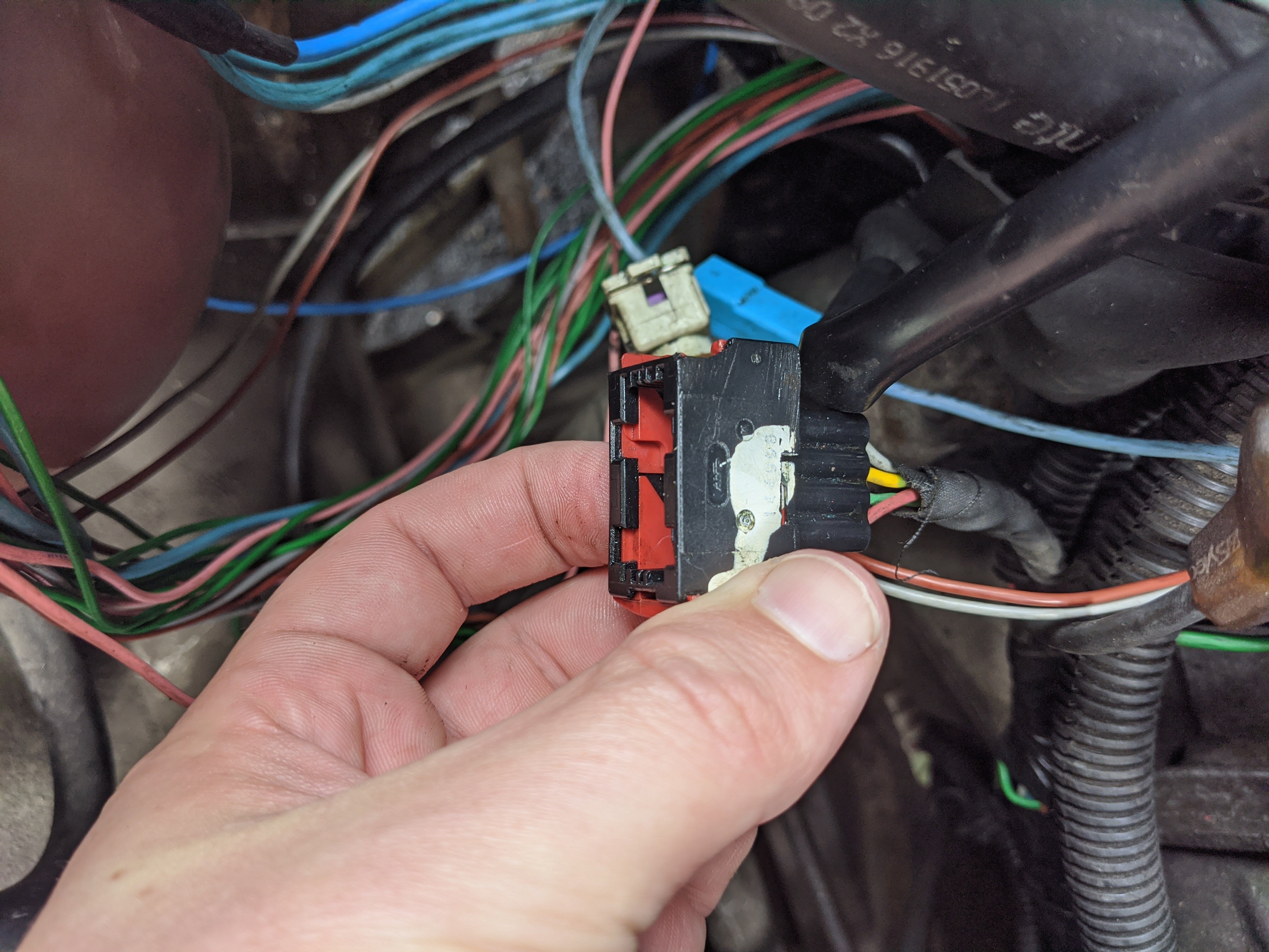

I have t it to a point in which it turns over but will not fire. I have had the ecu checked. I have checked the fuel pump and put a separate feed to it but still nothing. I have wired it in using the single plug off the 106 and have connected the tarted and ignition live to what I think is the correct pin. I have a couple of connectors left on the engine loom but after continuity testing them think they relate to the 106.
i have noticed on my fuel pump relay that the wire on the loom to pin  1 has been cut. Would this be the culprit? Where should this wire connect too? I have tried to power loom directly bypassing the relay from a thread on here but still it just turns over. The fuel pump doesn’t prime or operate.
