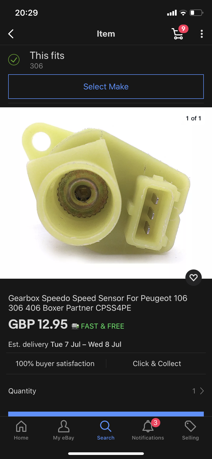

miamigtimark 3 1 Cars Posted July 4, 2020 (edited) One on eBay now . It’s a dual pickup but it will fit. Not sure if the red cog comes with it though. Doubtful. Edited July 4, 2020 by miamigtimark Add info 1 Share this post Link to post Share on other sites
welshpug 1,622 Posted July 4, 2020 cogs are a dealer only part I think, the housings are a separate part and readily available with the 2 and 3 wire sensors, dont recall ever seeing the cable only part for a 205 available other than with the dealers as well. Share this post Link to post Share on other sites
