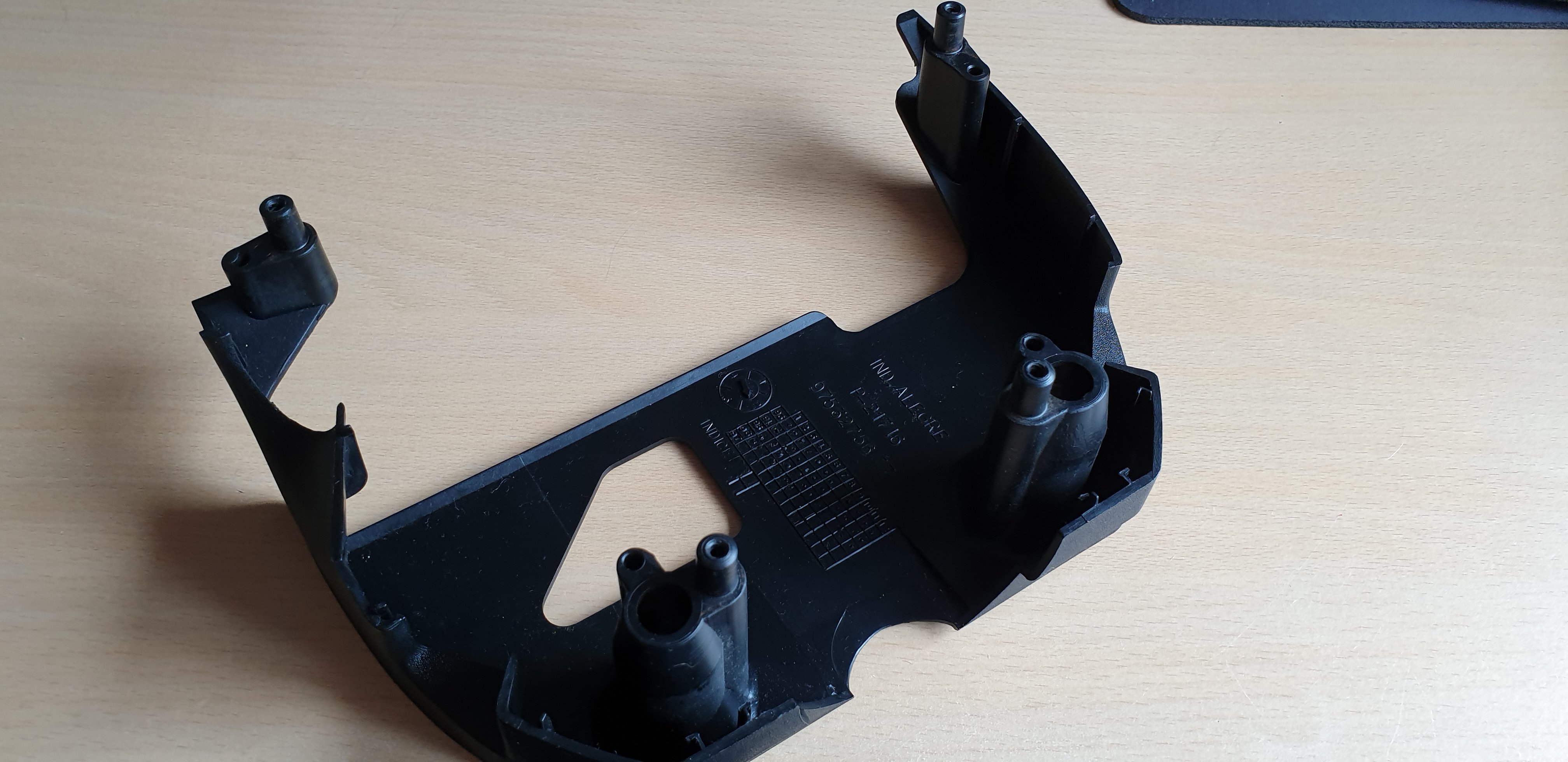

DSYKES5500 22 Posted July 4, 2020 Hi all, I can't seem to fit the top part of the steering wheel cowling. I can only see that I'd have to bend it really hard to get the screw hole mounts through the metal holes of the steering column. It's there a certain way to do this or is it a pray I don't break it job? Thanks Share this post Link to post Share on other sites
Telf 222 2 Cars Posted July 4, 2020 It can be a pig to do. I usually loosen the steering column nuts so it drops a tiny amount . You can get it in place easily then. With everything tight it's quite hard. Share this post Link to post Share on other sites
Tom Fenton 1,525 Posted July 4, 2020 As above. Slacken the 4 off 11mm nuts. The studs are quite long so it will drop down quite a bit. Peugeot thoughtfully put holes in the plastics so you can get to them easily. Share this post Link to post Share on other sites
DSYKES5500 22 Posted July 4, 2020 Thanks will I have to torque them back up or will "tight" do? I'll have the dash finished today! I've used the anti squeak tape on all pieces that come into contact with something and I bet you think I'm lying because it's a 205 but they're are zero rattles from it and it feels solid. Share this post Link to post Share on other sites
