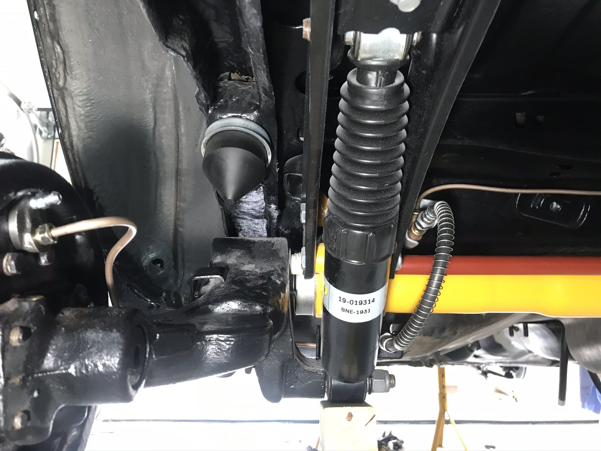

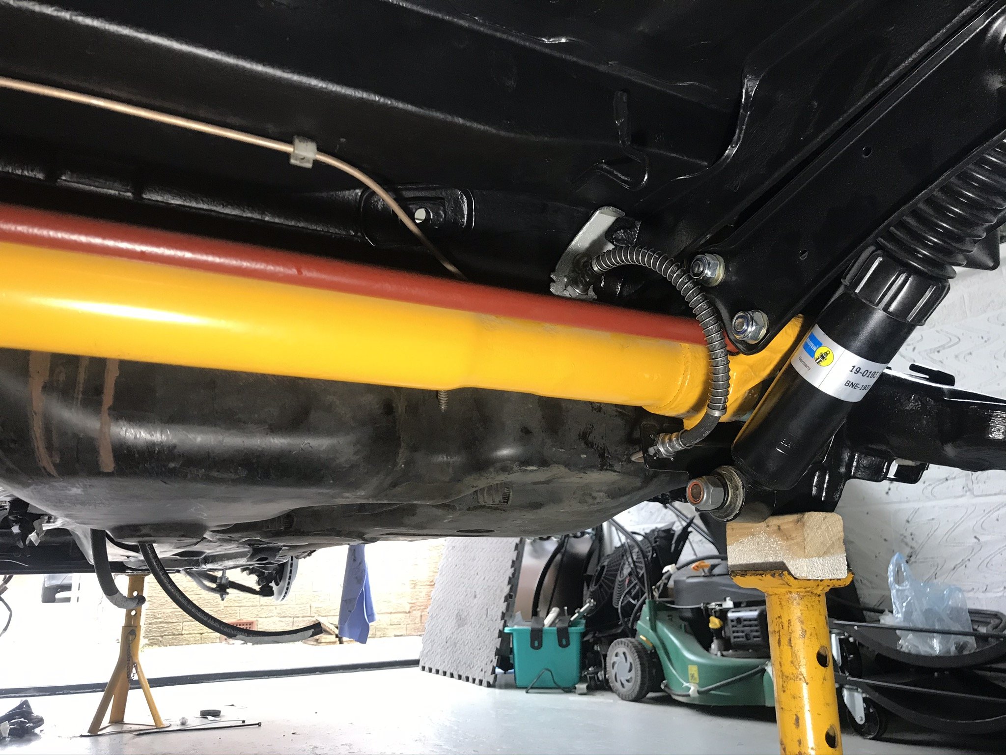

Philpooma 30 Posted June 29, 2020 No problem, i have added two images, one shows the adaptor where it come out of the brake distribution unit, the other is the offside, with jo adaptor needed. You would think that parts listed for the job would have the correct connection, but I have ordered these twice now and its been the same each time. Share this post Link to post Share on other sites
