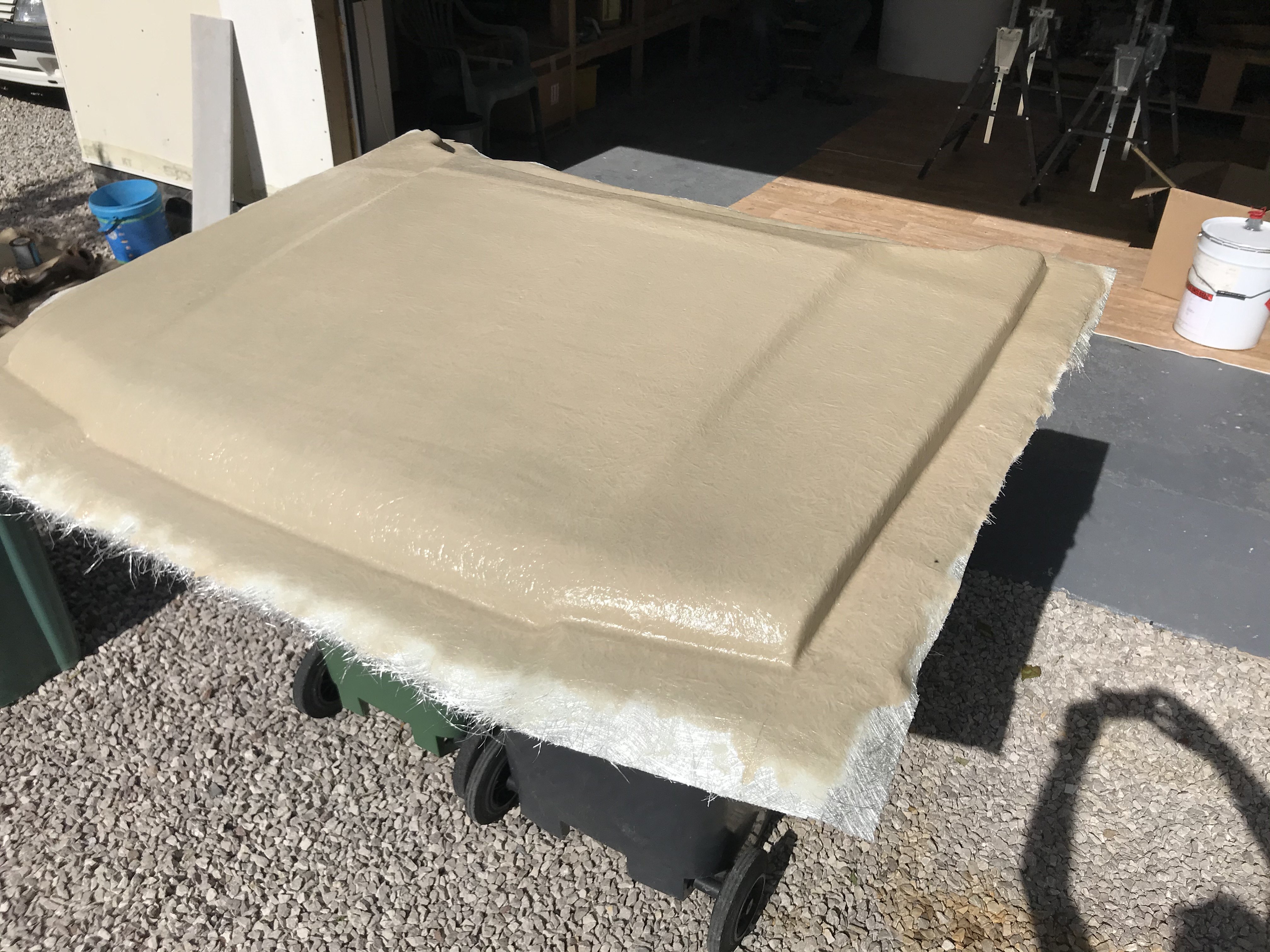

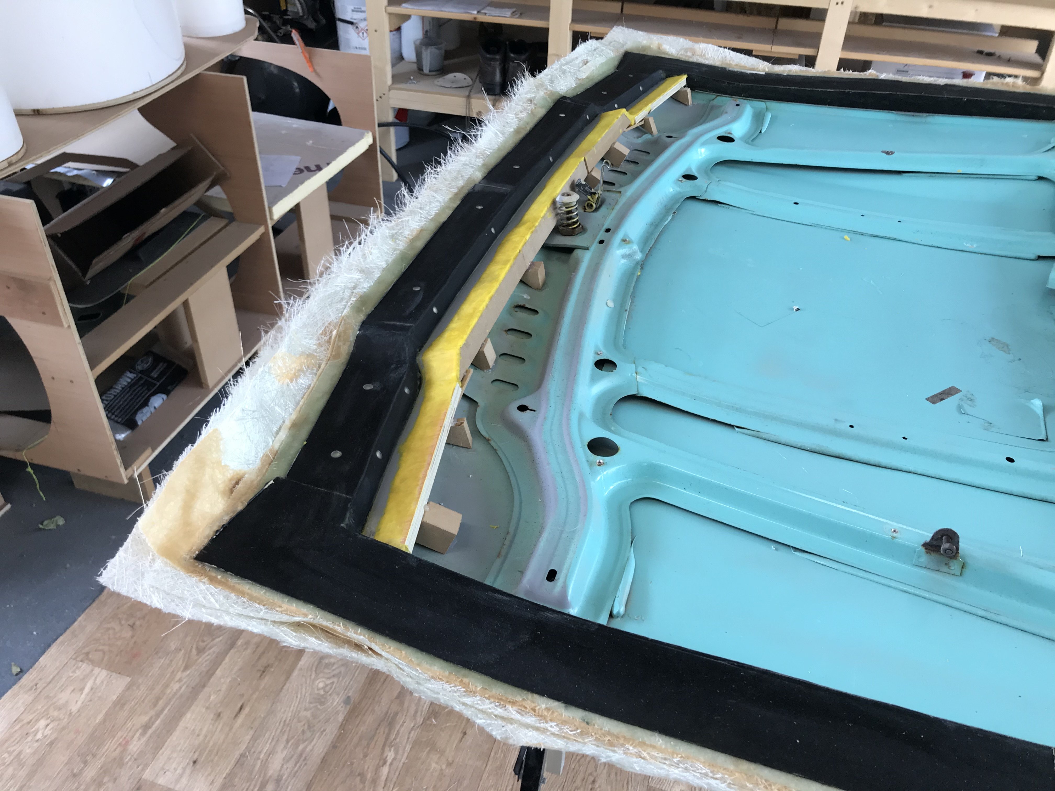

Myles 5 Posted July 13, 2020 A bit more done on the bonnet mould over the weekend 1. Tooling resin curing in the sun 2. The front edge is having a small return to give strength and be comfortable to open so needs a two part mould here so we can get it apart! Hope to have a carbon bonnet made by the end of August Share this post Link to post Share on other sites

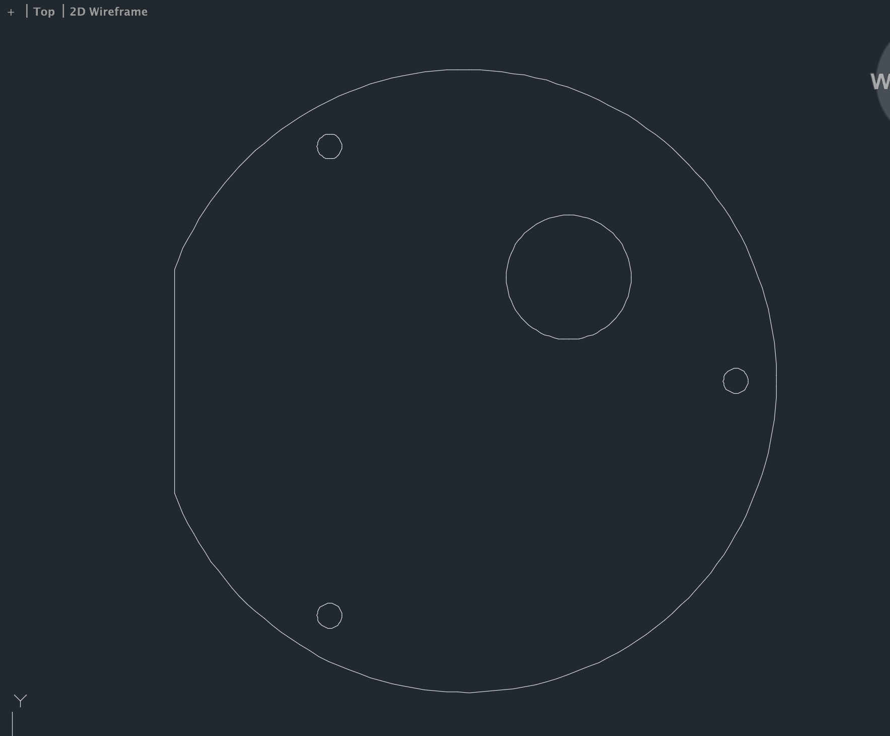

petert 636 Posted July 30, 2020 (edited) They're simple to make. Cut out 8mm plate on the plasma cutter. Obviously they need to be handed. If you're handy, you could make a test pair, get a wheel alignment, then adjust drawing for the final pair. Edited July 30, 2020 by petert Share this post Link to post Share on other sites

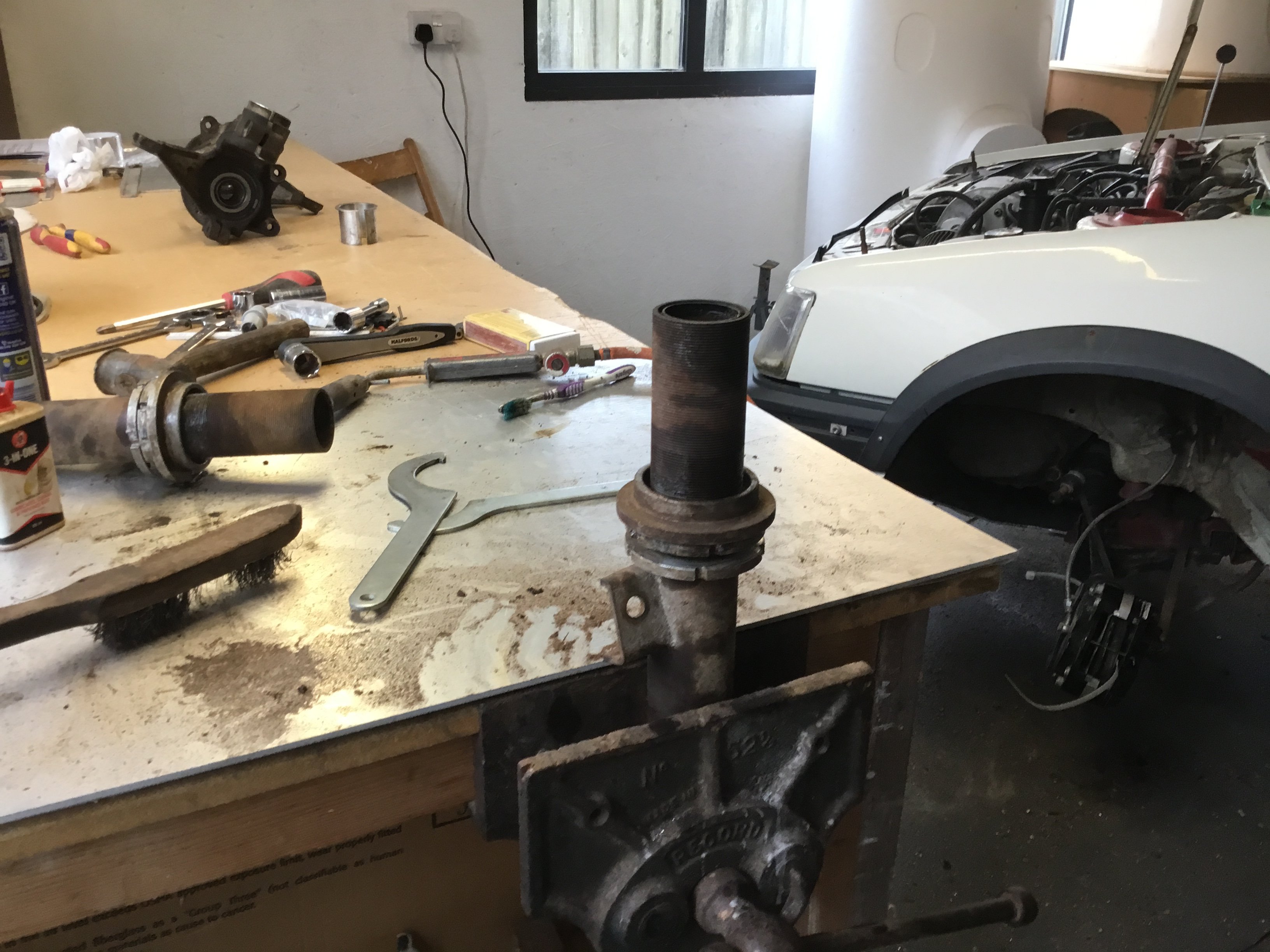

Myles 5 Posted November 27, 2020 Not got round to the rear yet - so to speak! But have had the front hubs machined by Bridgecraft for camber - excellent job and will rose joint the wishbone ball joint in the very near future, thankyou Allan. Currently fighting with the coilover spring platforms as they have seized to the tube but getting there ! New seals on the way from Skip Brown and that should do for now No events planned or foreseeable in the current state even the North West Stages has been canned again so will have the rear rebuilt in the new year - so, Which bearings are recommended and from where? What other items like covers and end caps are available?. And the big question - SHOULD I LOWER IT???? 1 Share this post Link to post Share on other sites

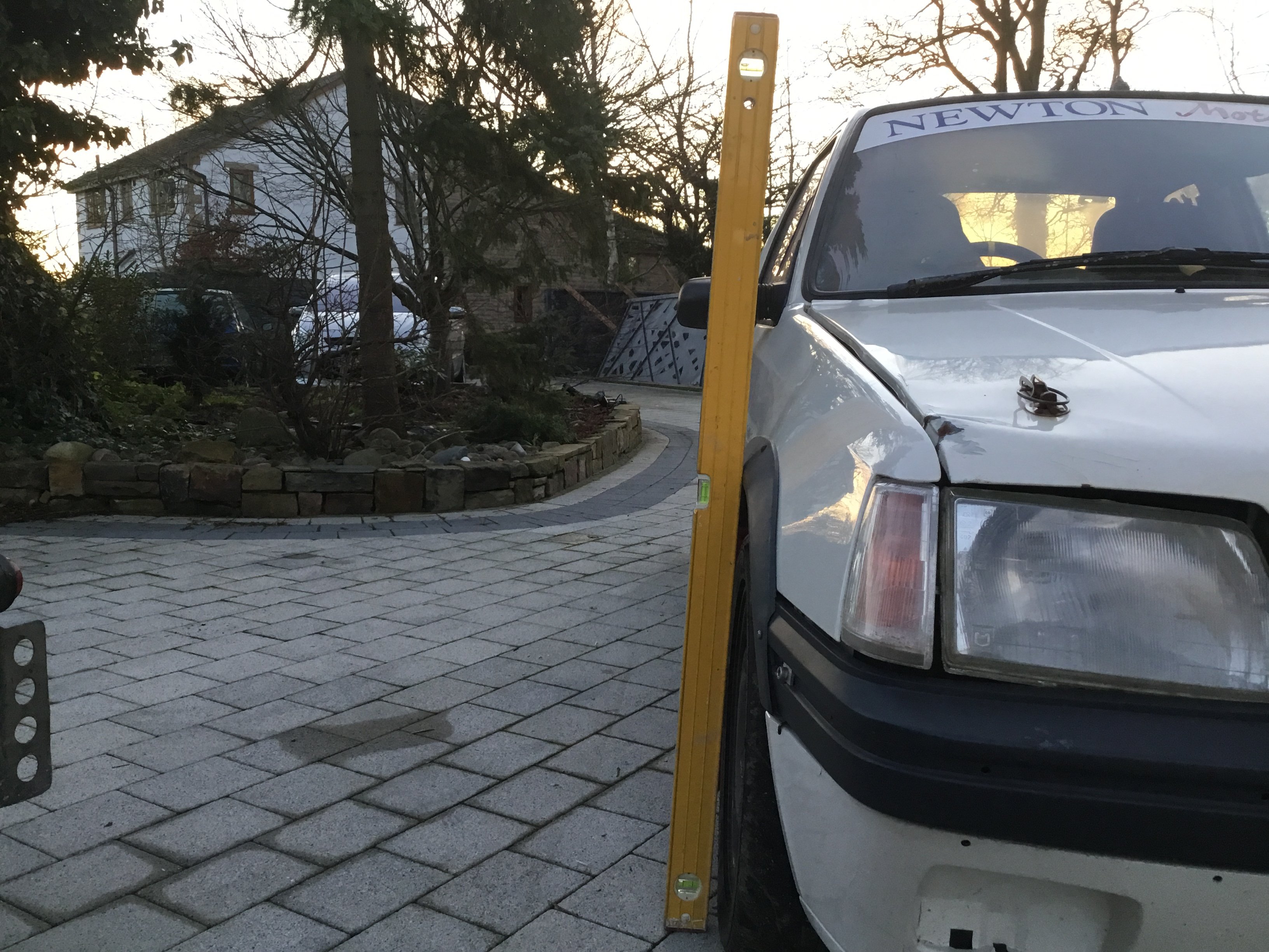

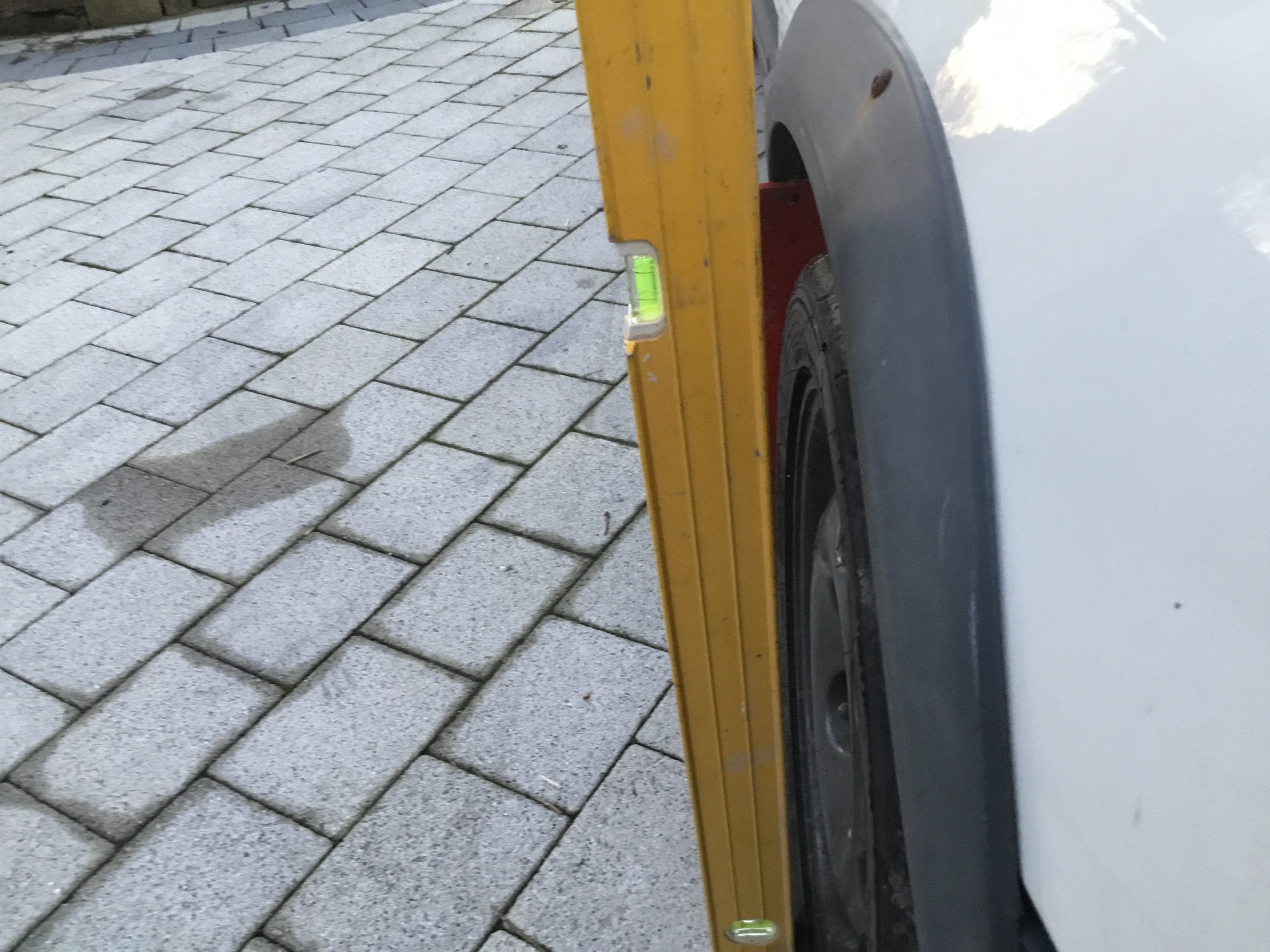

Myles 5 Posted December 5, 2020 Got some camber on now difficult to tell in the photo but with the level parallel with wheel and then vertical Will get a gauge on it next weekend after a little running around and set the toe and suchlike 1 Share this post Link to post Share on other sites
