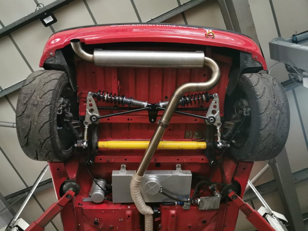

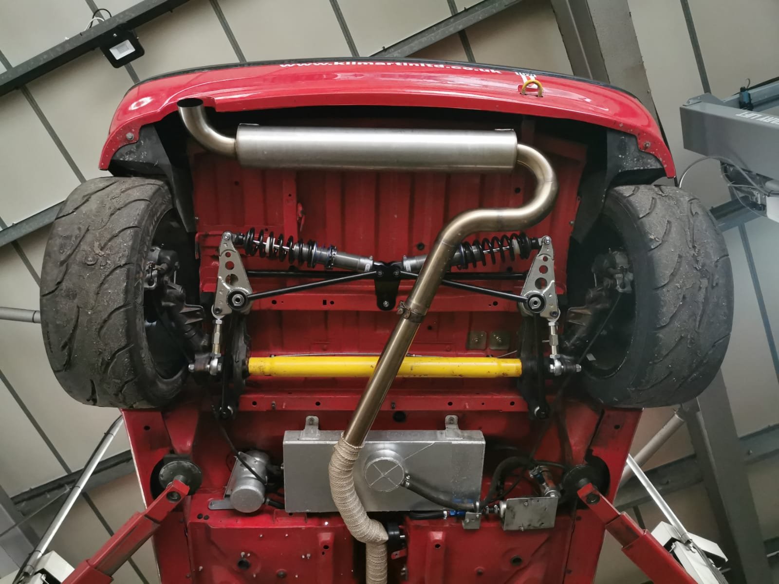

petert 630 Posted June 17, 2020 (edited) REAR: I've got a turreted rear end but probably wouldn't do it again. You can get equally good results by fitting quality coil overs in place of the shocks and add big torsion bars and arb. You need to fabricate some adapters to get clearance however. See attachment. They're 600lb springs plus 23mm torsion bars plus 25mm ARB. You also need the Bridgecraft axles to get some neg rear camber (-3º) and toe out (+2mm). You can add track at the same time with the length of the axle. ie NO spacers. FRONT: Everyone chases negative camber but you really need heaps more positive caster. As in +5 degrees. Add -3.0º minimum camber and it will turn. You need 500lb springs. TYRES: Yoko AO50 Do the rear first. Edited June 17, 2020 by petert Share this post Link to post Share on other sites

SweetBadger 99 Posted June 17, 2020 Really like the look of the additional spring / damper setup on the rear. May consider adding that to my setup. Currently have 25mm T/Bs rear / 400lb front. Did you design the adaptor yourself? I guess for road rallying that could be a good way to stiffen up the rear and provide some adjustment if you retained the standard t/bs ? Share this post Link to post Share on other sites

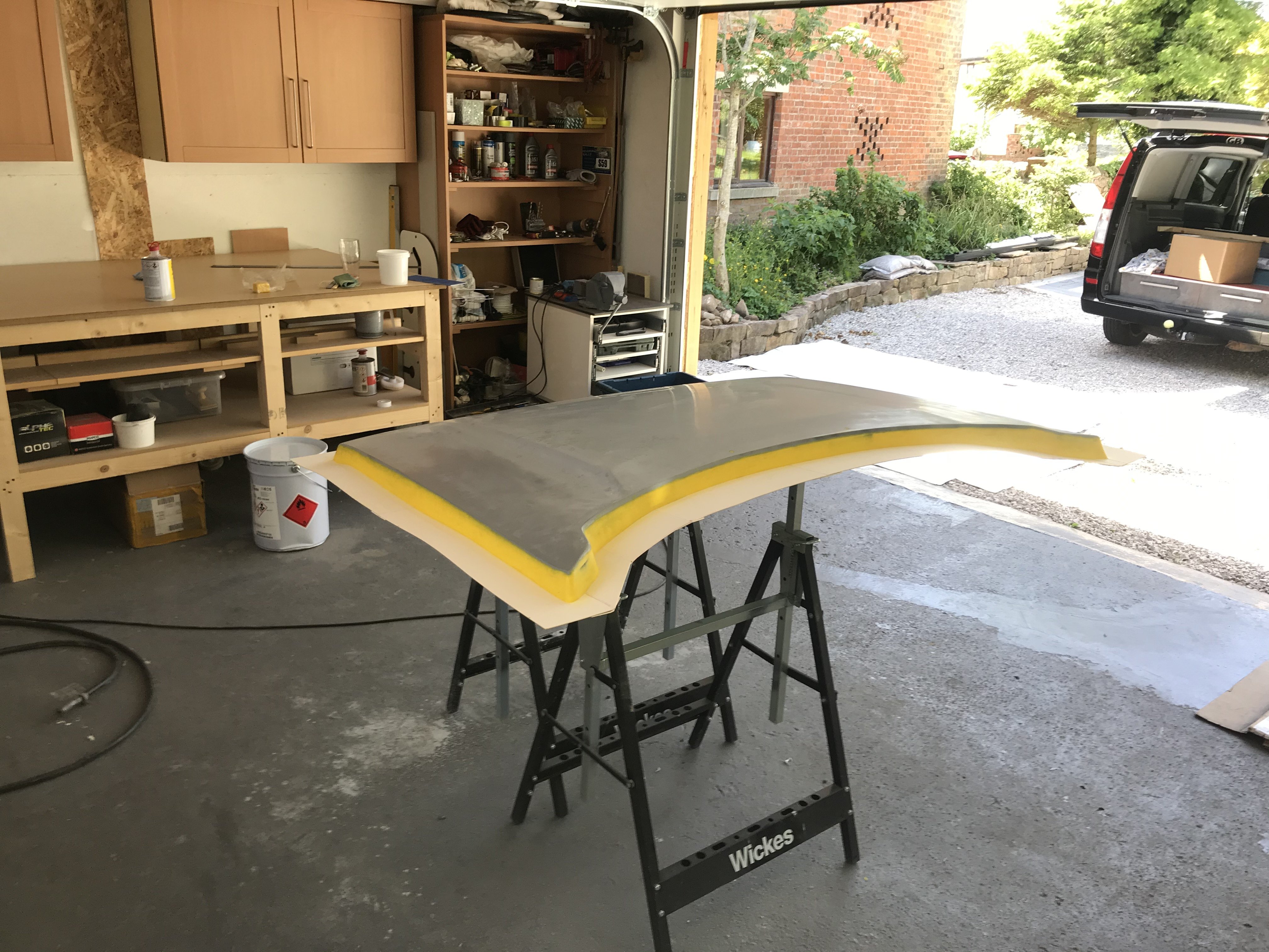

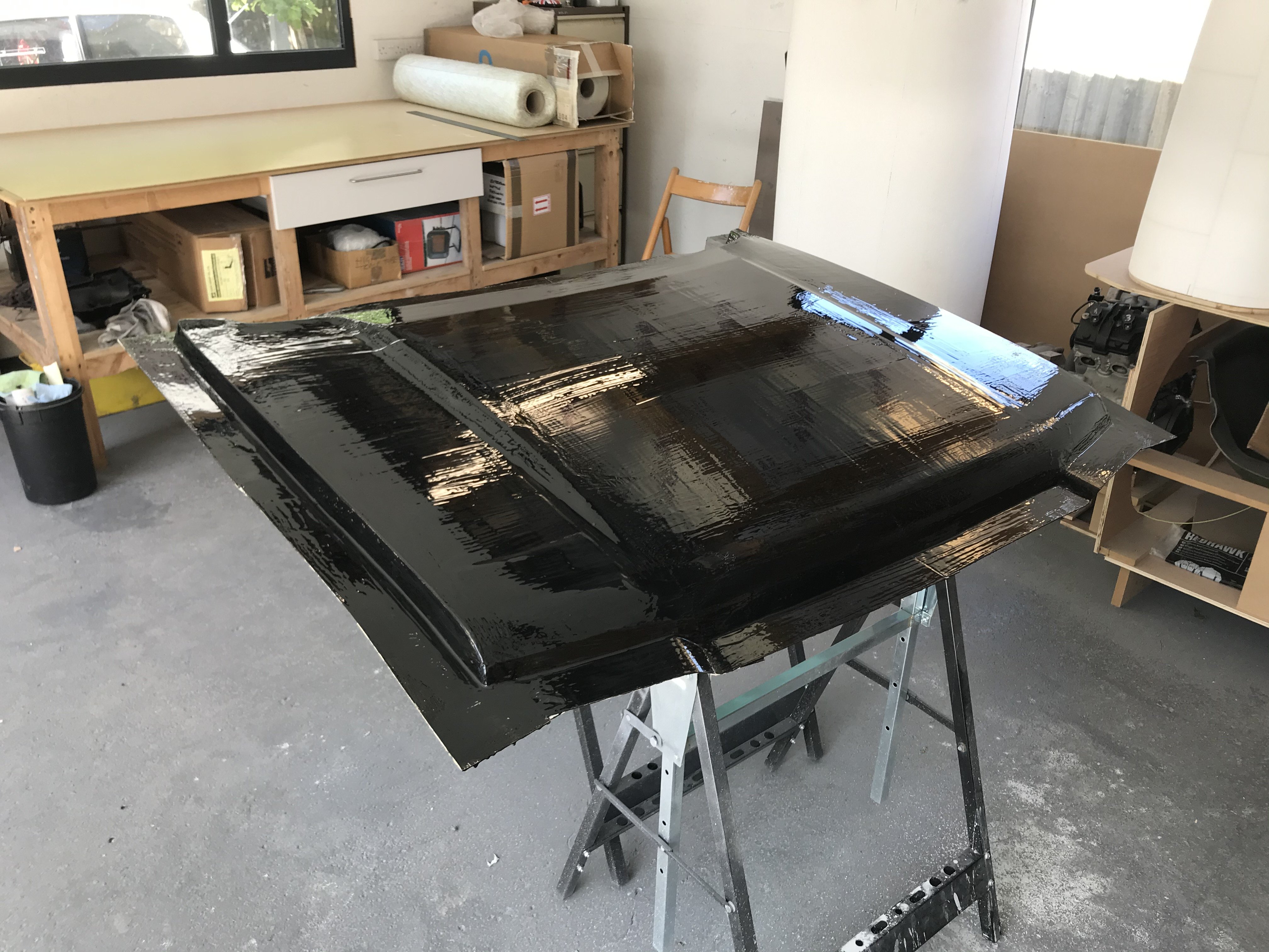

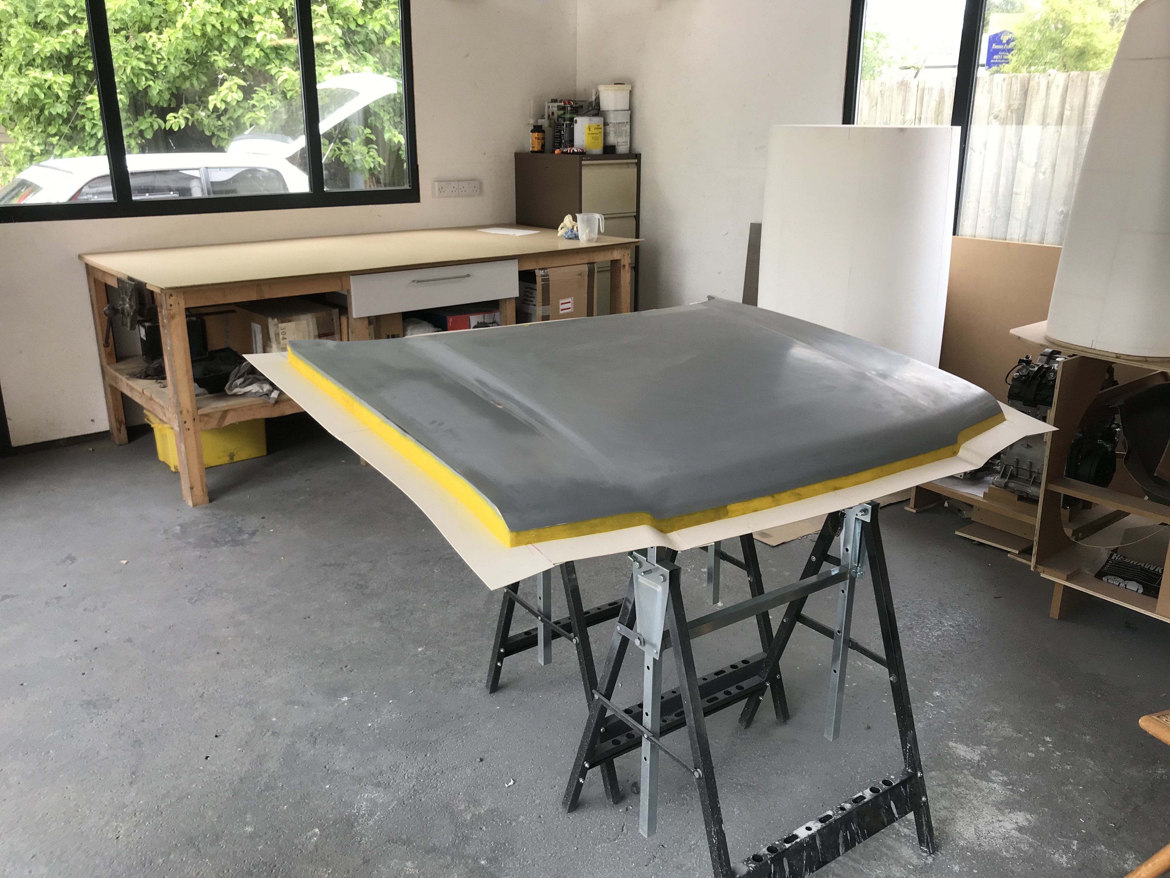

Myles 5 Posted July 1, 2020 Whilst waiting for the turrets to be fabricated........ thought I’d make a mould for making carbon /composite bonnets. Borrowed a mint auto bonnet of a mate and set to , 1+2 with filleting and release wax 3 with first gel coat Share this post Link to post Share on other sites

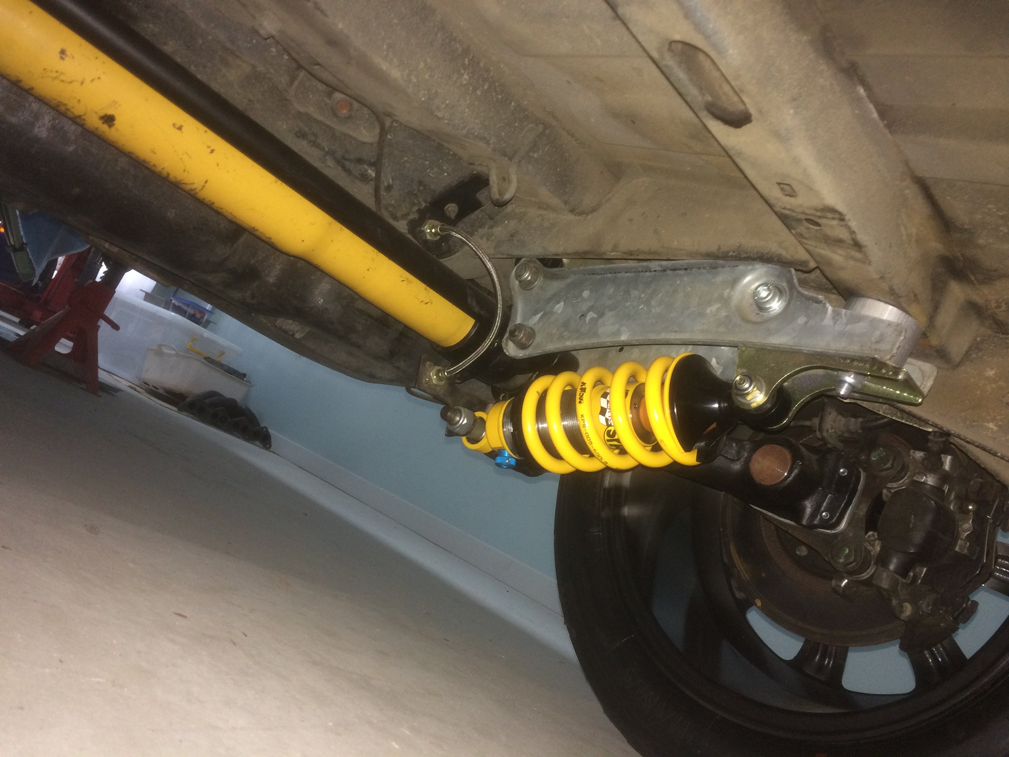

maxirallye 2 Posted July 4, 2020 Hi Myles, as you say, you can run turrets under Cat2 regs, but just a heads up that you can't run any bodywork mods, arches, wide track etc under Cat 2. (unless fully homologated, OE manufacturer panels.) Colin Satchell will be developing a push rod rear suspension kit for the 205 over the next few months, similar to the 106 kit already on sale, which would be Cat 1 legal and give you 1 to 1 damper ratio advantage that you are chasing with turrets. The photo is our kit fitted to a Saxo. Regards, Tony Share this post Link to post Share on other sites
