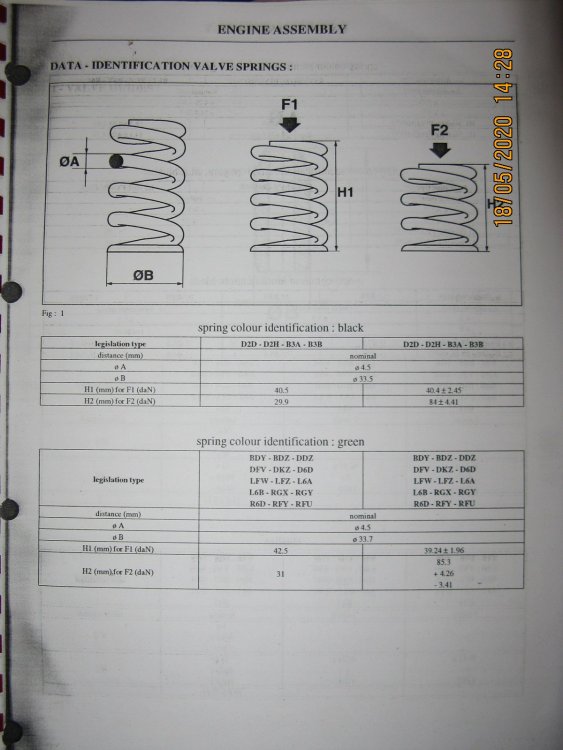

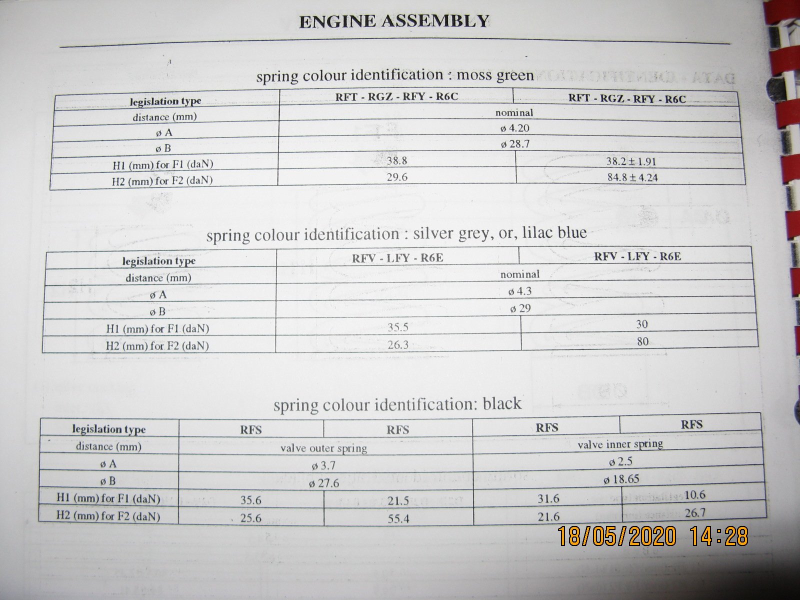

DamirGTI
Atlaskrukvaxt
Something doesn't add up here. The data sheet provided by DamirGTI doesn't match the numbers from your spring petert.
Judging from the datasheet I'd say the RFS outer spring should fit right on to the RFV base based on the OD of the RFV being 1,4mm larger than the RFS OD according to the data sheet.
The inner diameter on the RFV is 20,4 and RFS is slightly smaller at 20,2 (without the inner spring) so that could cause a problem there.
Or am I completely mistaken?
Edit: seems I'm partially mistaken at least. The full height can very well be what you have suggested as H1 is 35,5 at 300 N force
Edited by Atlaskrukvaxt

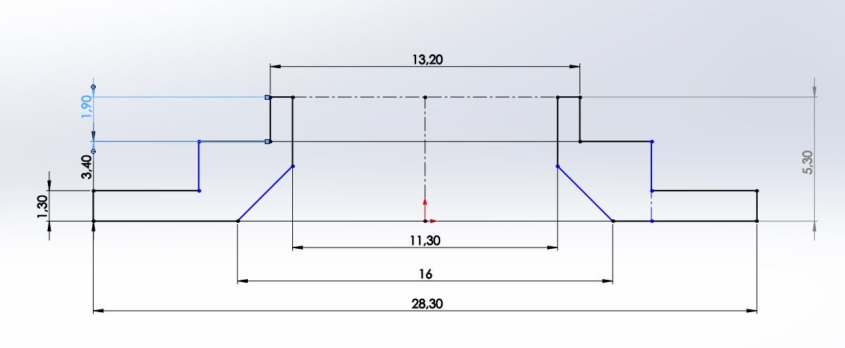

I took the liberty of drawing up the RFS spring base in solidworks as described in the other thread by welshpug to get a clearer overview of the situation. Could you post the same measurements for the RFV seal/base?

Petert, I guess in this post you mean the top picture is the RFS head and the bottom one is the RFV head?
If you still have the head could you take a closer picture of the cylinder going in to the block on the spring side?

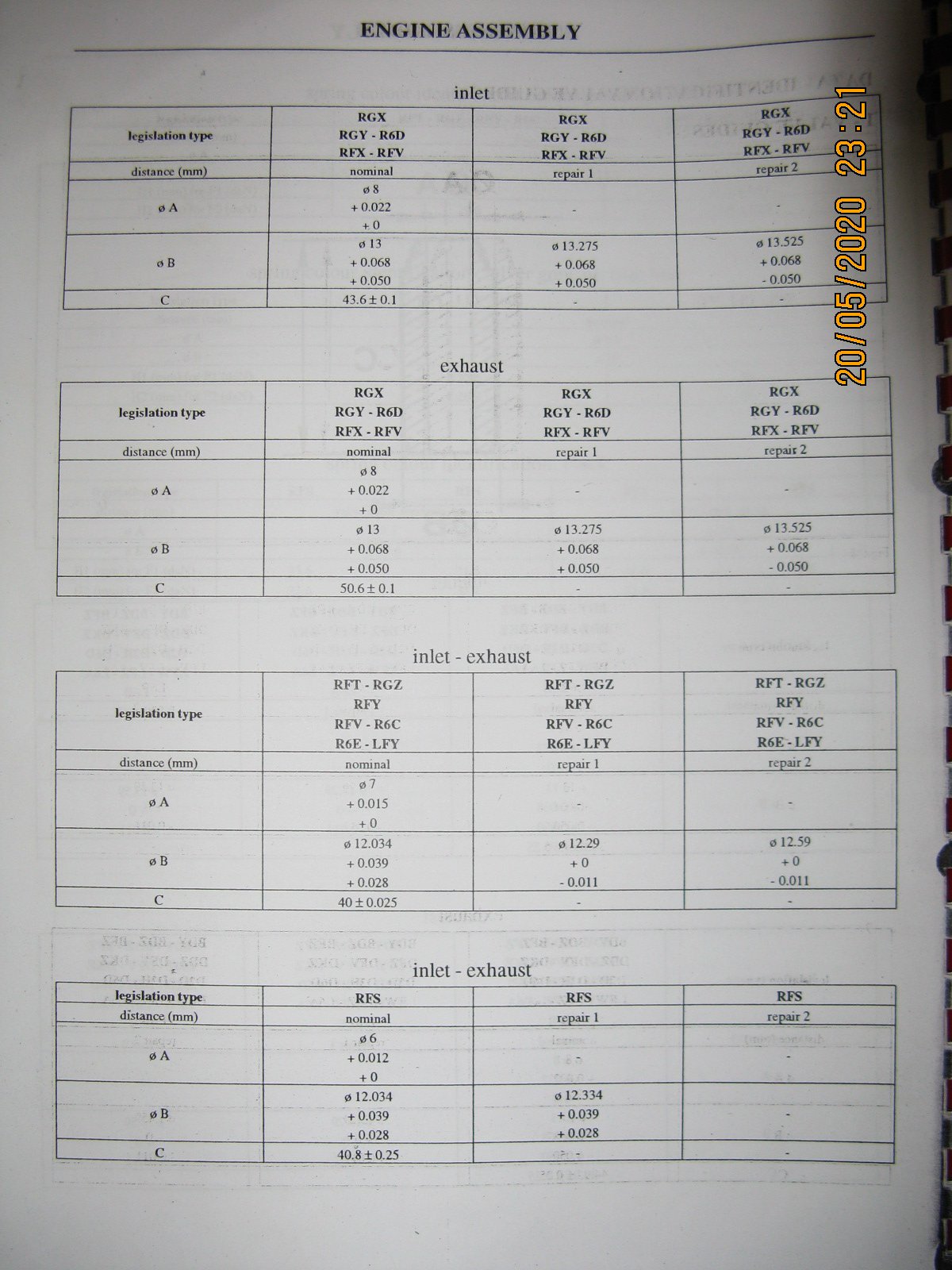

I have some data for the valve guides i you want .
Top head is RFY,  bottom is RFV.

DamirGTI
Valve guides are :
RFY/RFT :
Lenght - 40 mm
ID - 7.01 mm
OD - 12.06 mm
RFS :
Lenght - 41 mm
ID - 6 (5.98) mm
OD - 12.06 mm
So yes , the RFS stem seals are 6mm while RFY/RFT are 7mm ID .

DamirGTI
My bad ! misread the question pointing on the "j4r" rather than the "j4"
But makes no difference anyhow  , the above is all the same for these three - RFY , RFT and RFV too (D6C/DFW as well) ... only RFS is different - smaller .
