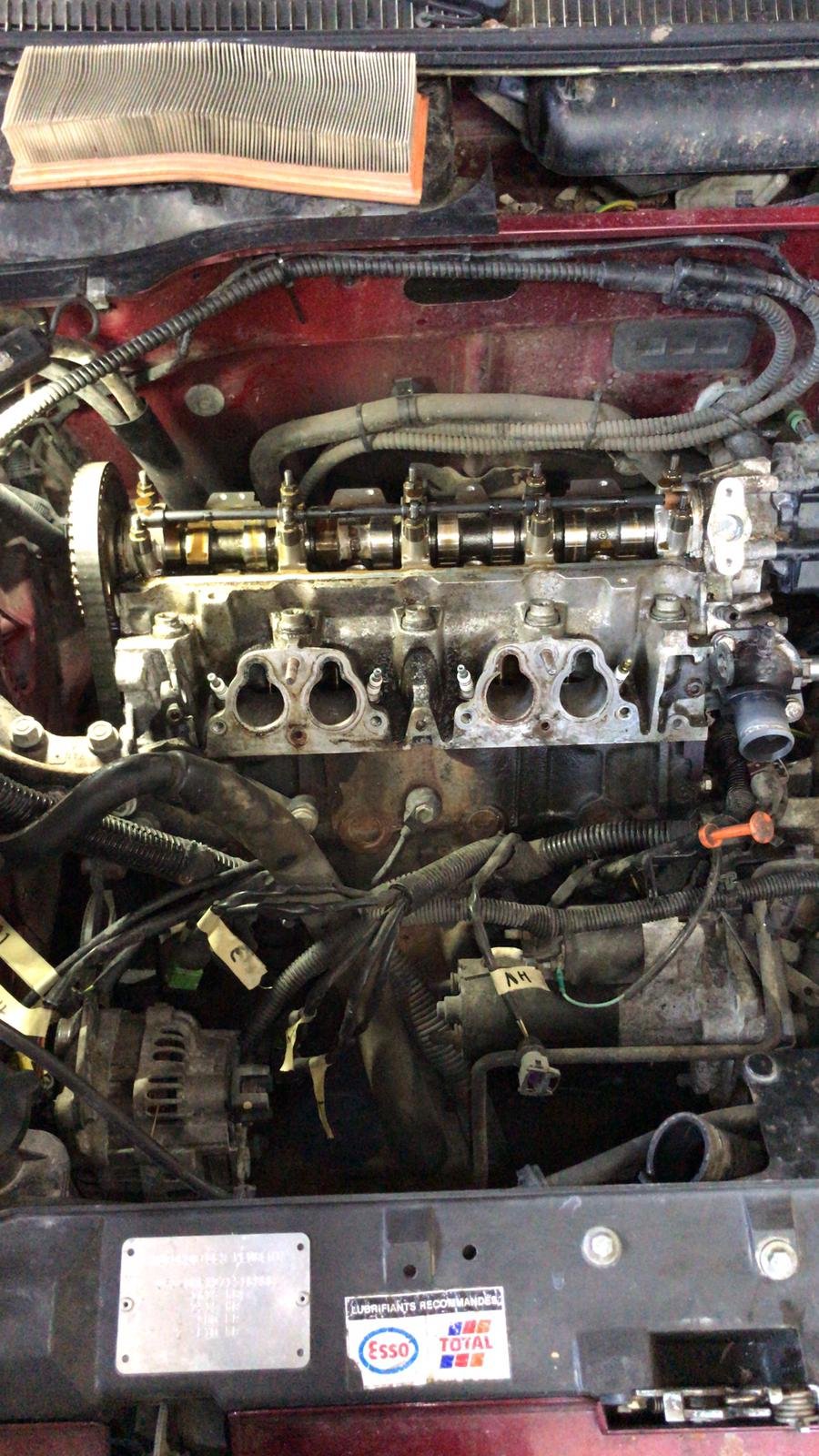

(pic semi related, it's a XU10J2C)

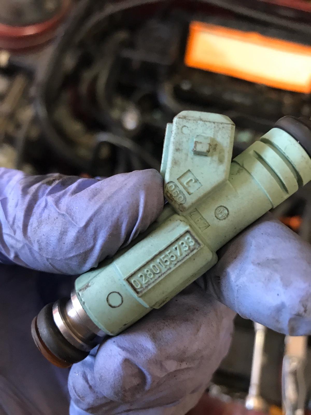

I let the two failing injectors take a ultrasonic gasoline bath for 10 minutes but they didn't start working after. So I now have two working spare IW-054 injectors if anyone needs.
I got a set of 4 green Bosch injectors with 208ccm installed instead of the original 190ccm. These were taken from a box of what I assume is volvo 740 parts.

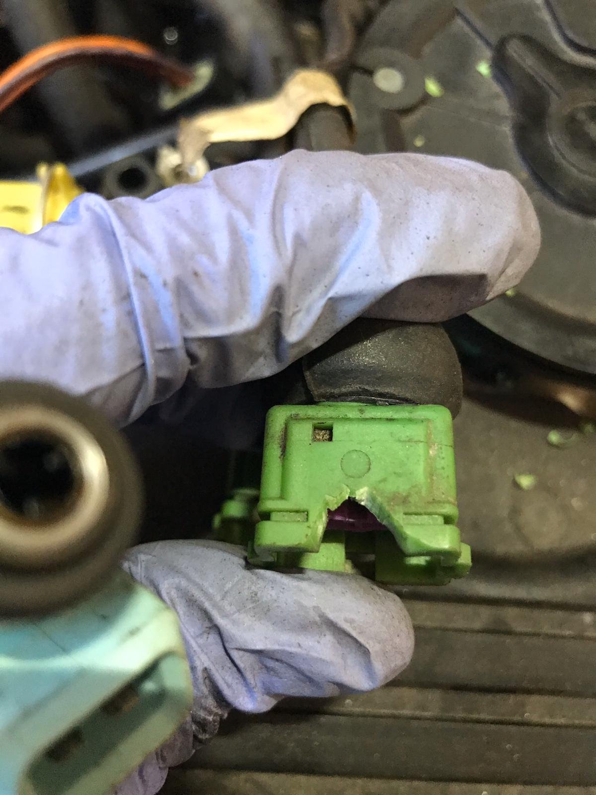

I had to modify the cable connection a little bit to fit the Bosch injectors but it doesn't affect the functionality if I ever want to put the original injectors back. Not very pretty but it gets the job done.
