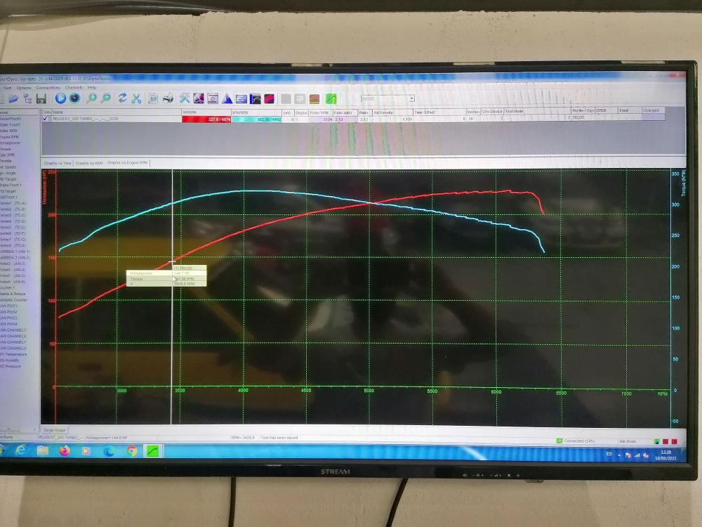

Maybe the catcams have a part on the late spool. We were touching the cam timing during the mapping and finally decided to leave it a bit retarded just because achieve a slightly smoother torque entry.
What annoys me was althought the vast change in cam duration the powerband is near at the same RPM than before.
As said, the mapper said that more boost is not producing more power on the upper band of rpm, dont know why. I hope its because the crap icpiping/intercooler/inlet.

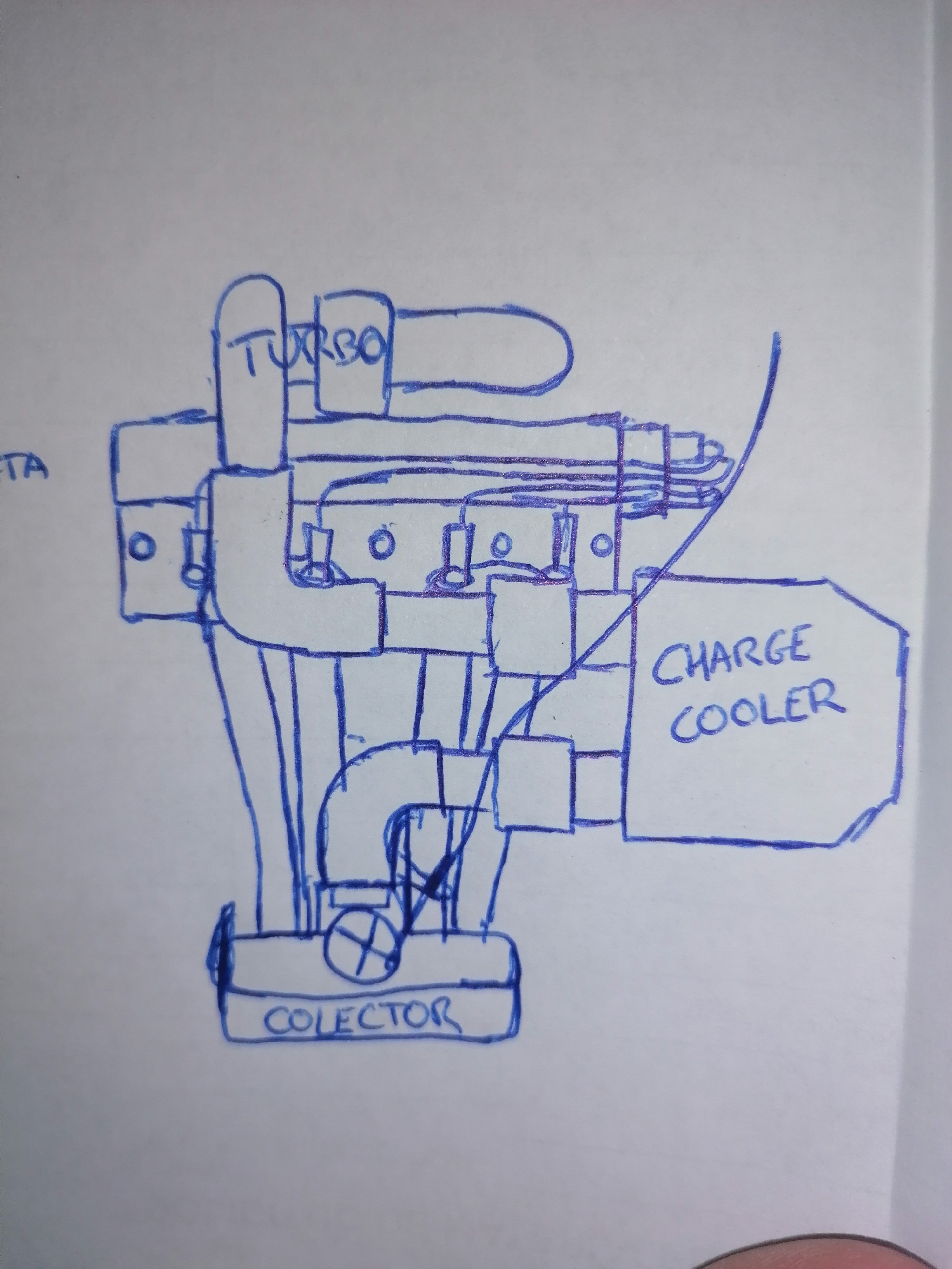

I have made a draw about the chargecooler plan.  Using a 306xsi/citroen xm manifold.
All your opinions are welcome and taken on account.

A chargecooler is a 2 step cooling and a fmic is a 1 step cooling; on continuous load, every step will have a delta between the cooling medium and stuff to be cooled. This is because heat flow goes with the quadratic of the temperature difference.  This will be in the scenarios on track for instance, where you run 60%? of the time on boost.
In the scenario where you only do an occasional run on boost, the story is different; the coolant in the chargecooler has a cool buffer that will have hardly any temperature delta with the outside temperature and the chargecooler will perform better. Until the coolant heats up and above story applies.
Have a read on this site: http://www.mez.co.uk/turbo8-new.html
That guy did some experiments and ended up with a fmic.
In practice I've seen people using the T16 chargecoolers on T16 engines and they struggle on continuous load; even 1 example of a trackday car having a fmic inline with the chargecooler.
If you go chargecooler; pick a bigger aftermarket one than the T16 chargecooler; better bang for the buck.
Wrt to your setup; I think you have an issue with your boost control; my 2.0 tct with non-ball bearing td04hl-t15 turbo does have full boost at 2700 rpm and have seen similar numbers on tct's with ball bearing turbos . Check if the actuator has enough preload and don't let the boost control kick in to early.
Regarding the length of the ic piping; I think mine had similar length, so that should not be an issue. Mine had 2,25" diameter though...
The inlet temperature is something to watch on these engine; they get very sensitive to knock if iat is high and dialing out advance at high end sounds like you suffer from this.
I would just grab a double sized fmic from ebay and check what that does to your iat, before you do big investments.
My intercooler was maybe 1,5 times yours and on the edge at 1.0 bar...

Well, didnt thought it that way. There are 2 ineficcient steps to cool the air. Damn.
A lancer evo 7/8/9 stock intercooler seems a quality unit to stick on nicely. Surely its capable of perform good for us.
Only concern is the way will sit right in front of the water radiator, dont want to solve a problem and create another.
The inlet manifold sucks, it seems like its basically crap for flow. Have various gti inlets here but dont want to take the head out for port matching as its been just torqued down with new gasket etc.
I have readed the port mismatch is big and cant be overcome only modifying the manifold, its that correct, isnt it?
Yes you need to work on both.

After a chat with the tuner today definitely we have a restriction somewhere between turbo and engine.
He says that more boost in the high rpm causes LESS power so need to solve this.

And yes, i set the cam timing as per catcams advise, however in the rolling road tried different retarded settings to see if we can push the torque up in the range and smooth the curve, at cost of a little lowend torque.
The plot i posted have 2 lines, a "catcams set" curve, and a 3deg retarded curve.

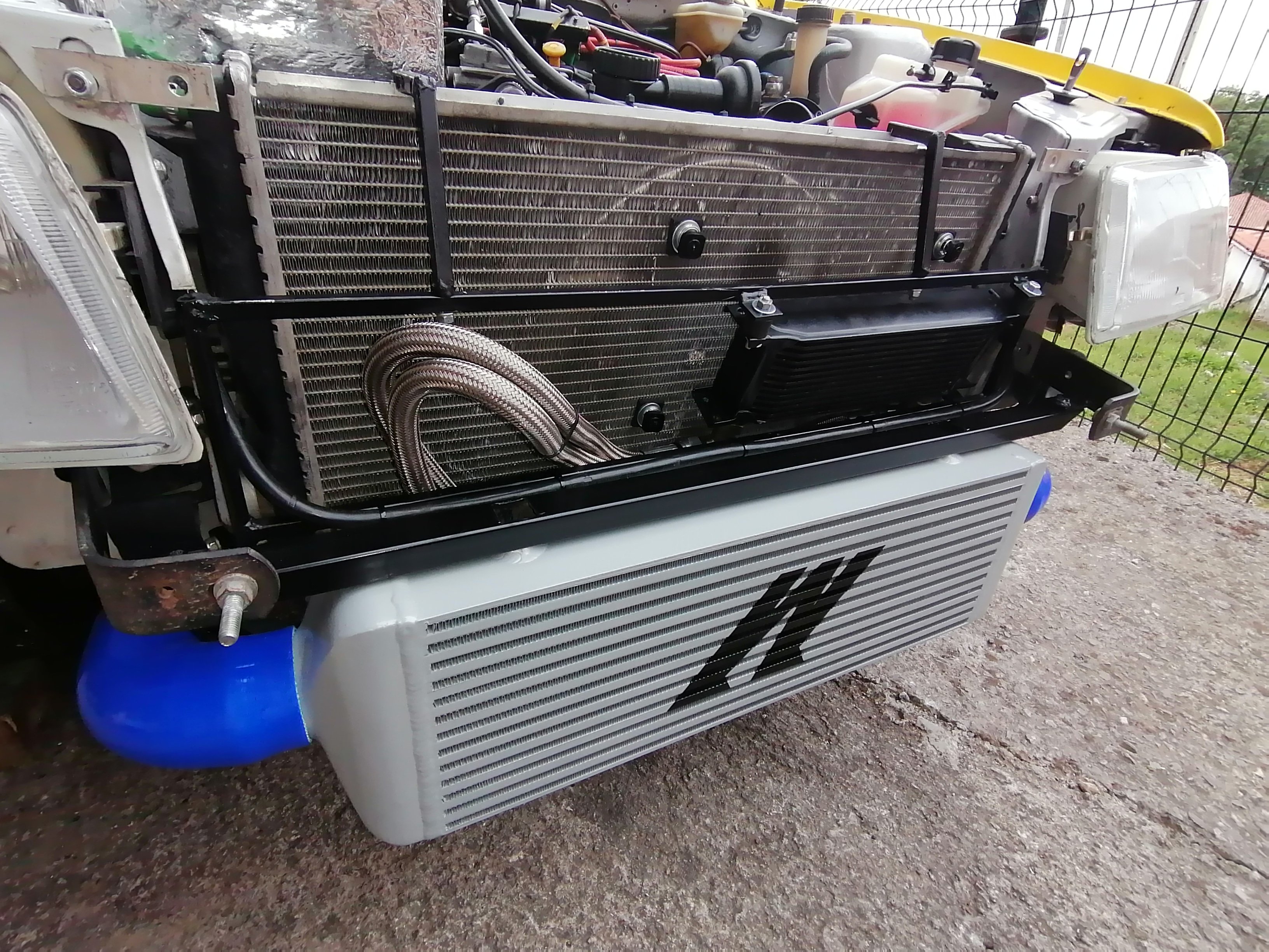

Last update.
Today we have taken the car to the mapper again hoping to be the last time at least since the 2021 season its finished.
We finally changed the intercooler to a mishimoto J-line unit, (pretty good unit and well finished), and the TB from the stock one (weird shape 48mm horizontal ID and 44mm vertical), to a more suited 54mm round. We modified the IC-Mani pipe to smooth the bends as there was a pair of tight curves that we dont like at all.
And was kind of a deception as althought we totally cut the high IAT problems (from reach 50C in only one pull to repeated steady 30C pulls), we only picked about 10hp low down and 7hp in high rpm.
228hp/6074rpm and 322nm/4100rpm.
Seems to be the same problem thant before, the engine simply dont get better with more boost and makes its max at 1.2bar. Tried to crankup the boost to 1.4bar without luck, only slightly more torque lowdown.
So finally, we will leave the engine as it is for this season and then send the head to make a good porting service (its completely stock head).
Anyone knows a good company to send the head? We thought about CNC porting too.
Thanks for all the replies, we appreciate so much the aid to finish this project.
Even just a decent 3 angle job makes an 8V head come alive.
camgti
Are you valve springs able to cope with the extra boost? Could be your issue of not getting more boost. Or your WG pressure. Head flow wont affect the amount of boost you can run.
Edited by camgti
Cam may have hit the nail on the head. Consider this. A big, heavy 8V inlet valve needs at least 90lbs of seat pressure to keep it under control. Many people don't pay attention to seat pressure when rebuilding heads and this value could be considerably less on a reconditioned head.
Then consider the back of the inlet valve has an effective area of approx. 1025mm2 (subtracting stem and seat areas). If you apply 15psi of boost to the inlet manifold, you can use the formula Pressure = Force/Area to calculate how much force is acting on the valve. I won't bore you with my maths, but my solution is approx. 24lbs
Thus you have 90lbs of spring pressure trying to keep the valve closed and 24lbs acting against it. The net valve spring seat pressure being 66lbs, not enough for that size valve. It could be far worse.
By my maths, you need 114lbs of seat pressure to make the engine work as intended. Maybe I got the numbers wrong and others please check it.
Of course that's all very theoretical and you may get away with less.
