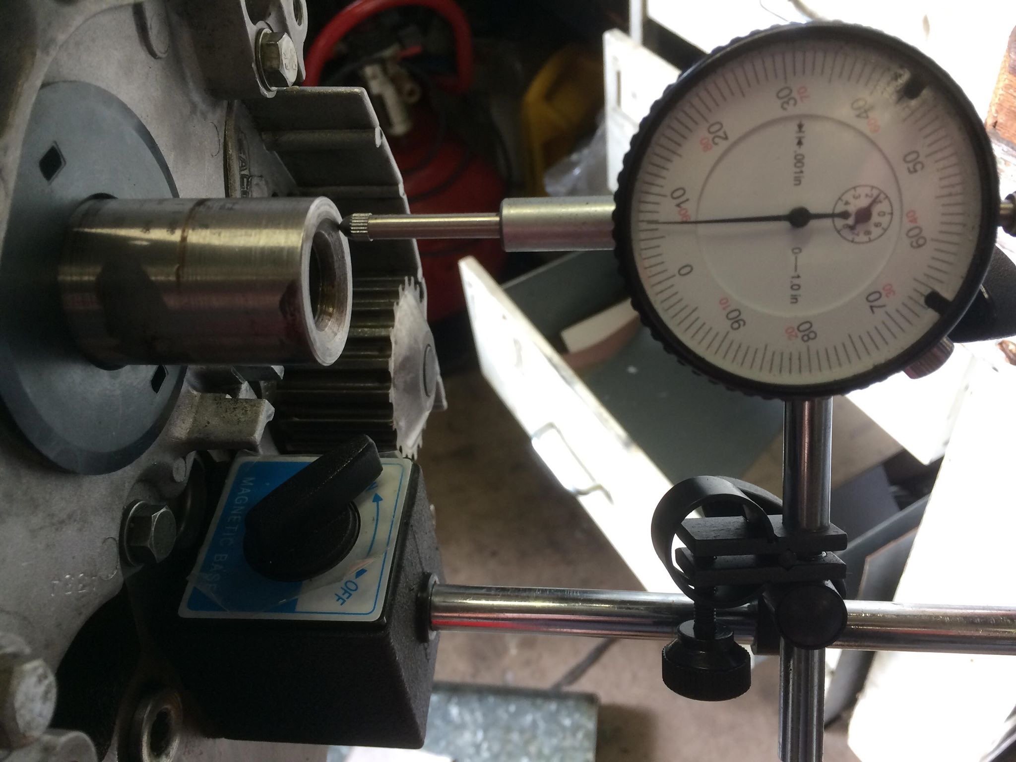

t took a long time to achieve this!
At least the end (float ) is in sight now . .
