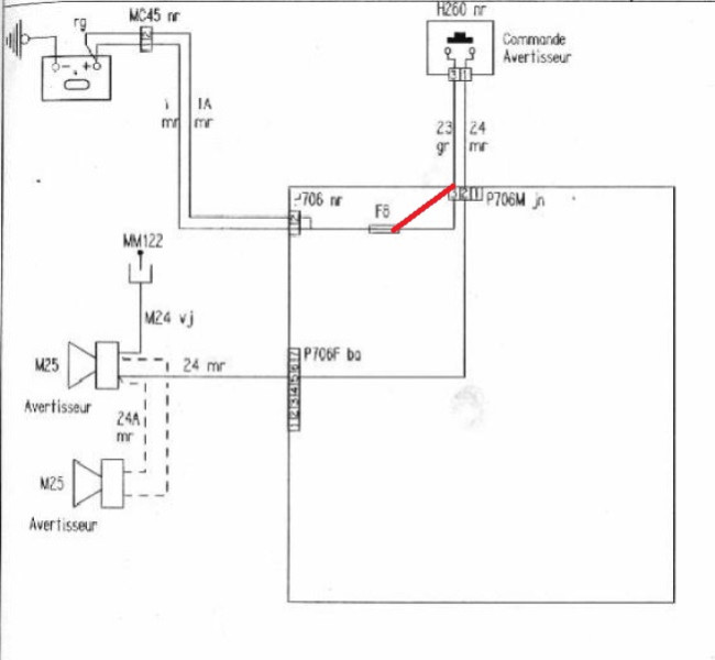

PhilNW 67 Posted January 24, 2020 Found this https://issuu.com/lamicale309/docs/schemas_electriques_309 Anyone know which schematic is relevant to the horns? Share this post Link to post Share on other sites
SRDT 255 Posted January 24, 2020 This one should be right for a 1.6 GTI: If you also have trouble with the rear defroster and cigarette lighter then the culprit is probably the fuse box. Share this post Link to post Share on other sites
PhilNW 67 Posted January 24, 2020 Thanks for the schematic, did not find that in the document i found Share this post Link to post Share on other sites
PhilNW 67 Posted January 30, 2020 (edited) Solved - the diagram worked a treat - Thanks SRDT Checked resistances all the way through the system no obvious high resistance wires - temporarily bypassed the wire from the fuse box to the horns and they worked. Traced it to a dodgy connector on one of the horns Edited January 30, 2020 by PhilNW Share this post Link to post Share on other sites
