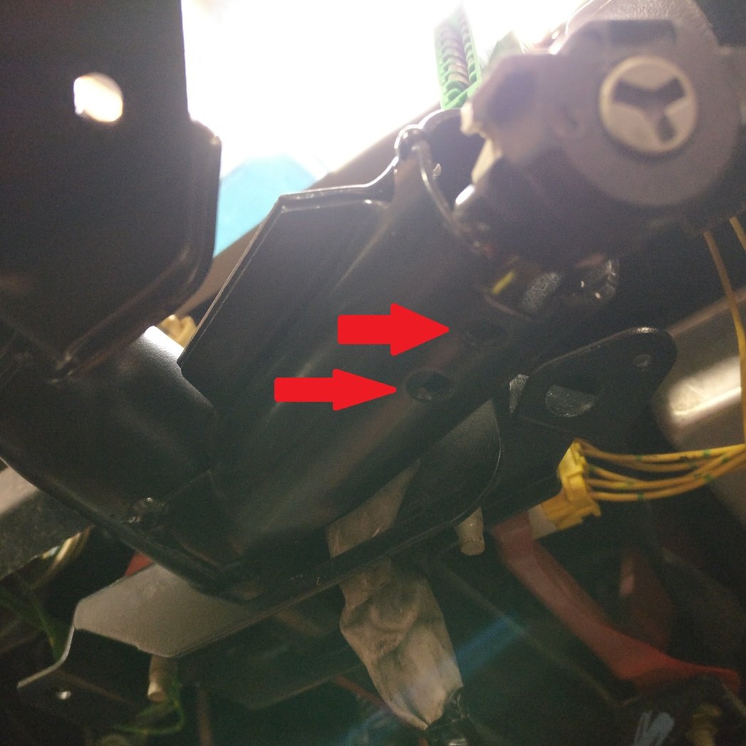

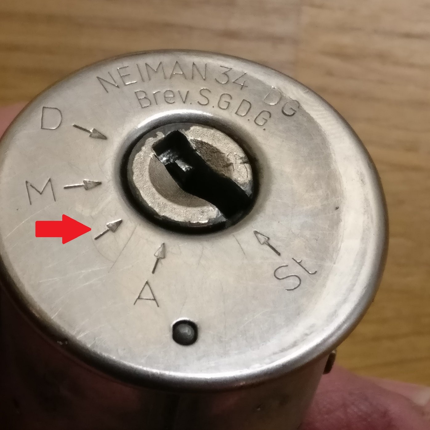

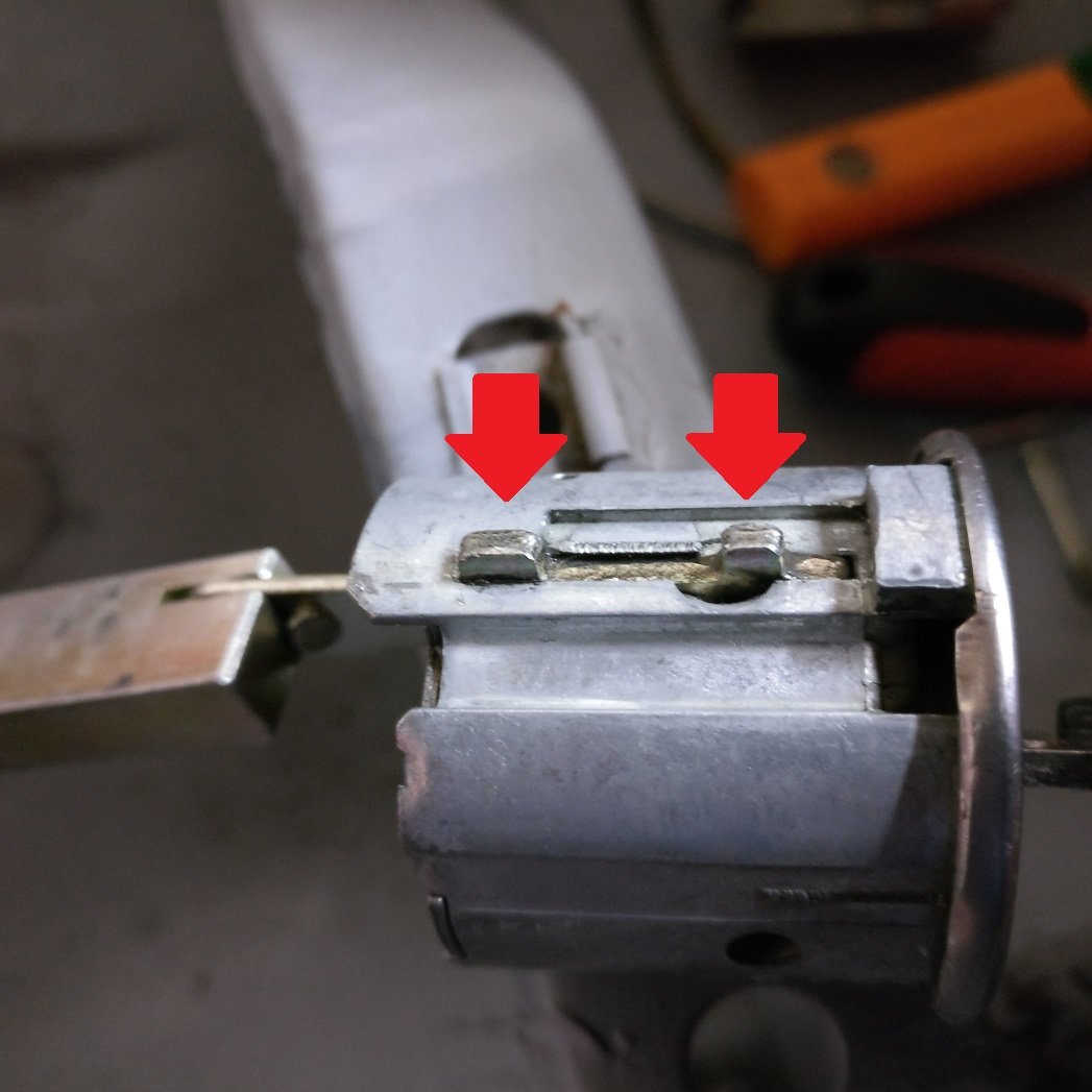

As an aside I took the ignition lock out to give it a clean and grease as it was becoming quite clunky.
Probably common knowledge to longer term owners than me but just in case you're also a novice it's easy to do if you know the knack to it...
You'll need the key in the lock, turned to the position I've highlighted between 'A' and 'M'.
That allows the 2 x oblong pegs to move upwards and disengage from the corresponding holes in the black metal tube, the whole lot can be slide out then.
