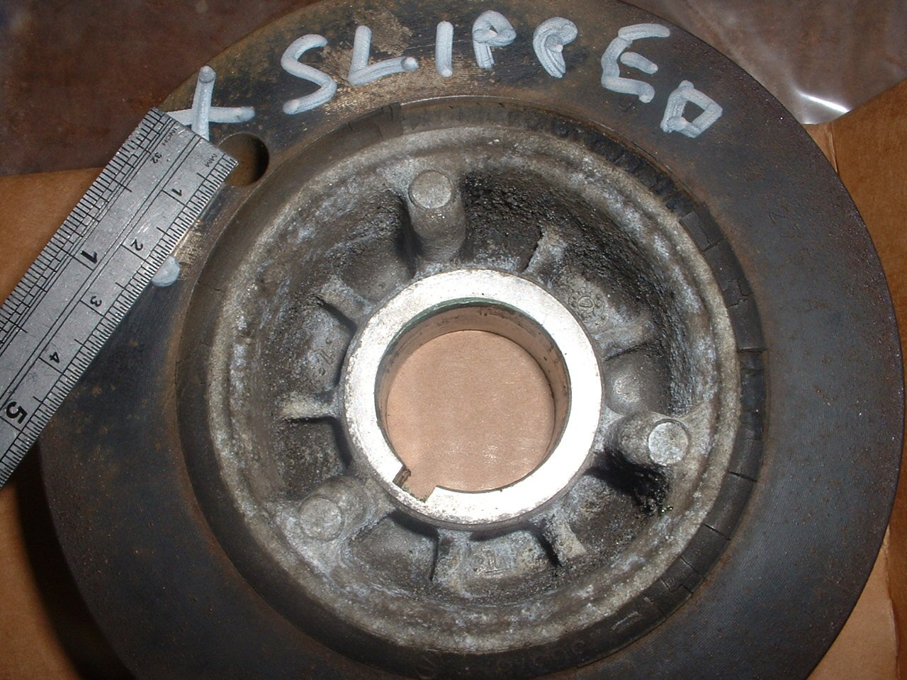

When I changed the timing belt I had trouble with the timing alignment (pulley isn't solid like some Peugeots) so it's possible the timing marks on the pulley are wrong.

Pin the cam then take the lower pulley off and check the keyway is parallel to the block, pointing backwards iirc, pin hole is 70 degrees up from there.
no pin holes in the flywheel on an XU, only the XUD TU TUD, some but not all EW engines

When I changed the timing belt I had trouble with the timing alignment (pulley isn't solid like some Peugeot's) so it's possible the timing marks on the pulley are wrong.
If anyone can loan me a XU solid cast pulley that I can use, just to fit temporarily to confirm my timing is correct that would be great.
Once I've confirmed the timing is correct I can then see what's else could be causing the power loss.....
Please help me find my missing BHP if I can get near the standard 150 I think I'll be happy :)
I wasn't able to borrow a solid pulley from anywhere else so eventually took the plunge andgot one from Spoox   ..... slip measured about 25 degrees which would explain my lack of boost, fitted a cheap boost gauge,  MoT and road test awaits (no rush at the moment with Coronaviruses restrictions).

yes as Tom suggested I've put a temporary gauge on it and static revving the engine it starts to count now 1 or 2 but obviously will need a load on the engine before it reads full boost - I can feel the intake pipe start to suck as well so looks as though it's fixed :rolleyes: got to sort a side airbag warning light out and then get it MoT'd and back on the road ....soon be April and hopefully Coronaviruses restrictions get relaxed ....
