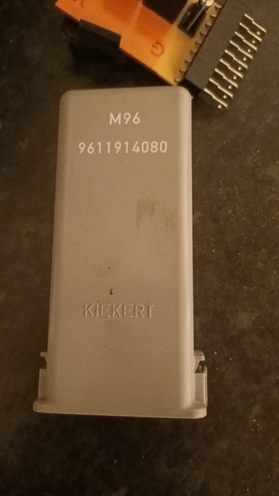

No it wasn't the IR receiver being at fault, it was the central locking controller/'ECU'. This for me was a Kiekert one (part number 9611914080) which were also used on the 306 and some Citroen models so there are actually still replacements available (second hand) on eBay etc. It's a grey cuboid plastic case with a black socket and a brown plug with 9 terminals (1 of which is not populated).

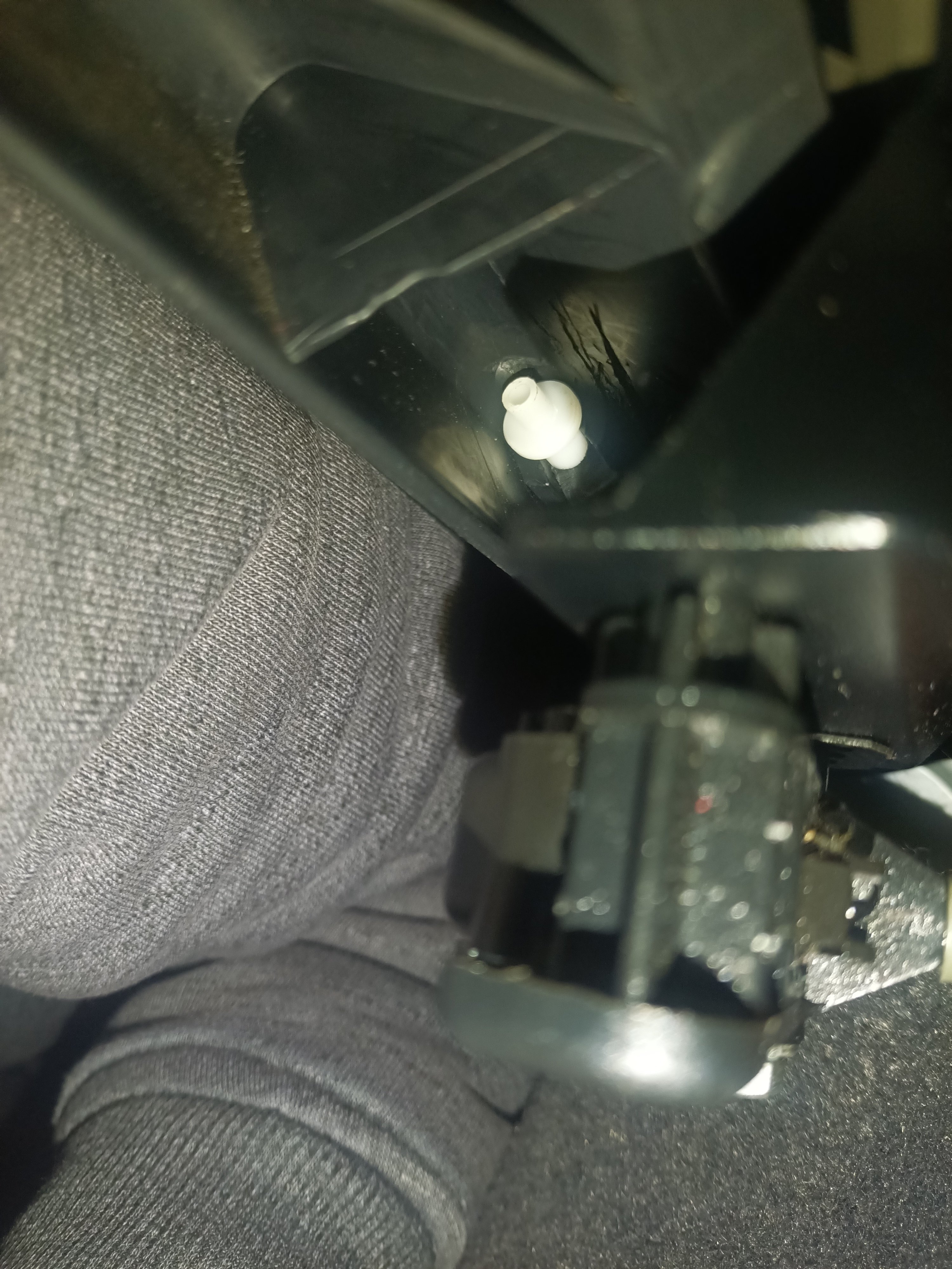

To remove on a 1997 RHD peugeot 106 (since there isn't really a proper guide online):
  1. Remove the glovebox lid. There are two white plastic pins retaining this which are a bit of a nightmare to get to. I resorted to being upside down in the footwell with legs out the door, although removing the passenger seat is probably a good idea. I used a fairly short, fairly thin flathead screwdriver to pry these out. You have to feel right up and around the lip of the bottom of the glovebox lid. The one nearest the passenger door requires you to pull the bonnet release lever to get the screwdriver into the correct place to pry. Significant force was needed (though I am arguably kind of weak).
  2. You should see, just behind the fuse panel, a brown plug with 9 connectors and 8 wires. This is where the central locking unit is (and not right up against the firewall as other people mention). If you move aside the two loose-hanging relays (orange and blue in my case) this should reveal two torx screws (T10? T15?) which hold the grey plastic case in place. Remove these being careful not to drop the metal screws onto the live fuse panel (or just disconnect the battery and don't be lazy like me).
  3. manoeuvre the unit round into view and disconnect the brown plug. This was very tight for me and required plenty of wiggling side to side.
  4. Take the controller inside to a desk and pop off the black plastic sheath from the end. This has two locking tabs, one on each side. Press these in, and the black sheath should pop out fairly easily.
  5. Remove the PCB from inside, this is just a friction fit but again is quite tight. I used a pair of needlenose pliers on one of the metal contacts and just pulled straight outwards with some force and mild wiggling.

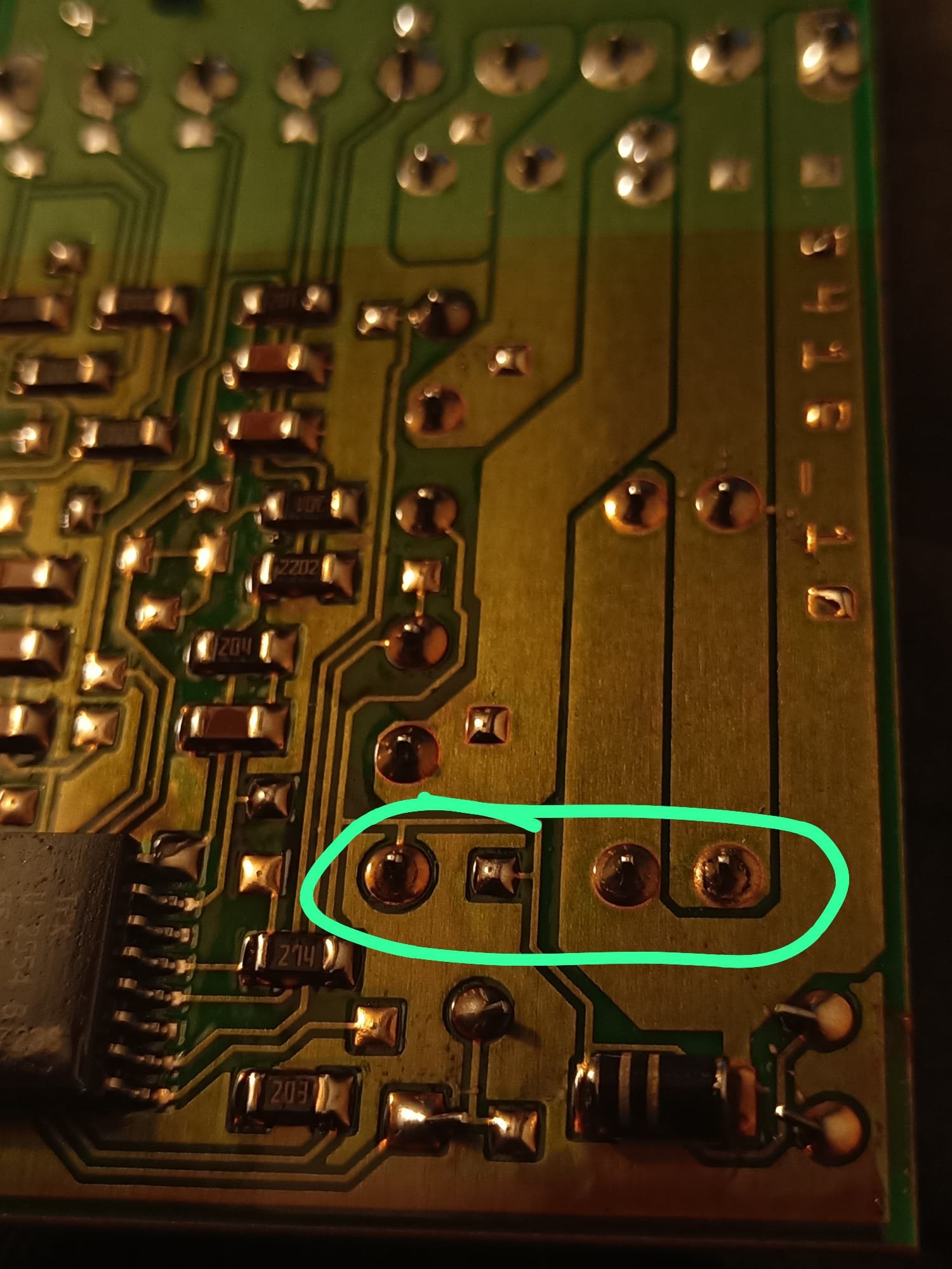

  6. The problem for me was 3 cracked solder joints (see photos) which were for one of the relays. I believe this is caused by age and possibly some slight mechanical resonance weakening the joints over time (all of those in that row were cracked but no others, and they were the furthest joints from the plug which would provide a degree of hard mounting). I used a medium-large sized soldering iron tip set to 380°C, leaded solder and extra rosin flux. Melt some solder onto the iron tip and heat the joint working your way around the pad for a few seconds at a time to melt through the lacquer coating. Clean the tip, apply plenty of flux, and repeat the previous step but whilst applying more fresh solder. You might hav to do this a few times to get the solder to adhere properly to the pad. Just like with paint, many thin coats (short attempts) are better than one thick coat (long attempt) as gross overheating will delaminate the copper pad from the PCB substrate, especially with cheaper bonded paper PCBs such as this one. Additionally, you could solder wires from the relay pin to exposed points on the PCB. The traces are easy enough to follow.
Reinstall the unit and test. I only tested with the IR remote in the fob, and now have both front doors locking and unlocking reliably. Still only using 1x CR2032 battery in the fob.

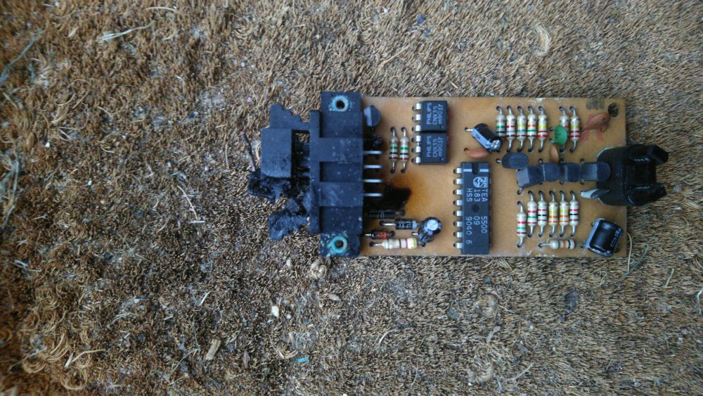

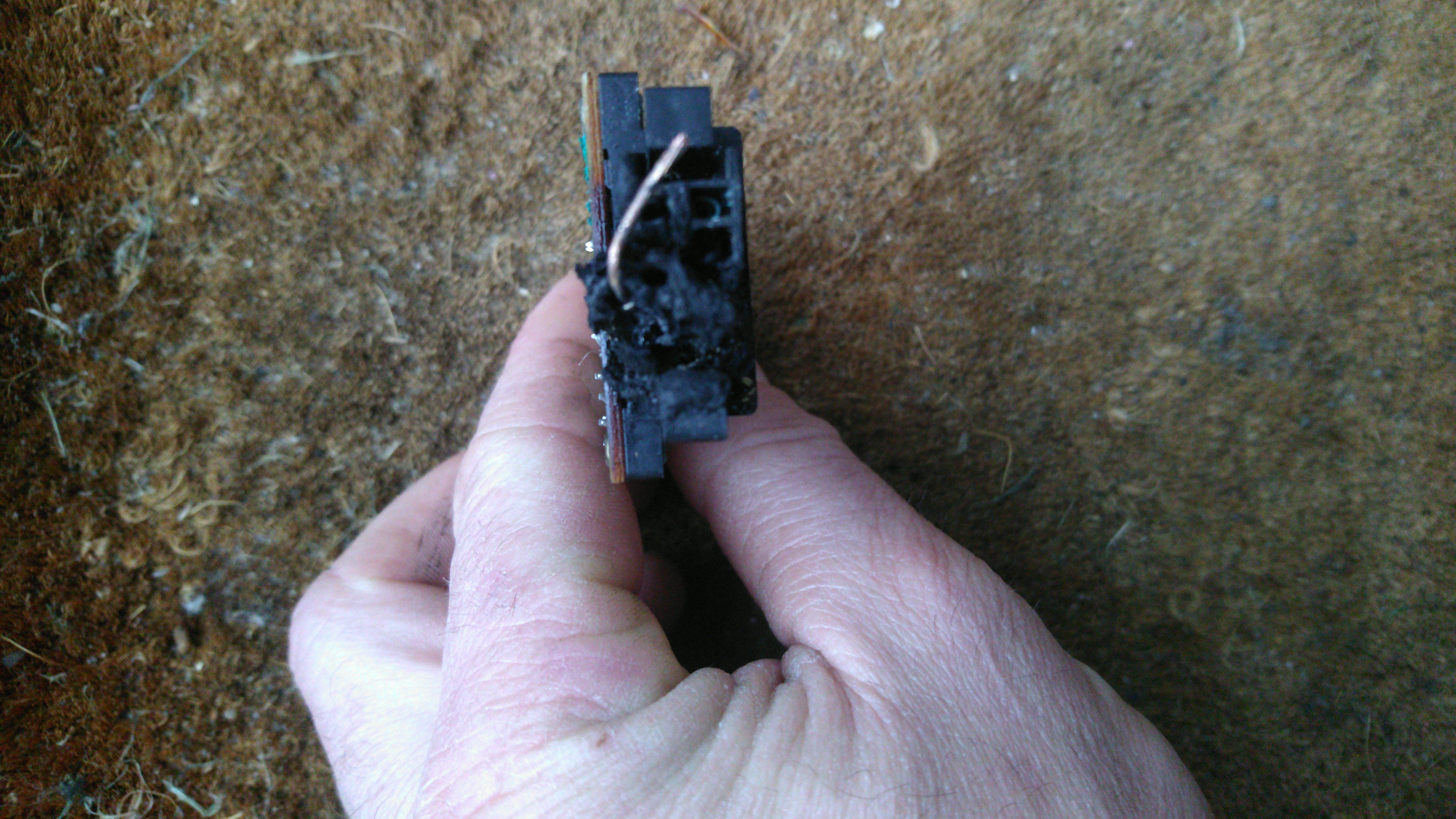

Ah disclaimer, this is not the IR receiver board shown in the picture, this is the central locking controller which basically just receives the lock/unlock signal from the switch on the drivers door lock mechanism and the IR receiver on the roof and translates it into a pulse which drives the lock motors one way or the other.

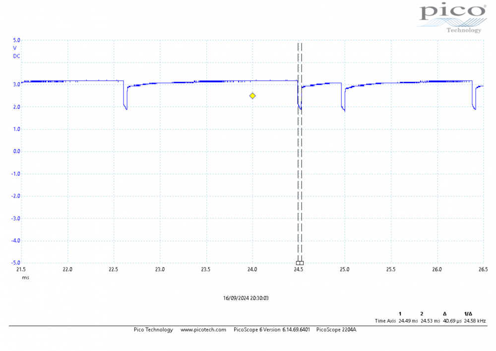

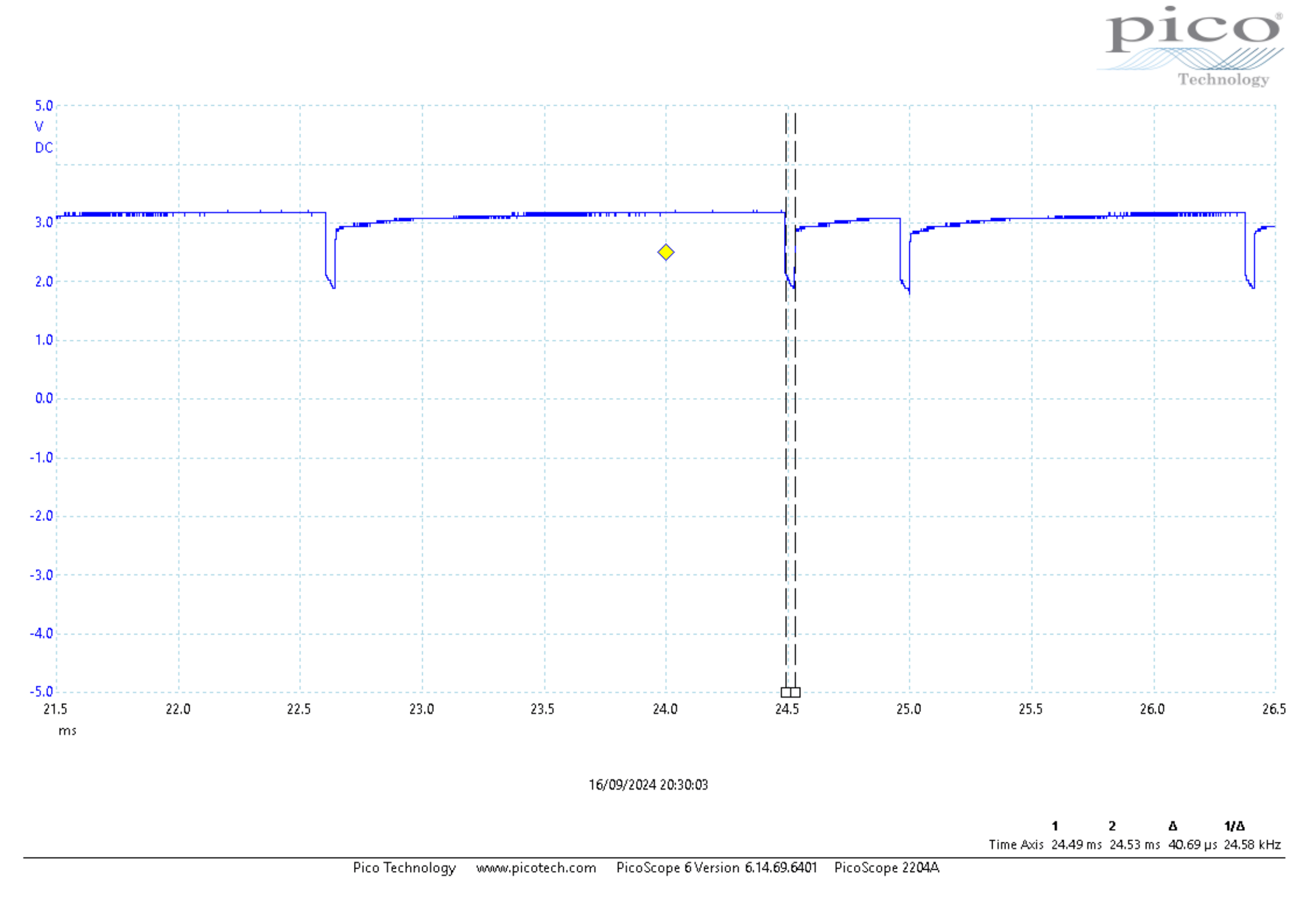

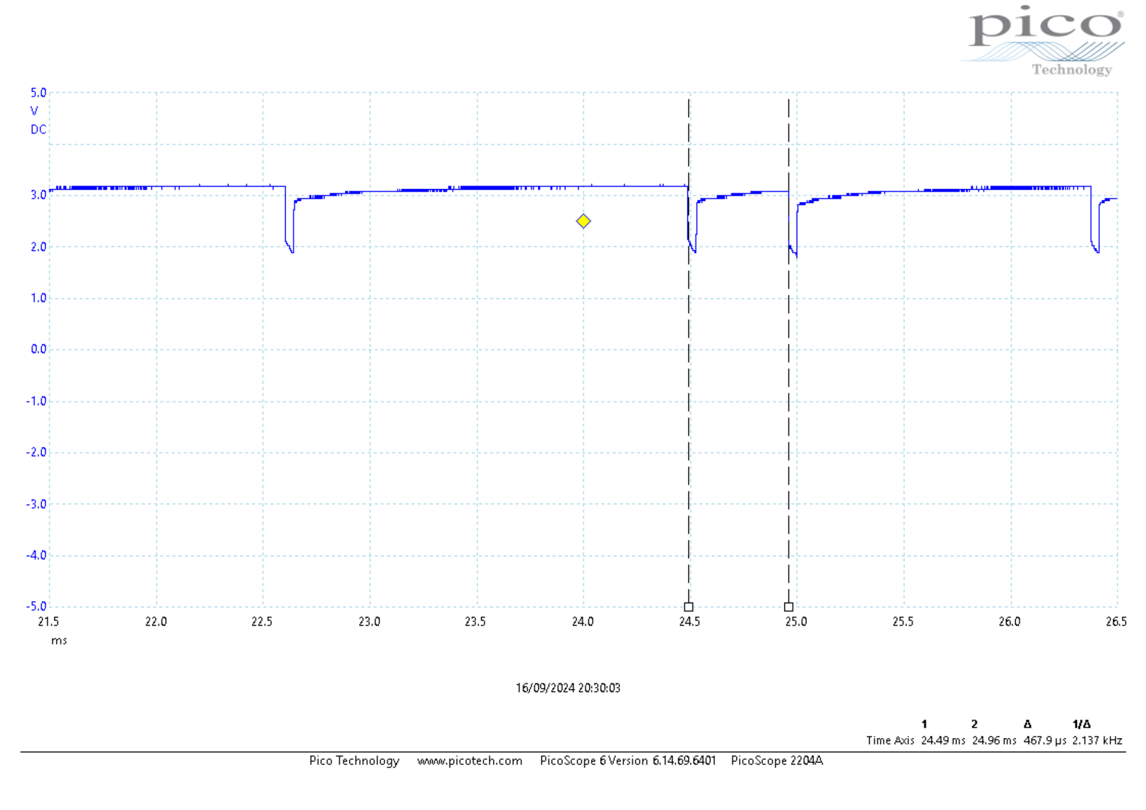

As in the link at the top of this thread, the code is 24 bits (or binary digits, either a 1 or a 0) long. The protocol is pretty simple, see the TEA5500 datasheet in the top link for more info on that. Basically there's a periodic 'clock' pulse which is sent out once every 1.888ms in my case (I'll be specific because I'm not sure of the timing tolerances at play here). If a second pulse follows shortly afterwards (0.468ms in my case), that binary digit is a 1, otherwise, if there is no second pulse, that binary digit is a 0. Obviously this happens 24 times to make up the code. The code is transmitted 3 times. The width of each pulse was measured to be 0.041ms (or 41 microseconds). Below are some oscilloscope shots (I use a PicoScope 2204A) of a '0' followed by a '1', which should help the above make sense.
All you need to do is pulse an infrared LED (not sure whether it's 850nm or 940nm emission wavelength, both seem to be common, maybe it doesn't even matter?) according to those specs, with your car's code and it should lock/unlock.
Possible reasons why it wouldn't lock/unlock, in no particular order:
  1. Wrong wavelength infrared LED (again, maybe it matter, maybe it doesn't I don't yet know). This should obviously never be an issue with a genuine key.
  2. Wrong timing - pulses too close together or too far apart. This could be on the key side, or on the receiver side inside the car if either have drifted wildly out of tolerance.
  3. Wrong code for your car.
  4. Faulty receiver - think water damage/corrosion, cracked solder joint, failed component etc.
  5. Faulty key (again this would be a component failure or similar).
  6. Faulty central locking system - failed actuators, central locking controller, vehicle wiring, etc.
I guess 3, 4, 5, and 6 are pretty obvious, but perhaps the first two are less so?

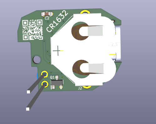

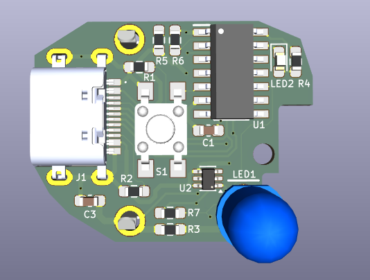

I realise this has so far moved at a glacial pace, so apologies for that, but I have over the last few months done some proof-of-concept work for some microcontroller firmware as well as an initial PCB design. In the last week or so, I've finally committed to ordering some parts for an initial prototype. It'll be a couple of weeks before I receive all the components, and the circuit boards, plus I'll still have some more firmware writing to do before I have an initial prototype up and running.
A quick overview of what features I intend to have in the final design though:
  • Drop-in replacement PCB: I took some hi-res birdseye photos of the original circuit board, cross-referenced with some additional online images, and some measurements with digital calipers, so hopefully this should just drop into the existing case.
  • USB-C interface: Not for charging (it's a non-rechargeable coin cell after all), but for programming your car's own existing key code into the replacement board.
    • You can update the key code whenever you want, so you can very easily 'code' they key to another vehicle, or to a new receiver (I might make one of those too, though it'd be more complex in terms of getting a 360-degree line-of-sight).
  • Encrypted storage of the key code in the fob.
  • Encrypted firmware updates: Any firmware released into the public domain will be as close to guaranteed-genuine as I can reasonably manage.
    • I don't expect firmware updates to be needed very often, if ever, but nice to know that functionality can be added/bugs fixed later if needed.
  • Various integrity checks: Making sure that the key code isn't corrupted.
I'll leave a couple of 3D renders of what I've come up with here as well, and will update as and when stuff progresses further. I'll also hopefully make a neat little PC program to make the key code upload process nice and smooth as well, though this may take some time too.
PCB-3D-Render-Top.png.0e73775cd7cd4484a95875f7c6a1c92e.pngPCB-3D-Render-Bottom.png.1f8919ef91a363df9ee3e7f980dd1f5d.png
(Ignore how the infrared LED is not pointing sideways - I couldn't find a suitable 3D model and didn't feel it was worth making my own just for this)
