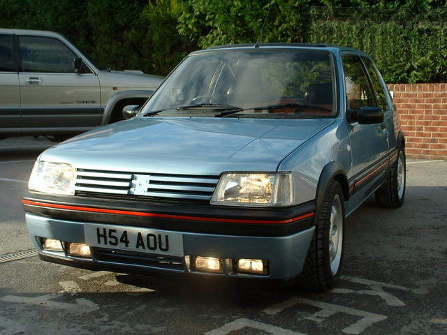

jackherer 543 Posted September 9, 2019 They have the same basic floorpan and the doors are the same (but without the bodyclip rivets) as well as a few other bits. There are many differences though, even the bits that are similar have small variations such as the wishbones and rear beam which are both wider. The interiors are totally different but because the floorpans are the same you can swap the seats over. Engines are almost identical between the 1.9 GTI 205 and 309 GTI, only external parts like the pipework and oil coolers sometimes vary. Also the 205 1.6 GTI and 309 SRi. To be clear the bumpers and wings are totally different. This is what a 309 bumper looks like on a 205: (after a lot of cutting and modification...) 1 Share this post Link to post Share on other sites
