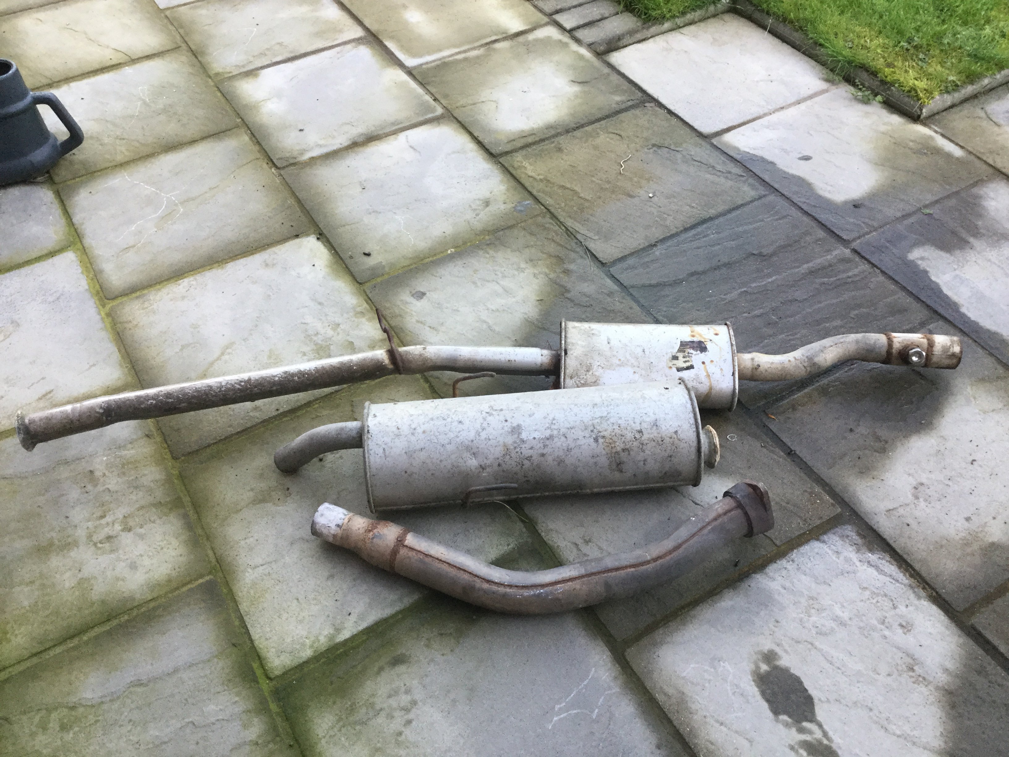

I hesitate to add this, but I do have hanging around in my loft an o.e downpipe and an aftermarket 2 section exhaust system that has been used, but not much ( so all together it is a three piece system. ) I also have a stainless downpipe too but that does not have the divider .

Morning. Picture as promised. I fitted a lambda probe to this system , hence the blanking bung .

Righto. All packaged up. I will get a price for the postage , let you know and then, if o.k with you, please pm me your full name , address and contact phone number for the courier . It is in a box 30x80x150cm and around 20kg, so may cost a bit .
Andy
Andy
Update. Cheapest I can see is Hermes 3 day for £25.19 . It can go tomorrow as long as I book by 8.00pm tonight , but the cost is still a bit stiff, at 19 pence more than the cost of the exhaust. Oh, added some clamps and bolts in an ice cream tub inside the box . Might be useful
